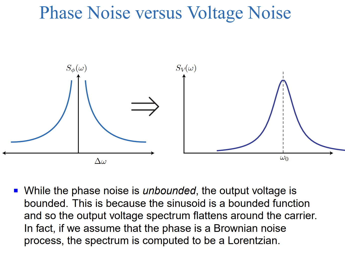

This is what PN and AN look like in a spectrum analyzer view of a test tone played back though a dac:
You can easily see those effects in measurements presented in a diyaudio thread: https://www.diyaudio.com/community/threads/phase-noise-in-ds-dacs.387862/post-7063038
The time domain view is different. There can be errors in dac output sample point amplitudes, and or errors in dac sample point output timings. Either one leads to an error in the reproduced waveform.
To claim they are not specifically evidenced in the analog output of a black box dac would be incorrect. Thus they should be included a more or less comprehensive black box model.

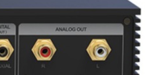

If you look into a pair of these:
Tell me how you measure jitter / PN and Vref noise by sticking someting in there with something in the end. And I mean an actual indicator saying "Phase noise" with the scale db/Hz and an other saying "Vref noise" with a scale dBv.
No, exactly, it wont happen.
