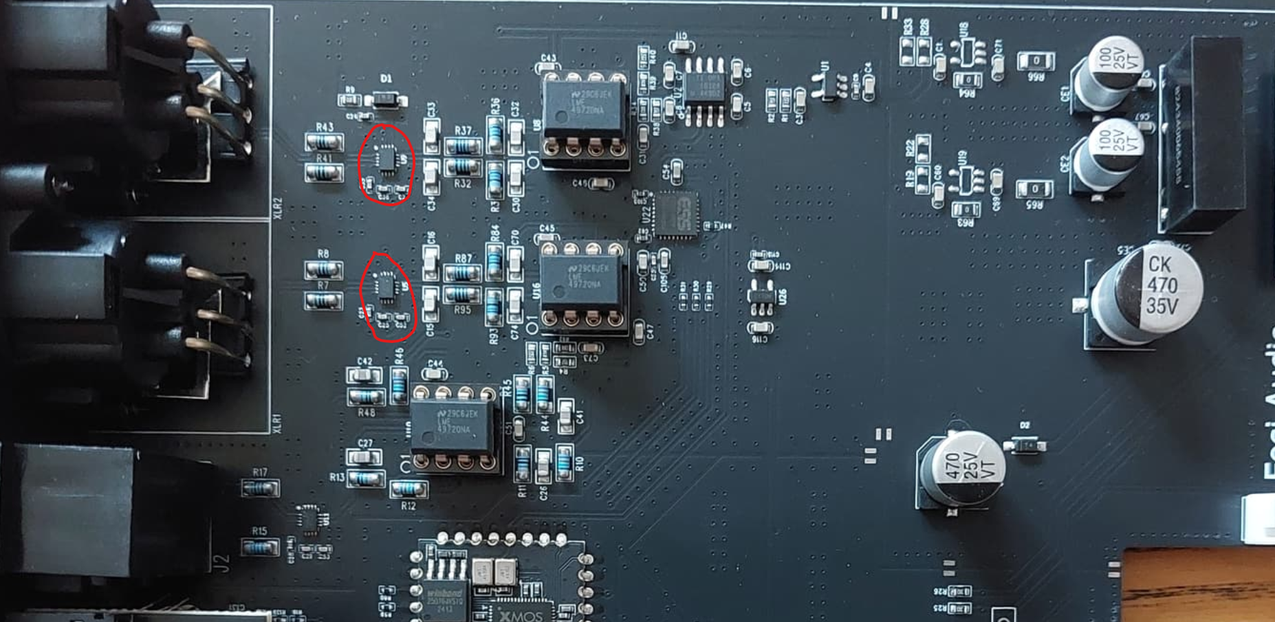

What is the active device use in the red circle on the ZD3, please ?
Seems true crystals near the XMOS output chip ?
I don't like their via fencing use between the high speed digital lines... so-so layout.Also what the heck with that MELF resistors ! Looks like pictured for audio magasines.... Nothing to complain for the price though and certainly easily diyable with the external smps dart.
