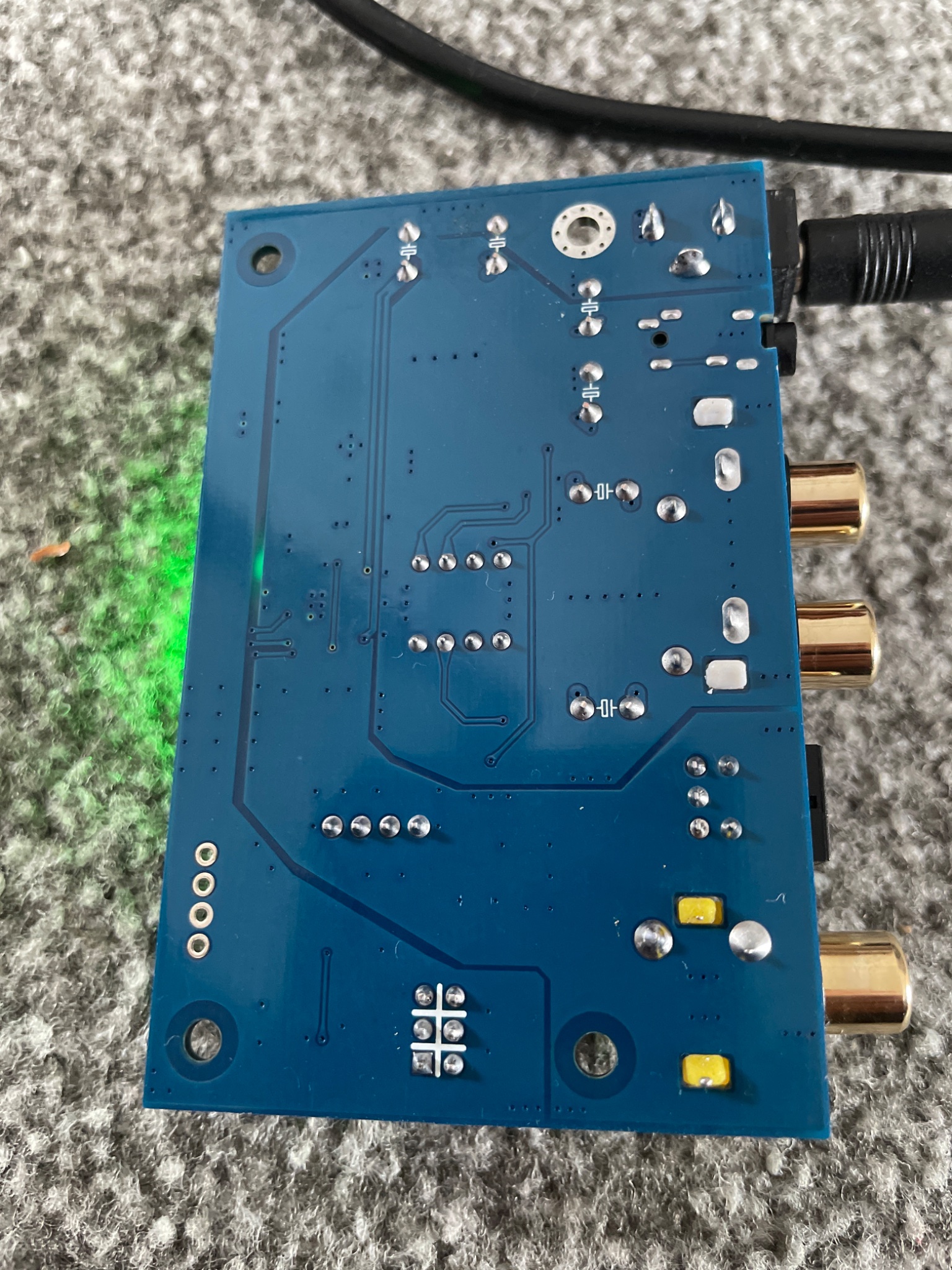

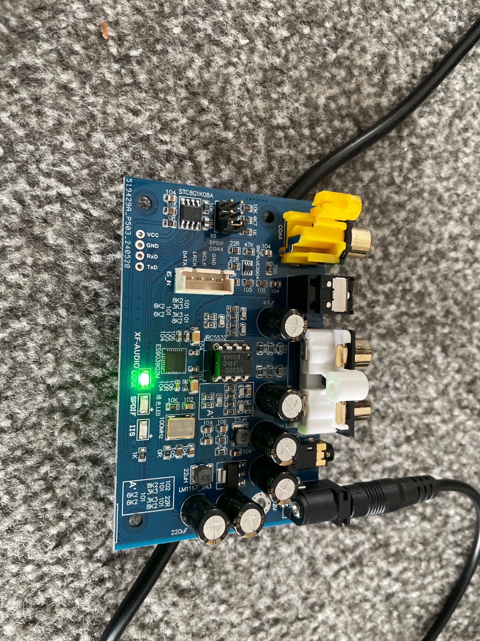

Noticed that too but CheapESS works OK. It is playing right now. First thing that I hear is quite deep bass.Apparently they had some leftover 100MHz crystals from ES9038Q2M boards. Unfortunately ES9039Q2M MCK maxes out at 50MHz. But datasheets are for wussies.
Nothing changed yet, not even the NE5532. With cheap SMPS like it should be when testing ultra low budget stuff.
op5532 with Slew Rate at 9 V/uS .... Is not that too weak for a 24 to 32 bits oversampled output ???
Would change it direct for op1656 or the dif op1638 just for curiosity, change indeed C15/C26/ C19/C31 for ceramic class I, at minima.
