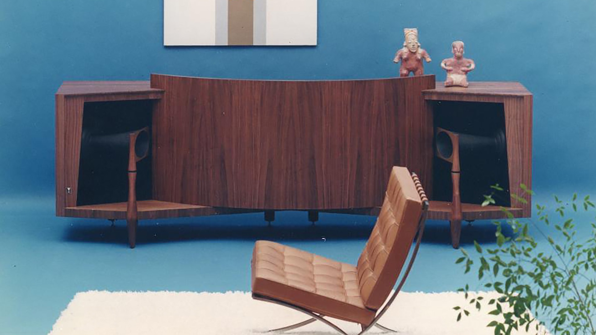

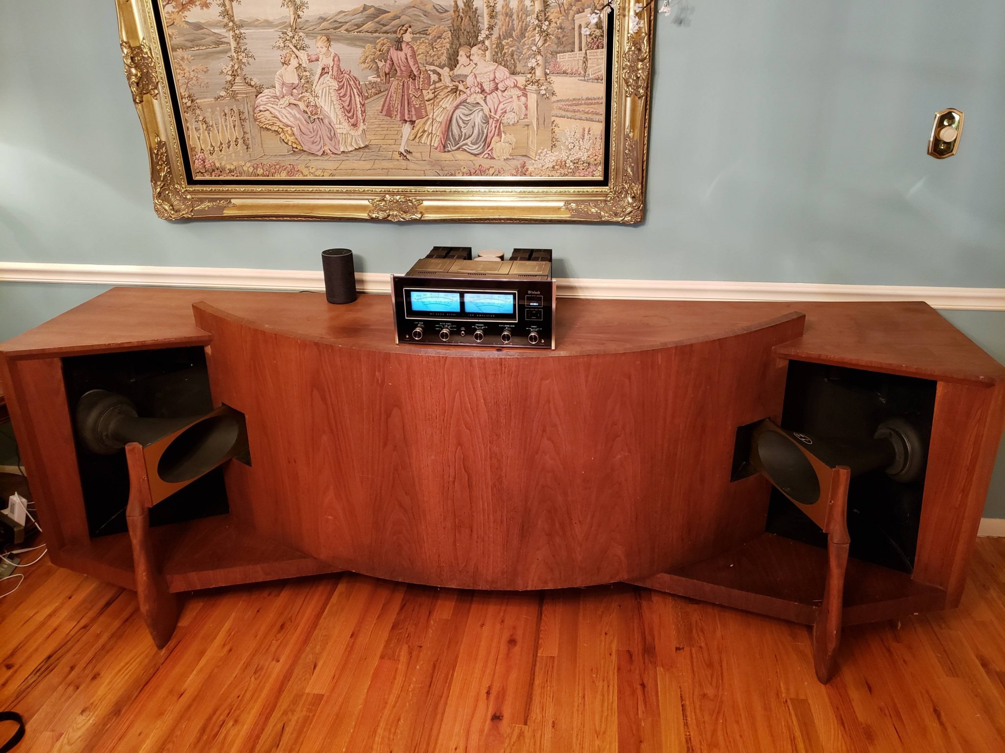

I once had a discussion with Aspen Pitman ( at the time he shut off Groove Tube and got rid of a number of his personal tube collection, iirc he was consultant for Fender) where he talked about an ( instrument) amplifier ( combo) where he achieved stereo fx from a 'regular' looking instrument box. He didn't wanted to tell much about how he achieved this and I did not heard this amp (and never seen one so it might not have been produced at all), but he might have investigated same thing discussed here.
