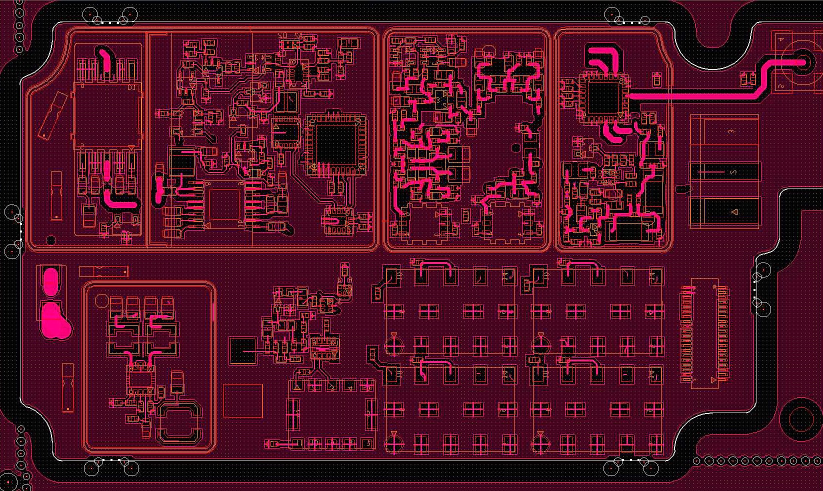

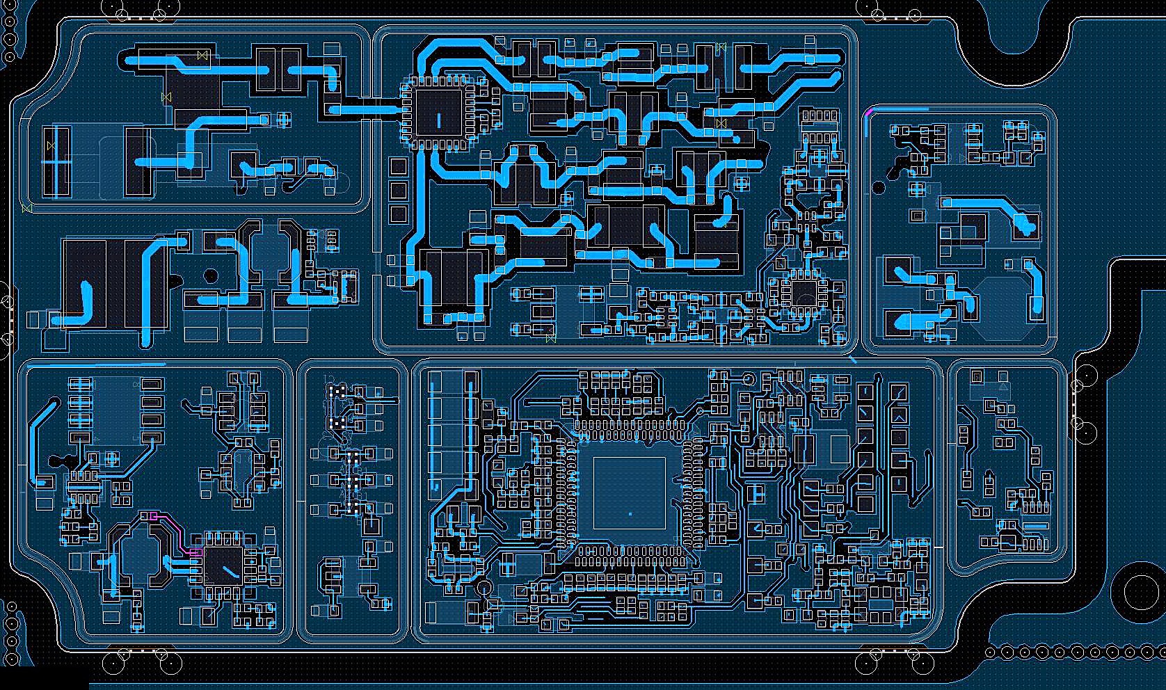

I have done PC board layout for everything from a simple tube or solid state audio amps to cell phones, police walkie talkie,s and high powered mobile radio transceivers. The trunk mounted 700 MHz LTE based transceiver seen in the first picture put out 100 watts of peak RF power from a 12 volt car battery peak currents were in the 20 amp range. Yes, this one used 2 Oz copper, and lots of it in the 28 volt boost converter and RF power amp. I used Mentor Graphics PC board tools for that design. Here each routed signal was assigned to a routing class, each with its own design rules. Trace width, spacing, and layer restrictions are put in place for each routing class before the PC board layout is started and the rules are enforced by the layout software.I'd like to see George Anderson, aka Tubelab chime in. I pretty much copy what he seems to be doing with PCB sockets directly on the boards.
A similar situation exists, but at the other end of the layout spectrum occurs when trying to stuff 600 components into a small PC board for a police walkie talkie. The blue and red pictures show the outer two of the 10 layers used in this prototype board. Two layers are solid ground except for the keepouts for the through holes.

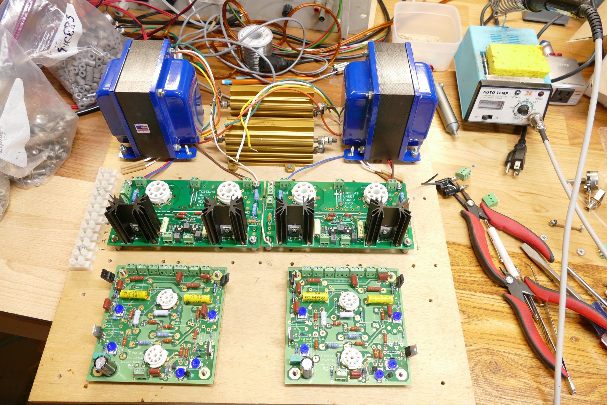

PC boards for tube amps are far simpler than either of these. There are three major concerns, and a fourth that I have self imposed.
Tube amps involve high voltage. The plate voltage on the output tube in an audio amp will reach 2 X the B+ voltage in normal unclipped listening and go much higher when the amp is driven to clipping into a reactive load like a speaker near resonance. I have seen 2500 volt peaks in a cranked guitar amp that ran from a 430 volt B+ voltage into a guitar speaker at resonance. Trace SPACING must accommodate this voltage without flashover.
The tube heaters require high current. Here the trace WIDTH is important, especially if 1 Oz copper is used. I tend to stay well within the 4 to 5 amps per 100 mills guidelines provided by the PC board vendors. The fattest sweep tube that I know of consumes 2.65 amps of heater current. An amp with two of them will pass over 5 amps continuously and far more on start up. The UNSET board can use a pair of these tubes, so the short heater traces are 125 mills wide (0.125 inches). The SSE board has been built with 6DQ6 sweep tubes drawing 1.2 amps each, so 100 mil traces were used. The TSE-II uses very wide traces that are doubled up (on top and bottom layers) for low voltage drop.
Use the calculator found here to find the limit of a given trace, and stay well inside it:
https://www.4pcb.com/trace-width-calculator.html
It has been mentioned throughout this thread and most other "PC boards are evil in tube amps" threads that tube sockets should not be mounted directly to the PB board. Plenty of tube TV sets made on crummy phenolic board with cheap sockets set forth a good reason for this belief. Some of the PCB based TV's in the early 60's literally came apart, warped beyond use, and even caught fire due to poor materials and inexperienced designers. Often these boards had poor adhesion between the board material and the copper traces which got worse over time due to heat cycle induced stress. It was not uncommon to rip a socket with some traces attached from the board while attempting to extract a firmly entrenched tube from its socket. This is not necessarily the case today, IF some thought is put into the design and good quality materials are used. There are still plenty of the cheap plastic or phenolic based tube sockets available on the surplus market today. Why would someone make a cheap plastic socket for a TV sweep tube that's going to get HOT. I got some cheap from AES and melted one so they were all trashed. I use only ceramic sockets. Even the cheap Chinese ones are OK as long as you change them after a few hundred tube swaps as the pins get loose.
In order to reduce the chance of issues with PCB mounted sockets I made the pads for the tube socket pins much larger than what's seen in most other PC board designs. All of my tube amp boards use double sided plated through holes for maximum pad to board contact area. This makes it nearly impossible to rip out a pad in a well made board.
I mentioned a self imposed rule that I follow for all Tubelab boards and most anything else where tight spacing is not needed. My boards get sent all over the world. Some are built by seasoned experts, but most are often a "first time build." Many of my own boards, and those belonging to some other users on this forum get used for "experiments" some of which may end badly. To make the board more robust I use no traces thinner than 50 mills and also use a 50 mill minimum spacing. Component spacing is generous for an easy build and an easy repair if needed. This makes the board much more resistant to less than optimum soldering skills. Recently I needed to test some mosfets for use as replacements for the hard to find IXYX IXCP10M45S chip used in the SSE and TSE-II board. I dug through my "box of dead circuits" and found an old well used SSE board which I got working and used for all of this testing. During that session I realized that the board on my bench was the very first SSE board I ever made. It has seen hundreds of tubes rolled through it, dozens of parts changes including at least two sets of output tube sockets, yet other than a coating of permanent dirt and grime, it still looks as it did when it was made over 16 years ago.
Those experiments are here starting in post #26:
https://www.diyaudio.com/community/threads/10m45s.390771/page-2
It is also a good idea to space the components 1/8 to 1/4 inch above the board when building. This allows for improved airflow and makes it far easier to remove the part if necessary.

One of my tasks at Motorola was spending time with rookie engineers that were fresh out of college. I also got elected to teach the entire graduating class of 1993 at Nova Southeastern's college of computer engineering how to solder when I was a student there, as I had been soldering everything from electronics to slot car chassis since my pre-teen years. I found that 1 Oz copper was the sweet spot for inexperienced solderers to learn on when using a typical 40 to 60 watt iron. The heavy stuff pulls too much heat out of the iron leading to cold or brittle joints.Now with PCB, I would also prefer more copper. Time spent to design the board, accounting for voltage/creepage/clearance issues is large compared to PCB cost...so bump it to 2 Oz, or more.
When laying out a board for Motorola we used a thermal relief, AKA wagon wheel anywhere a component lead or an SMD pad connected to a ground plane or other large area of copper on the board. These make for easier part removal and prevents "tombstoning" on IR reflowed SMD builds. I also found that these lead to ripped out through holes on tube amp boards when a rookie tries to remove a part, so I do not use them. Many people use too much heat and not enough time.

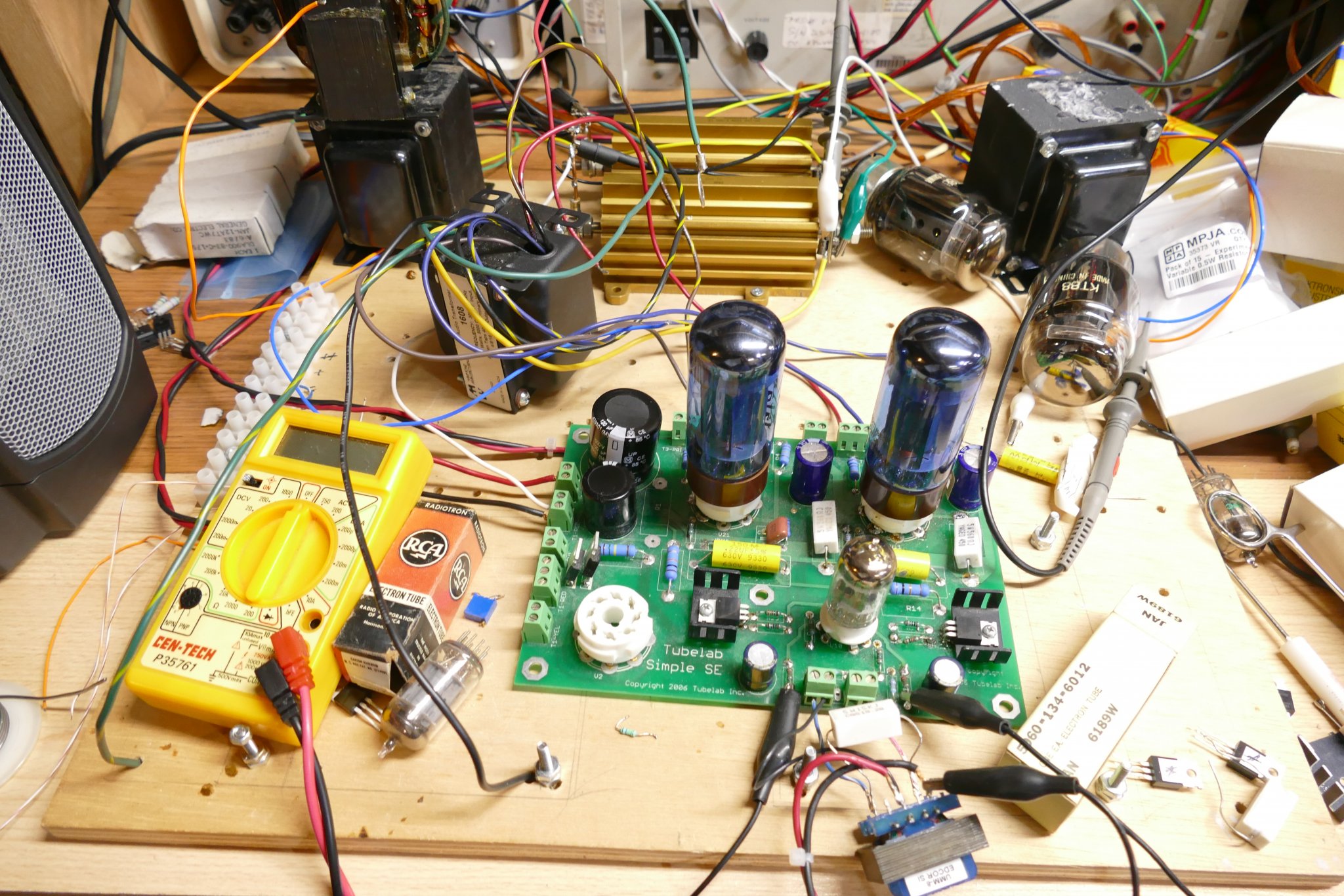

I have been soldering up a little test amp for the past few days. This should be capable of setting many speakers on fire! I have my iron set on 325C. Just how accurate this 25 year old Jameco iron is, I don't know.
