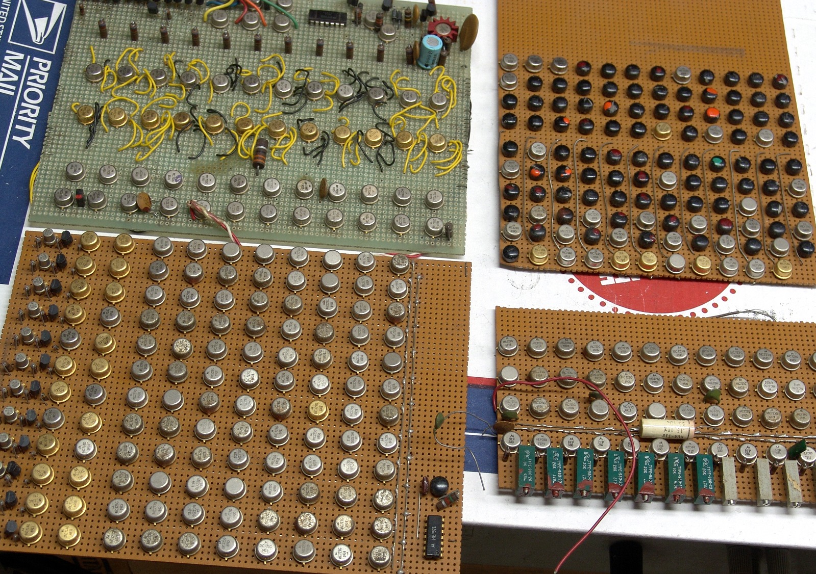

Back in 1971 and 1972 I made these primitive digital music synthesizer boards with RTL logic chips that were torched off of boards obtained from the trash dumpster at the Coulter Diagnostics (medical equipment) plant in Miami. Each round can contains a single gate or flip-flop. It takes a lot of these chips to do anything useful.
