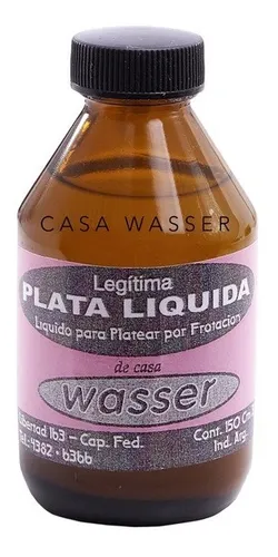

? We did that all the time in the bad old days of self-etched PCBs. That's why Steinmetz invented ScotchBrite.it would be hard to coat bare copper directly sticky-wise
Before ScotchBrite we polished just etched PCBs shiny copper bright and wiped them with "clock silver polish" fluid, which we bought at clock repair/jewellry shops.
Now I shiver thinking about the nasty poisonous chemicals it certainly had, but it deposited a nice even silver layer.
Unless it was mercury 😱
In theory, "liquid silver": 😱

I've seen that. It is real Silver. And maybe Cyanide? I recall it got hard to get? Or we switched to a Tin-base solution? On the US market in the 21st century I find something similar, Silver, called "non-toxic"."clock silver polish"
Makes a lot of sense if you etch a pile of boards on Wednesday and can't get around to soldering until a week from Friday. Mail-order kits were always "tinned" so they did not go green in storage.
Me, I hotted-up the iron while I was rinsing the PCB. A few minutes on the hot-air vent and I could solder-coat a large board in a few minutes.
I fear some cyanide too, simply because it is so "good" in plating solutions.
That it kills the operator is just a little collateral damage 😈
