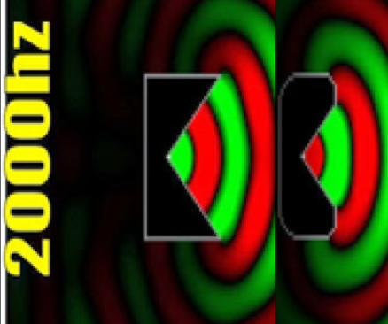

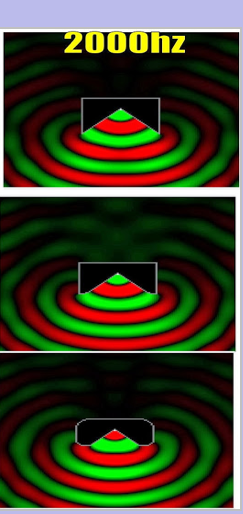

In order to explore this further, I have simulated three different cases:
1) a 90 degree waveguide with no mouth termination whatsoever
2) a 90 degree waveguide that transitions to 180 degrees at the mouth. This is similar to what QSC does in their well regarded 90 degree waveguide.
3) a 90 degree waveguide that transitions to 180 degrees at the mouth, then rounds over all the way to the edge, and *also* has a roundover at the *rear* of the enclosure.
Here's the sims:
Here's some observations about the sims:
The first thing I notice is that the roundover seems to send more energy off axis. For instance, if you look at the second and third case you'll notice that there's more energy radiating *behind* the speaker then in the first case.
For me, the most interesting thing about the sims is that the roundover seems to make the energy level more consistent from left to right. If you look at the first row and then compare it to the third row, you'll notice that a greater percentage of energy is focused into the 90 degree 'cone' in front of the speaker. Whether you think this is a good thing is obviously subjective; some will want the loudspeaker to only project into a narrow angle. But I personally prefer that a waveguide makes the response consistent from left to right. And the roundover seems to facilitate that. (If the simulations are accurate, of course.)
Here's some details on the waveguides:
1) Each waveguide is 36cm wide. This is the same width as the QSC waveguide mentioned elsewhere in the thread.
2) I've only varied the *shape* of the waveguide with the roundover. I did not vary the width. Since I fixed the width, the depth of the waveguides vary. (The unterminated waveguide is the deepest.)

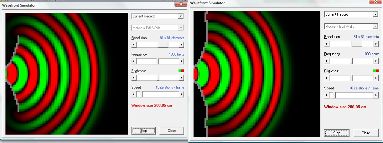

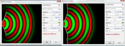

In Patricks sims we must notice that in every model there is no baffle! Any baffle modifies sound wave propagation very much!
It is possible to add walls (baffle) in Hornresp simulation. Here is a quickie where the wg is 40cm wide an Fq is 1000Hz - the effect is not strong but just try yourselves!
All nine Sims have four sides.
It may be hard to see because the wall thickness is just 0.74cm
There is a front, a back, and two sides.
The front and back are 36cm wide.
...But the wavefront simulator in Hornresp seemed to indicate that diffraction could screw up the directivity of waveguide.
Patrick,
You seemed to have missed a basic rule of directivity, the director has to be large compared to the wavelengths reproduced to have directivity.
Your larger sharp edged "cone" shows it contains just under three wavelengths at 2000 Hz, the smaller rounded cone/horn only two.
Regardless of termination, the smaller horn will show more diffraction surrounding the terminus- a smaller horn will have wider dispersion due to diffraction.
To draw conclusions regarding the effect of roundovers from your sim requires the cone to be the same size prior to the roundover.

Each pixel is 0.74cm
At 2khz, each pixel corresponds to 1/23rd of an octave
At 4khz it's 1/11th, etc
That's reasonably high res I'd say. To go higher I'd have to start working with a magnifying glass.
