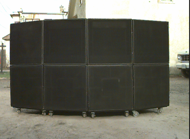

I invested a lot of time, research, and money in a nested horn speaker system back around 1992-1995. Called the Maltese Horn, (the HF horn sides looked like a Maltese cross) it originally was a 45 x45 x 67 inch long pyramid shaped enclosure, the outer shell the sidewalls for a 15" driver horn surrounding a 12" driver horn surrounding a 3" diaphragm compression driver horn.Anyway, back to horns (which admittedly aren't something
I know alot about)
Speed reading the 'nested horn' thread and I'm intrigued. How about that? Coaxial CD driver? Maybe ive lost the plot now ��
Thoughts on that?
The concept worked in that it made for a virtual single point source, but causes diffraction issues that can't be solved.
The nested horns put the HF driver in front of the mid driver in front of the LF driver, exactly the opposite from what is needed for phase alignment.
The picture below shows the Maltese mid/high cabinets with separate manifold bass enclosures on top- this was much more viable, and some (stolen) cabinets are still being used by a rock band that had achieved some notoriety in the 1980s.
The DSL Synergy horns and Renkus Heinz Co-Entrant horns using multiple drivers feeding a single horn eliminating the glaring problems in nested horns, and the DSL Synergy horns provide a constant directivity single point source down to fairly low frequencies.
