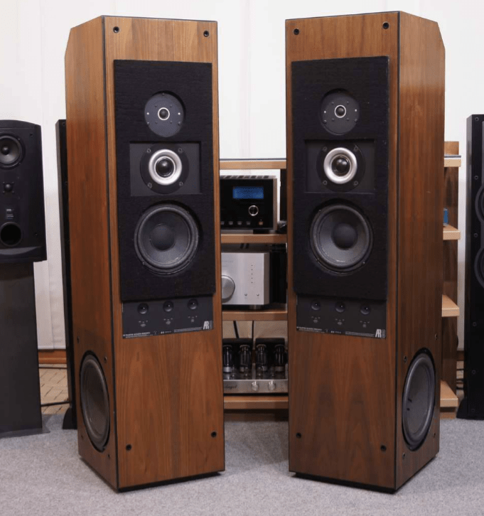

It would be nearly impossible to have an apples to apples debate here when really the debate is "do we need oranges when apples taste so good". The AR9 mid is more like a dome mid anyhow than it is a wide-range speaker.Having been 'immersed' in various 755 apps from earliest age this is an 'apples n' oranges' comparison at best if for no other reason than the AR9 used a dedicated 1.9 cm/~0.75" dia. super tweeter for 'fill' - 'top end 'air'. Disconnecting it, leaving a 3.8 cm/~1.5" mid/tweet is a close enough 'ballpark' comparison though that in retrospect wished I'd done such when I could have, but was/am too 755 centric (especially the original FC) by then to give 'two hoots n' holler' and really, really wished I'd had the foresight to buy/store the hundreds available (some FC) in my locale at one time for 'pennies on the dollar', but at the time didn't see a way to make enough profit from them to justify the potentially long term storage cost.

Hence a ~same-same comparison if you look at a 755's mechanically XO'd three way diaphragm.The AR9 mid is more like a dome mid anyhow than it is a wide-range speaker.
