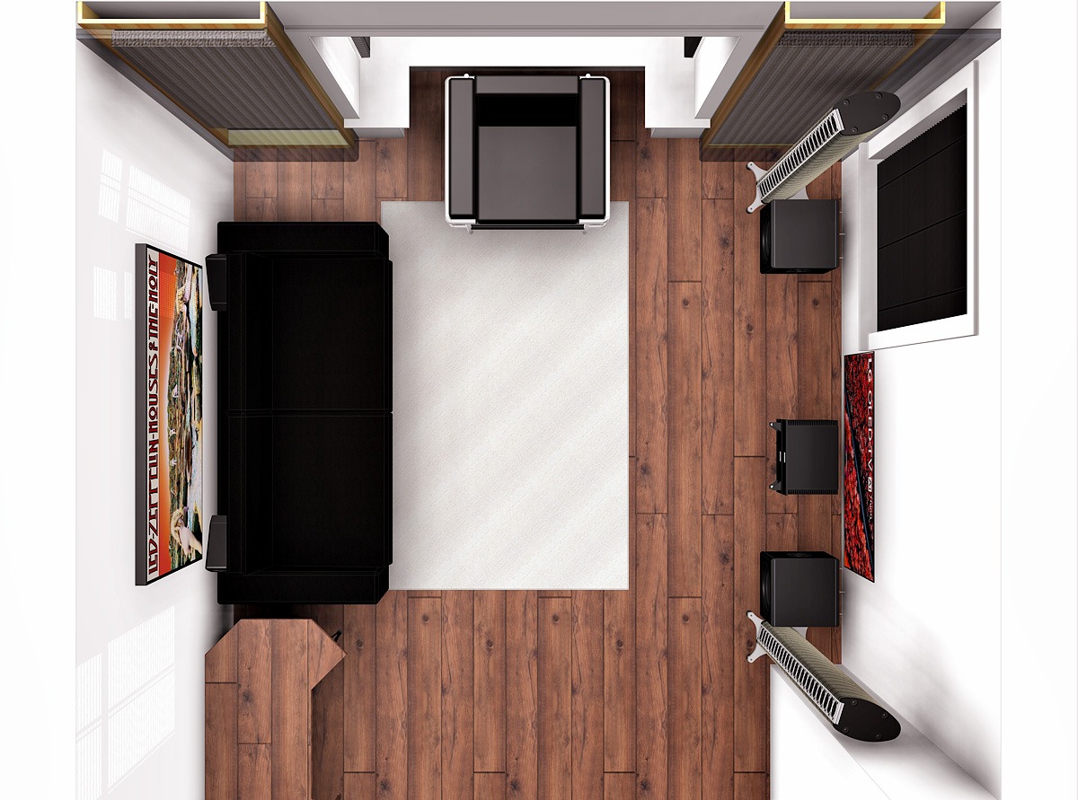

I won't get too technical about it, as that isn't what full range aficionado's do . Here's my deal, not intended to be Hi-Fi, it's more like My-Fi. Stereo replay I can enjoy.
I had a few goals in mind to be able to achieve in my living room. Not many speakers could do what I wanted to try; keeping the frequency response time-aligned as it hits your ears at the listening spot, not at one meter on a design axis in anechoic conditions. Diminish the influence of the room and use ambience fill in speakers to create a more optimized (and controllable) ambience effects of a larger space. Mostly influenced by the body of work from Dr. David Griesinger.
I started with unshaded arrays, as this project worked way better than I ever expected, I decided to try and take it up a notch and use frequency dependent shading to solve a few things at once. Highly influenced by simulation work from a fellow DIY member nc535.
Objectives for this tweak: further reduction of the room influence and solve any combing problem at listening distances.
Creating a large "sweet area" in the process. Optimized at seated height, still balanced sound at standing height.

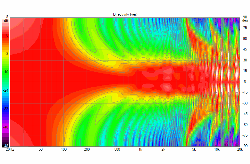

Vituixcad simulation to design filters for a frequency shaded array to further diminish the influence of room effects for an unshaded 25 driver array:
Frequency shaded array using 25 Scan Speak 10F's per side. The point being the controlled vertical directivity. The horizontal directivity is optimized by to using a specific rounded/oval shaped enclosure and a small waveguide in front of each driver.
(For a single driver the vertical output would look exactly like the horizontal Directivity plot.)

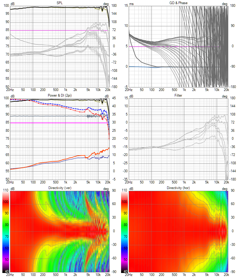

In-room prediction of one (single) driver plus floor and ceiling effects and a frequency shaded array of 25 drivers under the same conditions:
Listening distance 2.7 m, reflective floor and ceiling (absorption level set at -4 dB)

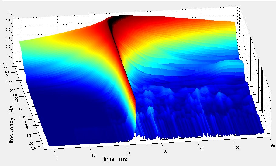

Timing of the wavefront at the listening spot from the earlier, non frequency shaded array:
Stereo pair recorded... graph recorded with APL_TDA in Demo version.
Objective: getting a clean and undisturbed wavefront at the ears that doesn't suffer from floor and ceiling reflections, absorbing all early reflections with absorptive panels placed at first reflection points to reduce their influence.
Absorbing poster behind listening spot, Absorbing panels behind curtains on side-wall. Ambience channels behind listening spot.

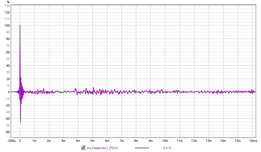

IR as measured (RAW) for left channel:

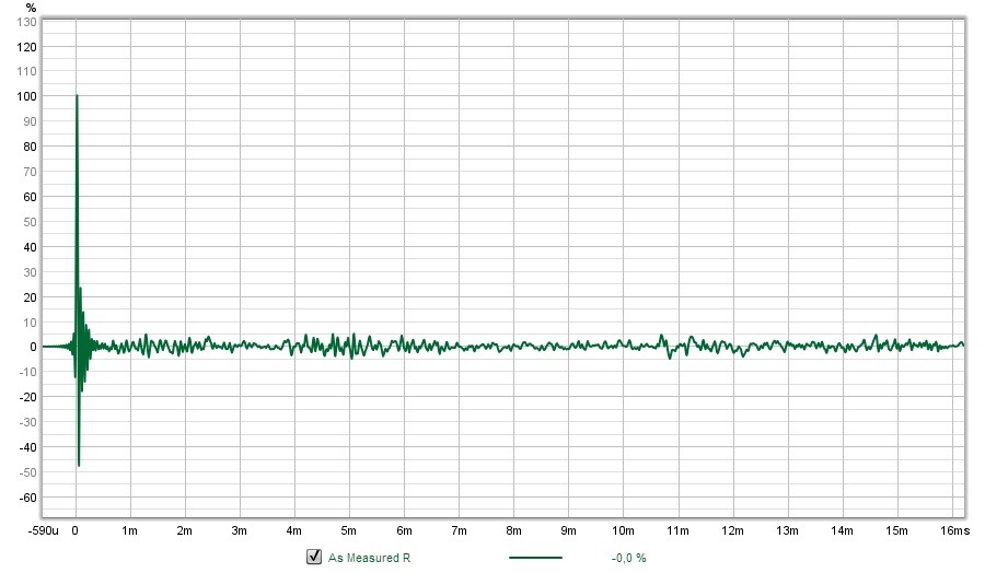

IR as measured (RAW) for right channel:
Prior to using DSP EQ to flatten the output. No high reflection peaks visible at the listening spot.
This is what makes the clean and timed arrival of the wave front at the listening position possible. See? Nothing too technical.
