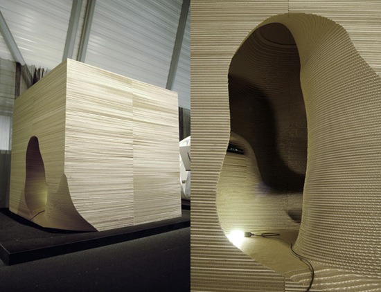

A very hard glue that could add some rigidity might be an interesting addition to that idea. If you could saturate the cardboard with it, it might get strong enough to survive long-term use.A layered cardboard enclosure may have some potential.
The desired shape is created by cutting multiple layers of cardboard and gluing them one on top of the other.
Beyond the acoustical issues, longevity was one of my main concerns with typical shipping box cardboard. A lot of it is pretty soft these days. The faces on the honeycomb versions I've run across have typically been a lot stiffer.
Are you open to the idea of a polyester or epoxy binder/stiffening agent? Or some other glue to accomplish the same thing? With enough internal bracing, I can imagine that making a single layer box more feasible also.
