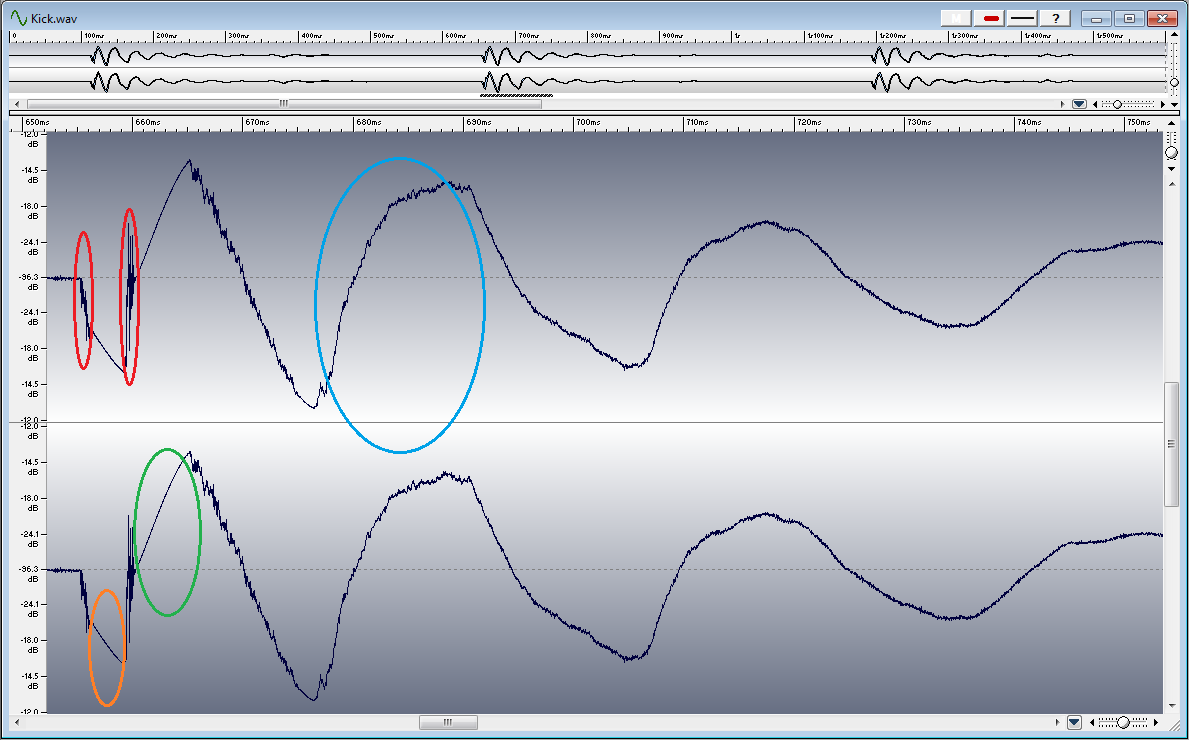

Applying the formula and getting the result wrong by a factor of 1000, you mean! How dumb, this is a complete howler of a mistake. The mike preamp obviously overloaded into slewing on a timescale of several ms, and slewing recovery is ringing at about 7kHz.
Thank you Mark for looking into that, you are right I was dumb (microseconds in place of nanoseconds and that went unchecked, no bell rung into my head)😱.
And mondogenerator thank you for the polite hint
The more puzzling thing is how a 44.1kHz sampled signal can resolve the claimed 7MHz distortion format to be seen in an audio tracker suite.
To resume:
Red areas. Rise time: 0.045ms. BW: 7.8kHz
Orange area. Rise time: 3.36ms. BW: 104Hz
Green area. Rise time: 4.42ms. BW: 79Hz
Blue area. Rise time: 11.61ms. BW: 30Hz

I did think the scale was ms, but I cant read it well on this mobile phone! (Besides, I often make silly errors, and I too appreciate a gentle nudge when experiencing a brain fart)
Regarding the Kick drum transient and spectral content; while it's been a while since I examined in detail, I am in no way surprised that 7kHz can be seen, whether due to mic/pre distortion or merely the use of a hard beater, or a combination of both.
Thinking something like Vinnie Paul (Pantera) playing HUGE kick drums with Remo Black skins (heavy) and hard beaters, and 1/16ths.

Look at other kick drums, that one is an aberration. Funny how this aberation turns into a thread like this, where it becomes proof that all kick drums have high freqs.
I know few people who would mic up the struck surface of a kick.
But everyone mics up snares top and bottom, and AFAIAC, a rim shot IS a snare.
Some of those heavy skins tend to sound clicks when you spank them, and then have to EQ the 2nd harm Boom out, but they're so heavy the fundamental is almost below audibility
But that sound IS genre specific.
I could post an interesting Gabba Kick with far more harmonics...
It's not natural, and for effect, but then most music production leans toward effects and not realism.
Realism is a niche thing
