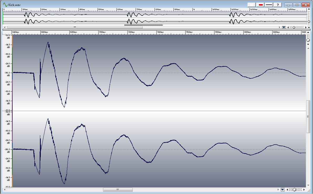

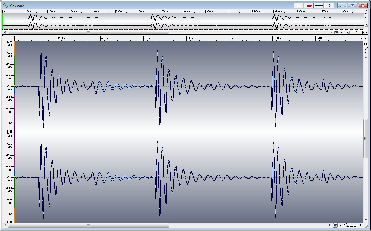

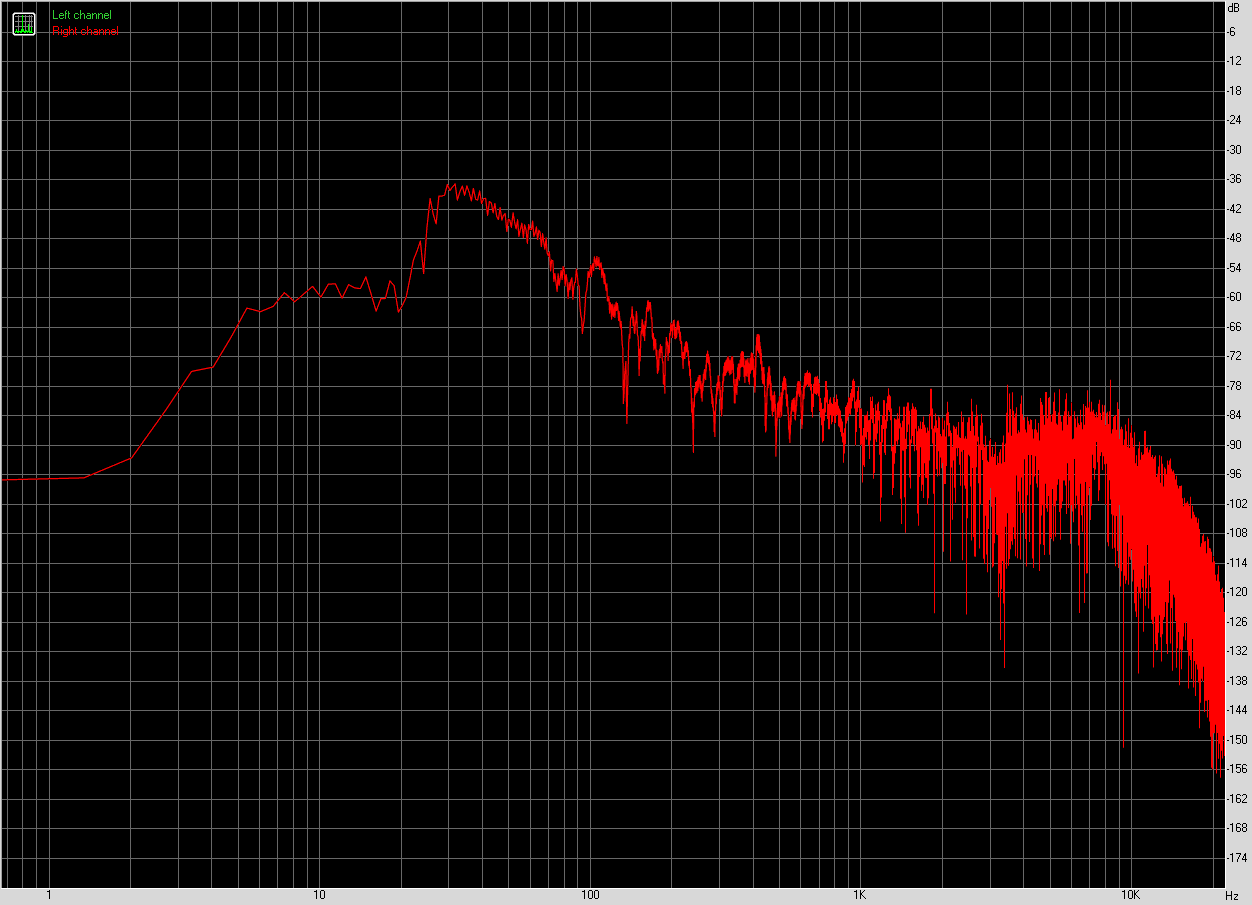

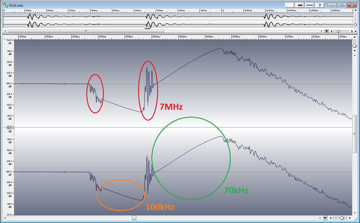

A hard strike on a kick drum generates content well into the MHz range due to the steep non sinusoidal shock wave generated.
Most probably a byproduct of mic/preamp distortion as in this kick drum recording (16bit/44.1kHz wav)
Gearslutz - View Single Post - Kick Drum Waveform + example: Should it look like this?
The bandwidth numbers shown is the result of applying the formula BW=0.35/RT
https://www.edn.com/electronics-blo...-The-bandwidth-of-a-signal-from-its-rise-time

The more puzzling thing is how a 44.1kHz sampled signal can resolve the claimed 7MHz distortion format to be seen in an audio tracker suite.
Possibly an encoding artifact?
