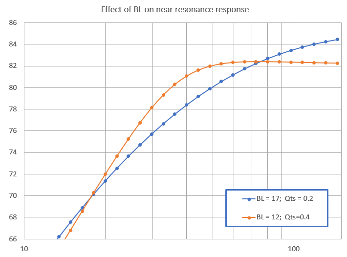

Here is what should be a pretty clear example. I used SL's SplMax worksheet that I linked to in a recent post.
The driver that is already populated in that spreadsheet is the Peerless 830500. It's a 12" subwoofer with BL=17.2 N/A and Qts=0.2. I simply changed the BL value to 12 N/A to raise the Qts to around 0.4. I then plotted the SPL values predicted in each case on the same graph. Everything else is exactly the same about the driver, box volume, input voltage, etc. The plot is attached.
I cannot read this plot in any other way except to say that, in the range of 20Hz - 80Hz, the LOWER BL DRIVER HAS HIGHER VOLTAGE SENSITIVITY. That also means that, over that range of frequencies, it is more efficient.
It doesn't matter what is happening outside this frequency range if the driver will be used as a subwoofer - the higher frequency portion of the driver's response is not being used at all in this application.
I can only guess that people are mesmerized by seeing a high efficiency listed in tables of TS parameters for a driver, without thinking about whether that is really relevant to the application at hand. In this case, it's not. The "efficiency" that is listed on a driver datasheet refers to the PASSBAND efficiency, where the passband is defined as the region above the un-EQ'd F3 of the system or, more generally, "mid band".

I cannot read this plot in any other way except to say that, in the range of 20Hz - 80Hz, the LOWER BL DRIVER HAS HIGHER VOLTAGE SENSITIVITY. That also means that, over that range of frequencies, it is more efficient.".
I don't think anyone in this discussion is talking about datasheet efficiency or sensitivity specs. I would assume everyone here knows those should be taken with a grain of salt or two and that it varies with frequency and is thinking in terms of a response measurement over a broad bandwidth.
Charlie, that doesn't show max SPL. That's at some nominal voltage (2.83 Vrms?). I am not reading anyone arguing that point. Voltage sensitivity isn't efficiency. Never has been, never will be.

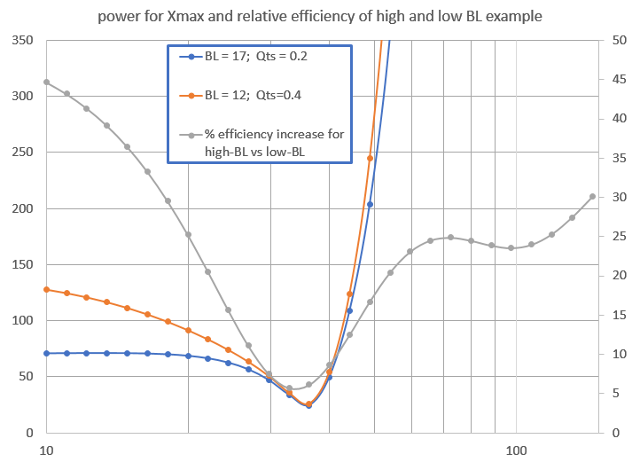

I was able to use the SPLmax spreadsheet to calculate efficiency, and I WAS WRONG ABOUT THE EFFICIENCY! Read on for more details...

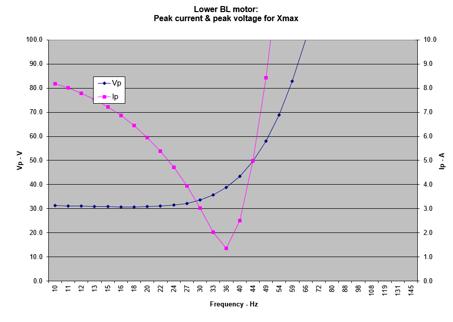

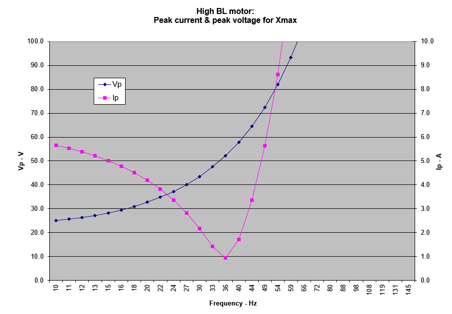

Attached are three plots. In the plot with the lighter background, the orange and blue curves are the power (Vrms*Irms) needed to reach Xmax for each case. The blue curve is the "high BL/low Qts" version of the driver and the orange curve is the "lower BL/higher Qts" version of the driver. The only thing that was changed was the BL strength of the motor and all other parameters remain the same. It's obvious that the blue curve is always below the orange curve, which means that the high BL motor will always require less power to reach Xmax. Wow, OK, that is new to me and very interesting. The gray curve shows the percent less power that is needed by the high BL version of the driver. This drops to a minimum of about 10% around resonance, but more significantly rises to 25% by 20Hz and keeps climbing to 50% by 10Hz.
Ok, the driver with higher BL is more efficient. I never bothered to look at it this way, and I can't argue with the numbers here.
But let's look at this a little more. I have attached two additional plots of voltage and current required to reach Xmax as a function of frequency for each case. The lower BL motor requires much more current at the lowest frequencies, as much as 45% more current. On the other hand, the high BL motor requires higher voltage especially around resonance where it needs almost 60% higher rail voltage to reach Xmax.
If you really want to push the driver to Xmax at the lowest frequencies (20Hz and below) in a closed box then the high BL system is clearly better in terms of efficiency. I had not looked at this angle before, so it is a surprise to me. The lower current demand is a strong benefit because it drives VC heating. But at higher frequencies you will really need a very high power amplifier (into 4R/8R) because of the need to apply higher voltage to reach Xmax. In this case that is around 35Hz, but this will change depending on the specifics of each driver and box. I might plug the specs from the iPAL into the SPLmax spreadsheet and check it out in a little more detail to learn more.
I can now see why the high BL subwoofer might have some pluses, especially for the lowest bass, but will likely require pro amps to reach its potential. I am sure that is fine in many cases but not my cup of tea (but maybe I'm learning something new here). Now that there are some high Xmax, high BL drivers available there are some interesting opportunities.
