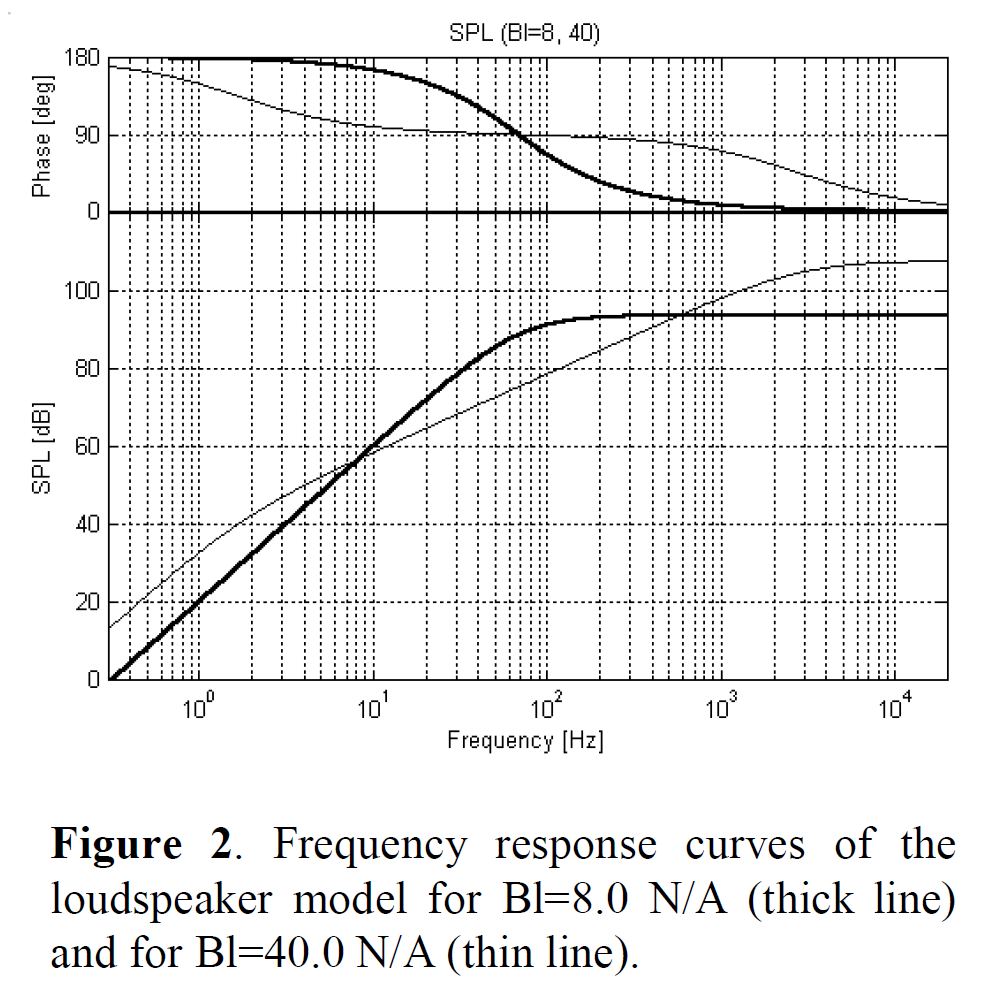

I will use an example from that paper to show the point I am trying to make about low-Q (high BL) drivers, and how they are inefficient in the bass region. You can read the paper for the full details. I have attached Figure 2. What I write below is only for that case that such a high-BL, low Qts driver is used in a closed box as a subwoofer (that's the subject of this thread).
Figure 2 shows the response from two drivers, both in a 25 liter box: one has a "normal" 8 N/m BL value (thick line) and the other has a very (in my opinion) high BL value of 40 N/m (thin line). The high BL driver has a stronger motor, and this causes the Qts value to be much lower. This causes a "premature" rolloff at 6dB per octave at the low end of the passband, and this finally becomes the ultimate 12dB/octave rolloff at much lower frequencies.
To me Figure 2 shows what I usually find with low Qts drivers: their efficiency is LESS than a higher Qts driver in the bass range in a sealed box. You can see this in the range of about 10Hz to 400Hz in the example, where the thin line is lower than the thick one. This is exactly the range (10-100Hz at least) for low bass. I really do not see why this is "better"!
You will need MORE POWER for the same SPL and you will have to apply equalization. Why not use a more appropriate driver in the first place?
The next argument seems to be that "you can put the driver in a much smaller box" and then EQ it to be the same as the "normal BL" driver. They show an example where the box size was reduced from 25 liters to ONE LITER! Sure you can, but as I pointed out in my recent post, when you do that you INCREASE DISTORTION and this is especially true for a subwoofer where the cone is making large excursions and the box is "small" compared to the total swept volume (Sd*Xmax). If your goal is to move the most hair by playing your subwoofer through an open car window, then OK this might be what you are looking for. If you are not after that crappy "blatt-blatt" hyper-distorted car-audio bass sound, then you might want to consider distortion in your approach. These authors did not seem to take note of it, or any other repercussion of putting a driver in a very small box. Perhaps sound quality was not of concern to them?
Now let's think about where these high-BL drivers might be useful - it will be at higher frequencies where you can indeed put the driver in a small box and make use of the high BL and high passband efficiency. At 200-300Hz and above, these drivers, in a small(er) box, can really be super efficient! But not when they are deployed as subwoofer, in the lowest frequencies. This application is really best when used for midbass and higher frequencies, or when the driver is large perhaps above 100Hz.
Finally, why the authors bothered to include section 7 showing that very low-Qts drivers are unsuitable in a vented box is beyond me. That is common knowledge. Such a driver will always result in a peaking response around the box tuning, and that will ring badly. That has been known since Thiele's work in the 1950s.

...For those complaining about equalisation you can also just add mass to the cone as is shown at the end of the paper, at the expense of higher frequency efficiency. The paper also shows this type of high BL driver.. If you look on data-bass you will see that this type of driver does perform well in tapped horns if more efficient but larger speakers are desirable.
I think we need some new terminology to unwrap "sensitivity", "efficiency", "loudness" and so on*. CharlieLaub (who has posted some very worthwhile contributions here) shows that sometimes you can get more loudness with a weaker motor. Something doesn't sound right there.
Maybe I'm spending too much time dreaming about motorcycles this time of year, but really really odd to me that (speaker) drivers aren't also rated by "horsepower per cone weight" or some direct index of oomph. Why doesn't that make sense?
If more BL doesn't make a speaker better then something is very wrong with our design logic when a smaller BL sims-out to a better FR.
B.
*yes, I know there are reliable definitions of these terms but they still may not be saying what we want to communicate
The problem is that the nomenclature is too simplistic. What exactly IS the senstivity when the frequency response varies all of the place? Usually (historically) the voltage sensitivity was taken over some mid-passband average, or at 1kHz.
What we are talking about in this application (a subwoofer) is happening only near the resonance region. The closest ROT would be Hoffman's Iron Law, but even that falls down because what is F3 in this case? HIL essentially assumes a "maximally flat" response, not a super droopy one. The lone remaining metric IS the frequency response with a known power input (e.g. at 1W or 2.83V). Clearly the low Q driver is not at all efficient, not anything close to its passband efficiency, at low frequencies. That is precisely where we will be operating it in this application. You don't get to make use of the high passband efficiency, because you are not operating the driver in its passband.
Maybe an analogy would be something like "you can increase horsepower, but at the expense of torque". Then I ask you: which motor will get the bike from a standstill to 100kph faster?
I'm not convinced. With everything else held constant, when you increase motor strength the passband efficiency goes up but Qts goes down and the low end response droops. To a degree this is OK - a mild DSP correction is fine. But when the Qts drops to 0.2 then things have gone too far.
