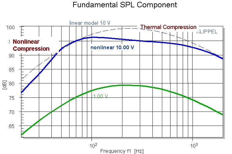

Michael Gerstgrasser is simply calling thermal power compression distortion.
"Obvious the resulting current flow through the voice coil for the same speakers terminal input voltage is dropping at around 35% also – hence - SPL will drop by 35% consequently. This is a 35% (!!) DISTORTION"
Mark Gander's white paper "Dynamic Linearity and Power Compression in Moving-Coil Loudspeakers" presented at the 1984 AES convention is far more detailed and informative.

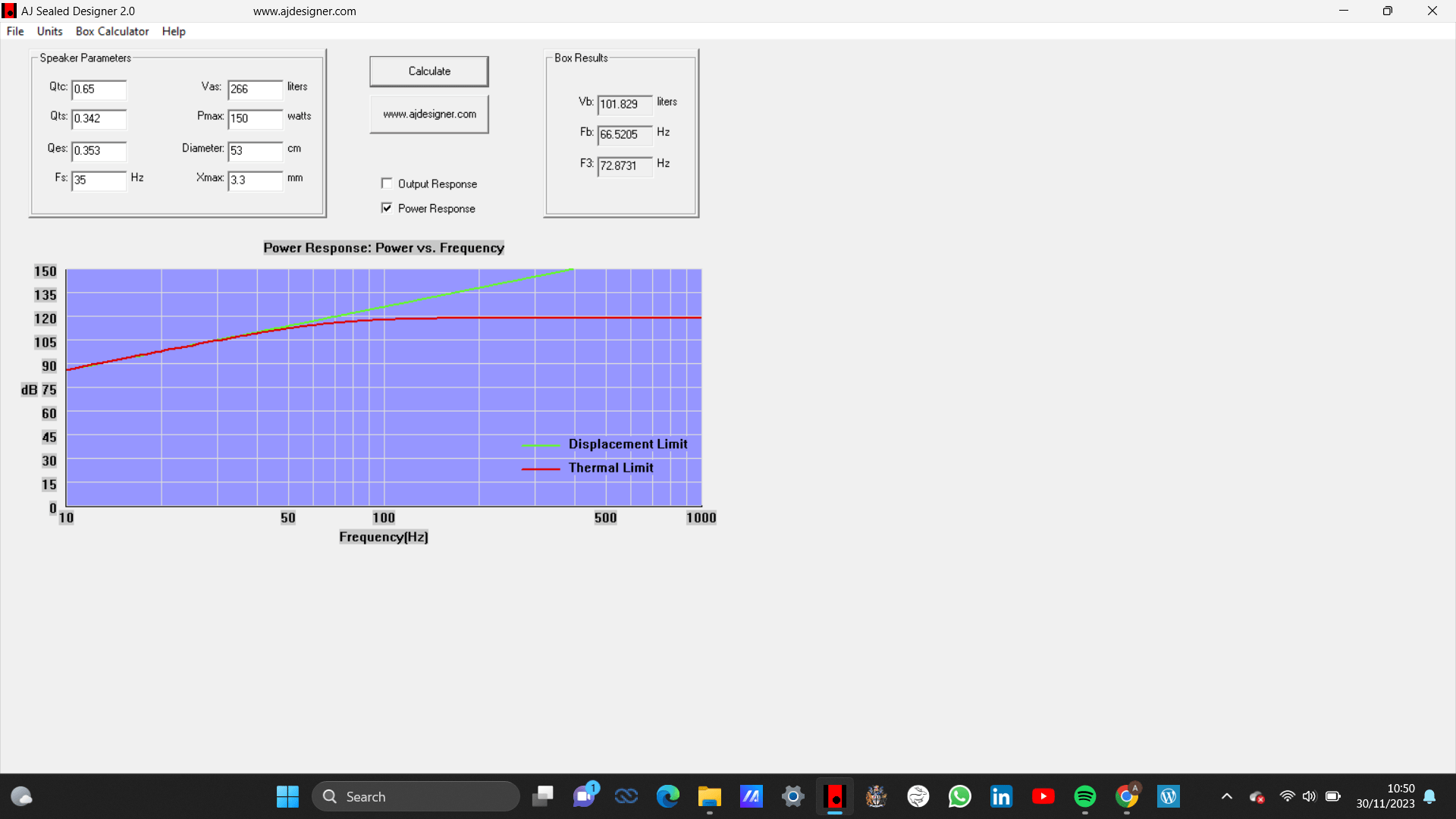

Here is a sim of the new 21 inch PD driver, one at rated power and one with just 100 watts (one fifteenth or its rated power!) just for Arez benefit! 😉I am most interested in this idea @Hydrogen Alex

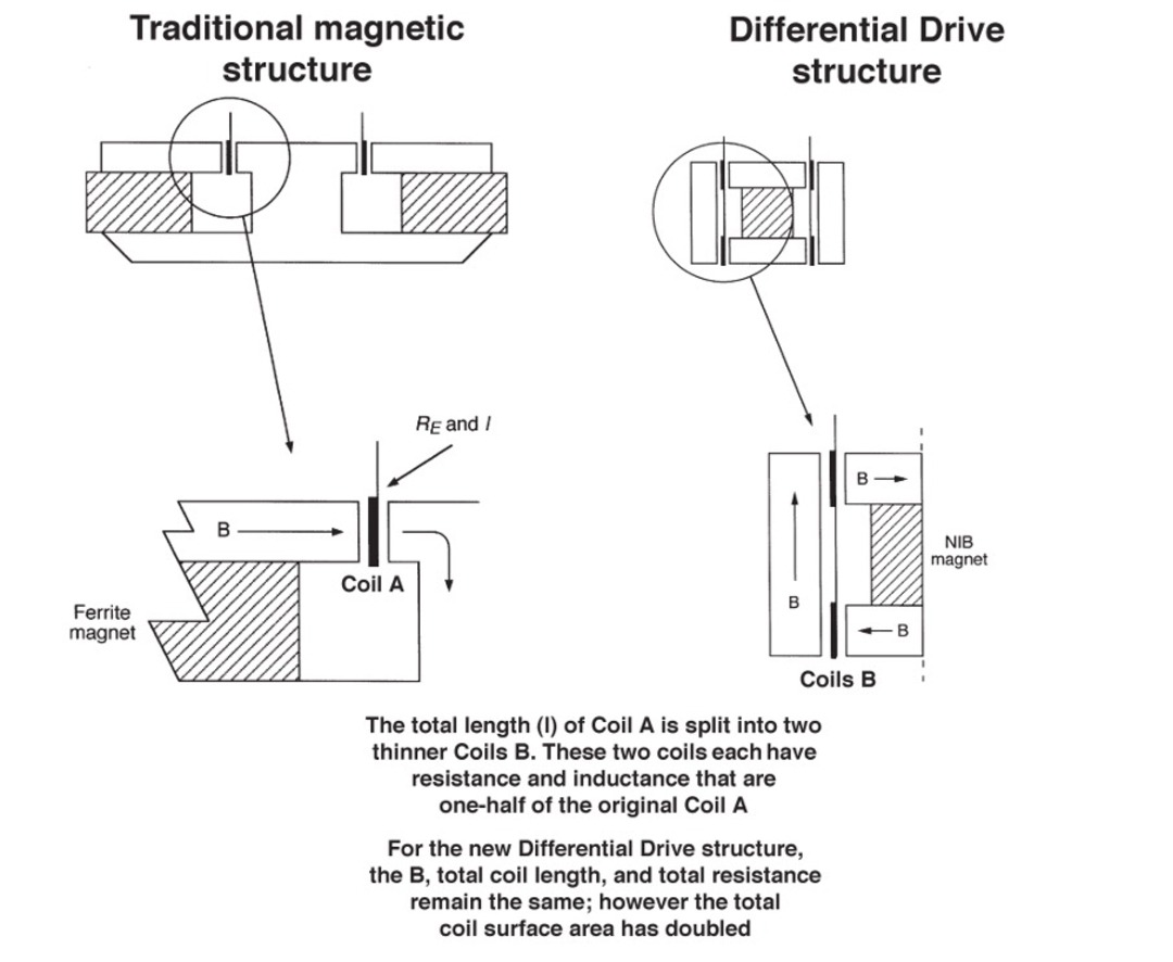

There are many ways to the goal, and in terms of power compression, JBL "low TCR" voice coils are the best approach to that so far, even with 3" voice coils, no need to mention the double voice coils has as much surface area as a traditional 6"😱Introducing Thermal Distortion by Ing. Michael Gerstgrasser
This is a superb paper by a DIY legend... Thermal Distortion is usually and incorrectly called "Power Compression" and this paper explains why large voice coils
(like Precision Devices) deliver such dynamic low distortion sound compared to the cheap small voice coil / huge Xmax /rubber surround automotive / HT type drivers.
Used in the 2216ND, 2216ND-1, 2213ND-2 for example, along with a large chassis for heatsinking / thermal transfer to the frame. And dual VC "Differential Drive".
Again Klippel will measure power compression, and give you Small and large signal parameters, as can be found in JBL EDS Transducers spec sheets of newer dates for example.

Sorry, I don't consider a box with a -3dB point of 72 ish hz a 'subwoofer'.

Outstanding results in what way? It's a sealed box, and below resonance the suspension and box dominate the response.Anyone who doesn't understand the ELF principal will make that mistake... ELF subwoofers are designed to give outstanding results below box resonance which means the higher F3 and Fb are the better they sound over a broader range.

Based on a sim of T&S parameters?It does this with lower distortion and higher SPL than any of the drivers you mention.
The smaller the closed box the higher the distortion in the low end btw, especially in a room.
A small box is good if you have a driver that is plagued by suspension nonlinearities, as they used to be, else it adds nonlinearity to a noticeable extent.

The Faital Pro 18XL1800 has comfortably more excursion-limited output than the PD driver, if that's your thing.
FWIW, when you bandwidth-limit to below the system resonance, there will be no overshoot. I can see that might be unintuitive, but essentially the driver is moving very very slowly compared to what it's capable of, and is therefore capable of following the waveform within the linear limits of the driver.
Chris
Yes, but do notice the Faital xmax calculations, is more optimistic then what most manufacturers use🙂The Faital Pro 18XL1800 has comfortably more excursion-limited output than the PD driver, if that's your thing.
