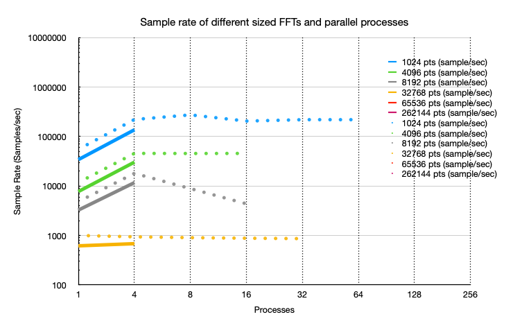

CPU only results for RP 4 at 1.8GHz (stock board and image) vs zero 2 (1GHz) vs ODroid C2 (1.5GHz) vs i7 (3.2GHz). The RP4 I noted is running in 32bit ("arm7") and the Zero is running 32bit.
On the left side: RP4 line, Zero 2W dash and C2 as dots. On the right i7 with 4 cores in the VM.
So first things - the RP4 out performs the C2 and, unsurprising, blows the zero out of the water. There's no heatsink attached it didn't throttle below 1.8GHz. And it's a decent performer for as simple SoC - the CM4 shares the same IC so that looks promising - but they must increase memory performance off they want to enter the compute space (or "compute" is just a load of marketing hogwash).
I don't know what was going down with the 32Kpts FFT perhaps cache thrashing but also this is a 2GB RP4 running a desktop and desktop OS image. It is running 64GB faster SD card (although this isn't used). Swap use is non-existent. It may be the CP throttling (although it's not reporting it).
So a single RP4 isn't going todo 1MSPS 1Mpt FFT in realtime (even the i7 won't). A couple of RP4s will do 1MSPS 1024pts FFT if the FFT is split and the with a 10 sample average running, an RP could do 4096pts FFT at 100Ksps.

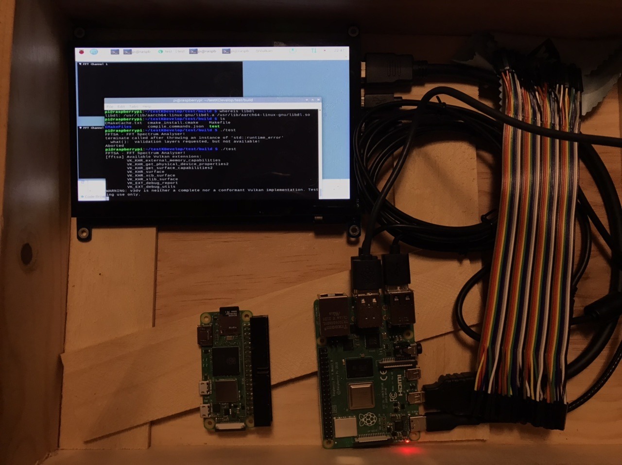

In other news - after the 3 hour build I have the zero with a vkFFT complied for OpenCL but it was giving me an odd exit return code and I got distracted.
The Mrs has started asking questions.. like "I thought that you were making something for headphones" and the telling "that's big for headphones" looking at the 16 tube OTL HP amplifier that will need some power transformers at some point.. Given some of the electronics retailers are showing out of stock for MG SAC305 solder.. and she found it difficult sourcing an iPad for her large new Circut gadget.. that's going to be done next year.. and I'm slumming it with this:

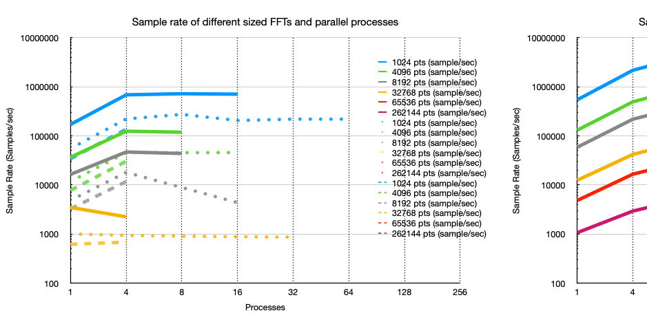

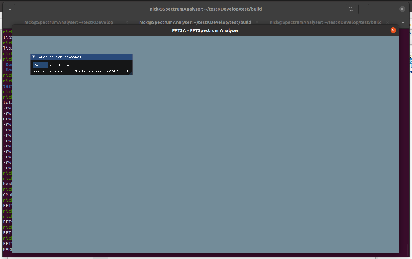

So "Dear ImGUI" works with OpenGL ES 3.1 and has a wider support of device types compared to nanogui (that requires 3.3 which the RP4 doesn't have at the moment and may never have). There's also a lot of extension libraries for this too.
I've just tried the Vulkan backend implementation of imgui and that works well on the RP4 with a touch screen - I think we have our OpenGL GUI for our spectrum analyser.
So my intent here is to make a View-Model-Controller style architecture - this means that the Model is the FFT/spectrogram/harmonics etc, the View is the OpenGL rendering of the model information, and the control is the GUI operation of the features for that. It does get a little complex if we start overlaying things - such as multiple traces etc but for now that gives a nice starting point. Apple software uses MVC and so do most desktops. It doesn't have to be complex but the loose coupling makes it easier to extend or adjust without having to hack too much.

Can I clarify that when you say samples/second you mean FFTs/second - a completely different thing...First run at 32K fft size and it's providing 621 s/cpu sec and 618 s/second with the existing code.... so not as bad as you'd expect considering it's 1GHz instead of 1.5GHz also DDR2.
So the dotted line is the C2 real samples/sec,
Sure.
Samples per second - the rate of samples from the ADC on the output bus (following internal filtering/decimation)
The FFT/sec is the rate of FFTs (sizes vary as above) per second generated.
In the realtime processing each sample received results in a delta multiplied by the coefficients which is then applied across the current FFT. So for each sample a new updated FFT is available. Samples are not batched into a buffer and the buffer FFT'd.
For offline FFT - the samples are recorded into a larger block (say 32K or 1M) and the current block is used to create a new FFT. So sample rate and FFT rate are independent.
In the CPU results graphs (realtime)- the FFT size is set, for example 1024 or 32K and the maximum online sample processing rate is recorded - that's the Y axis.
The CPU results X axis shows processes in parallel - this is the total samples/sec (Y axis) of that number of processes operating in parallel processing the FFT size.
The reason why samples/sec and FFTs become related is the realtime coefficient approach. When a large FFT increases processing time per sample, the sample rate capacity reduces.
Perhaps the graph Y axis should be labled "Sample rate capacity" indicating the maximum rate achieved with the FFT size and parallelism. Naturally you want the capacity to be faster than the ADC sample rate for realtime. For offline - the capacity indicates how many FFTs can be generated/sec of the defined sample set size.
For the GPU graphs, those are offline and FFT/sec.
So it's been a while since my professional days of coding (2005 time frame to be exact), however I've recently had to save company's deliveries by stepping in and doing coding in Java and C++ with KDevelop. This is my first using IMGUI, CMake etc in anger.
The hello world of GUIs.. so part stolen from the example but restructured into C++. I could have done Python but the components would still have been lower languages. In the end the GUI management may still switch to Python to help spongability and adding of features/integration etc should anyone else want to help. I've also created a GitHub "fftsa" repo so once there's enough to make sense I'll upload the sources - probably under GPL licensing.
What is nice is this works on the VM. So although vkFFT won't work, at least the GUI/OpenCL development can be done on both the larger system and the PI. I'll not spam the forum with development progress but stick with the interesting bits around signal processing and features etc. The initial baby steps - I'll stick with 5 initially:
