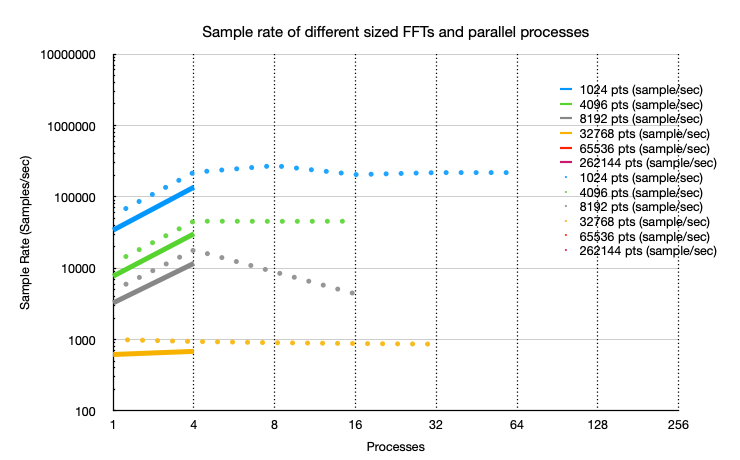

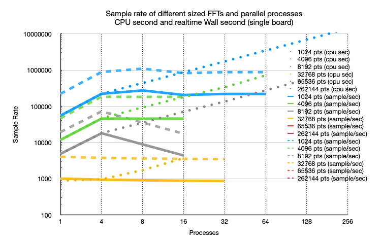

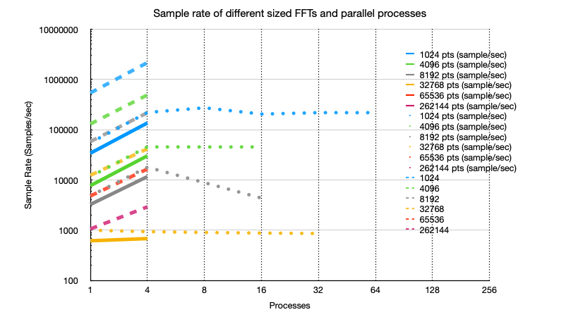

In short - we have a simple concept for FFT but there's a lot of memory I/O for that simplicity. Where we would obtain speed is in:
* parallel smaller blocks where the blocks do not span L1 cache pages on different CPU cores - for example we break the 1M into 4, one for each core.
* reduce LDR reads given our coefficients are fetched from a span of 1M in stepped by the frequency bin (ie step frequency = rate = Hz). This allows us to reduce the spanning and the amount of data. The issue here is our sample is marching forward through through each bin - less of an issue if we're averaging a number of samples but at a full 1M this won't work. If this sounds confusing - simplify the data we're fetching so it's fetching is more efficient.

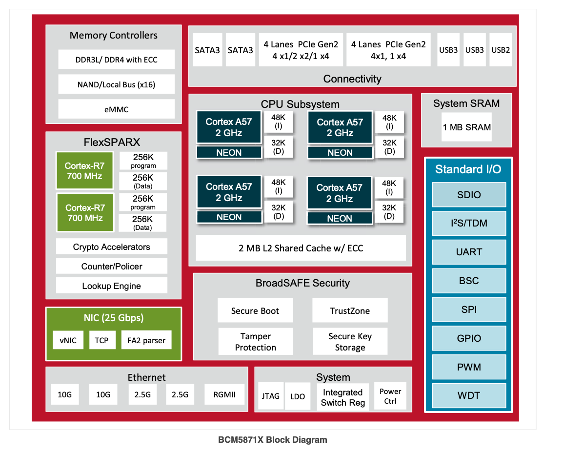

* The interesting question is - could we also setup the Broadcom (RPi) flexspark accelerator ARM cores (these are are not the same as core/neon etc) but can run programs separately. to add more processing bandwidth. The issue here is the performance is not well understood: (look middle left):
There are two Flexspark cores that could be used - perhaps in data offload with the I/O to clear the constructed FFTs.
These from the initial read are controlled by a set of memory mapped control registers just like the I/O peripheral hardware controllers.

On the Flexsparx ARM cores - these look like they're tied into the Broadcom proprietary NIC functionality as network packet handling accelerators. That would be a concern from a security perspective.. fingers crossed that they're secure otherwise every RP4 could be targeted as a DOS source.
However this means that the RP4 NIC can access the external SRAM without going through the ARM chip.
9.3.4. 24-bit read command
A 24-bit read can be achieved by using the command 0x04.
However it's annoying that the LoSSI mode clocking doesn't allow the read operation to be externally clocked (or it's not clear that 'grey mode' and 'LoSSI' can be combined).

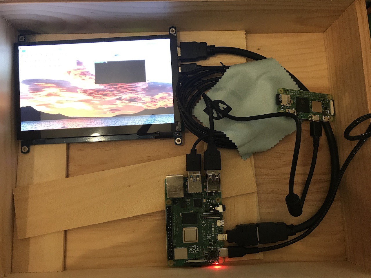

So whilst the forum software was updated I've received my bits - only thing is I'm now waiting for the wife's PRC test to end quarantine before I can solve it. The RPI 4 is the only device in the house that has a USB-C (other than the Mac lighting ports) hence I have no cables or wallwalt. So I should have power for it today
I managed to resurrect the ODroid C2 using the UART port - reinstalled a minimal ubuntu install with kernel 3.16 and do some cross compiling and testing. Annoyingly this has a dead HDMI connector (possibly due to the bend in the board by the factory heatsink clamp).The rest is fine.
I found I'd made a boo-boo in the original tests - the timing was CPU time and not wall time. The original tests were 4 cores of an i7 3.2GHz in a VM (the i7 has 6 cores with hyper threading enabled, thus 12 "cores") - the test results above are for the ODroid with is as a ARM v8 Cortex-a53 running at 1.5GHz with 2GB ram - in the tests the CPU hit 67degC but according to the current frequency rate did not throttle due to the passive heatsink.
The dotted line is the CPU timed rate. The solid line is the wall time sample rate (real samples per second). The longer dashes are the 4x the wall rate (essentially as if I had 4 boards in parallel - with the 4 busses we get a full multiplication). I only performed up to 32K samples given the rate was dropping below 1000 s/s.
SO.. the ODoid C2 isn't a slouch, but as can clearly be seen - when compared to the 4 cores of the i7 it's about 4x slower. Hence I'd need four ODroid C2s running to equal one i7 with 4CPUs in a VM. So I'd need a 16 C2s to push 1+MSPS at 1024 on the CPU!
Next job is to look at a comparison with optimised libraries
The issue with FFTW/FFTS is that they need an aligned memory location and the data needs copying in and out - that cost will hurt performance. However it may be that I may have to face facts and make a buffered non-pipelined..
The GPU flavours also have issues - in the same way that the CPU cousins need to copy in/out of aligned buffers, the GPU needs to DMA upload the data from the CPU shadow into the GPU memory area, process the GPU program kernel(s), then retrieve the result by DMA copying the data back from the GPU memory area into the CPU memory area. Thus again pipeline is not possible an it has to be a buffered approach.
Let me code up some basic tests performing the same test but with FFTW/FFTS and vkFFT. I would expect the vkFFT to be very fast but at a cost of the copy.
Incidentally it would be interesting to see if the vK works on the ZeroW2 (I'd need to run on normal linux for the test). I would expect if it works on the RP4 then it would work on the CM4.
Let's see where the tests take me.

Zero W 2 CPU results...
First surprise is that RPI OS Lite for the zero 2 runs 32bit (even though it has a A53 quad core CPU). There is a way to change this by altering the image but for now - let's see what 32 bit gives. I know that it's going to miss some registers and SIMD instructions..
First run at 32K fft size and it's providing 621 s/cpu sec and 618 s/second with the existing code.... so not as bad as you'd expect considering it's 1GHz instead of 1.5GHz also DDR2.
So the dotted line is the C2 real samples/sec, the solid line is the 32bit Zero 2 CPU based code. So a single core comparison is the Zero 2 is 62% the speed of a C2 and 6.66% of a i7 core (comparing 1024point and 1M samples as it's so fast for the timing!)
Below - zero 2 (line), c2 (dot), i7 (dash):
The power supply for the RP4 arrives tomorrow and that, I'm expecting, will be approximately similar performance as the C2. That will also give me the option to compile the vkFFT for the RP as the sources don't like cross compiling from x86 to arm. I'll then start playing with the Zero and see if there's more performance (64 bit and GPU).
So from this it looks like (finger in the air guesstimate) that it may be possible to perform 100 FFT/sec (ie keep up with screen refresh rate) and have a decent FFT size but only if the samples are buffered into large batches and processed 'offline'. It may be possible with the CPU to process in realtime with 1024pt FFT - the 1MSPS could be averaged down to say 100KSPS for that 1024py FFT.
All the testing so far has been using 32bit floats which is not ideal and I'm itching to see how the performance goes with GPUs although those will be also running 32bit floats as a comparison. There's the option for 64 bit double floats with the CPU but that is going to be offline reprocessing of the recorded samples.

Just fighting the RP4 setup - so it recognised the touch screen but wrong resolution and the RPI desktop doesn't have an onscreen keyboard as part of the standard configuration! The Add/Remove program is dire - every time it locks up trying to search the large list.. when apt list grep works faster..
I think the RP4 CPU gets far hotter (and it's configured slower I think).
I'll make a metal construction inside the box to secure the screen and bits with screws.
So the 30W Belkin usb-c power adaptor has enough power but trying to run the zero from the RP4 USB ends up resetting the screen. So I think I need a USB power hub in there too. A little annoying with two mains plugs instead on one.
The sneaky thing is I can play with this whilst watching TV with the mrs Next up is to try the same test program as before on the RP4. First .. to check the speed settings. I have a sneaking suspicion it's running slow Mhz from the boot setup file..
