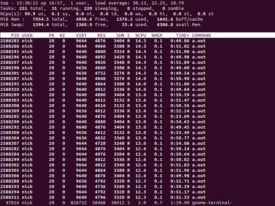

It occurred to me to run 4 single-threaded processes in parallel at the command line (facepalm) .. for a 1024bin, the result is over 500Ks/s each so 2Ms/sec in total. Running 8 processes returns the same.. about 520K each - or 4Msps.
So I think there's something fishy going on in the bowels of GNU and ubuntu..
16 processes (I use a bash script to trigger) .. and the same. 535K each or 8Msps. :D
So 30 processes ... 530K each... or 16Msps.. into 1024 bin.. so obviously we're probably running in the caches..
Ok let's try.. 32K bin.. and see our max rate.. let's go straight to 30 processes in parallel..
Code:
.... pending...
POOR THING..
I forgot that I multiplied the number of iterations by 1000 for the small 1024 sample size to get a decent time measurement.. 30 kill commands later..
32K bin
1 process = 12.5Ksps
4 processes = 30Ksps

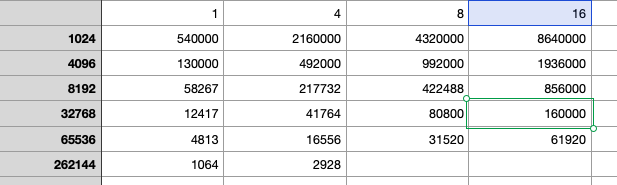

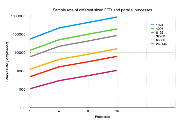

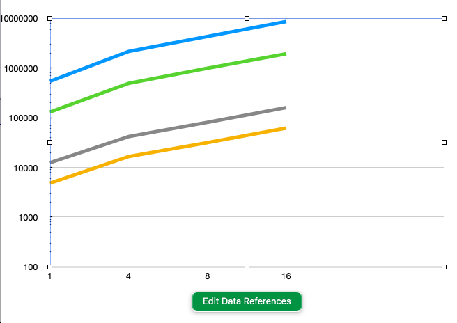

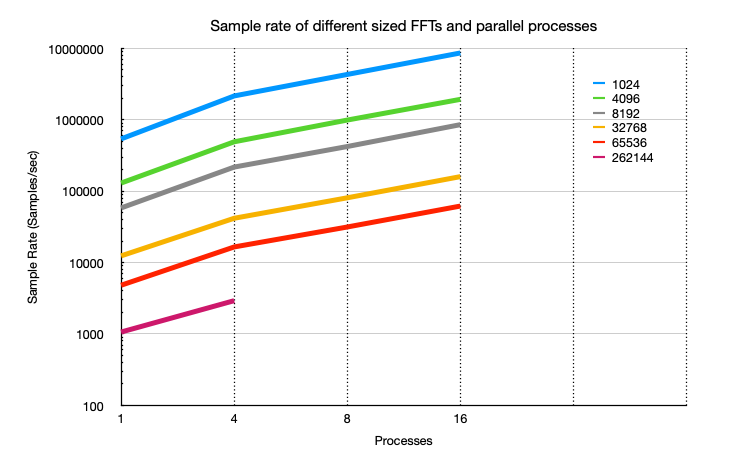

I'll do a graph of the following 1024, 4096, 32K, 128K, 256K and 1M... the reason the 4096 didn't differ is that it wasn't compiled..
So I think this is worth pursuing with multiple processes (and multiple boards).
