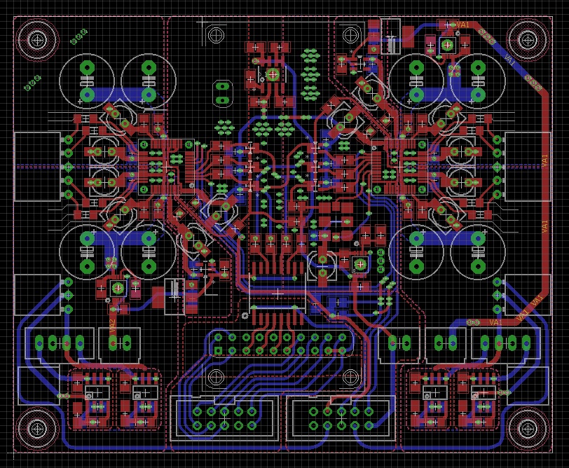

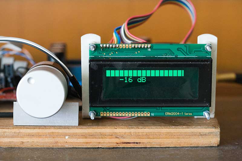

The truth is that the control is done by a tiny SMT32 board that plugs on to an adapter PCB that I designed in order to take care of signal isolation and easy connection to a 3.5" TFT:
Programming is done through the Arduino IDE, so it's very user friendly.
The controls include volume, filters, sound modes, Direct DSD, MCLK frequencies, etc.
Control is by rotary encoder and IR remote.

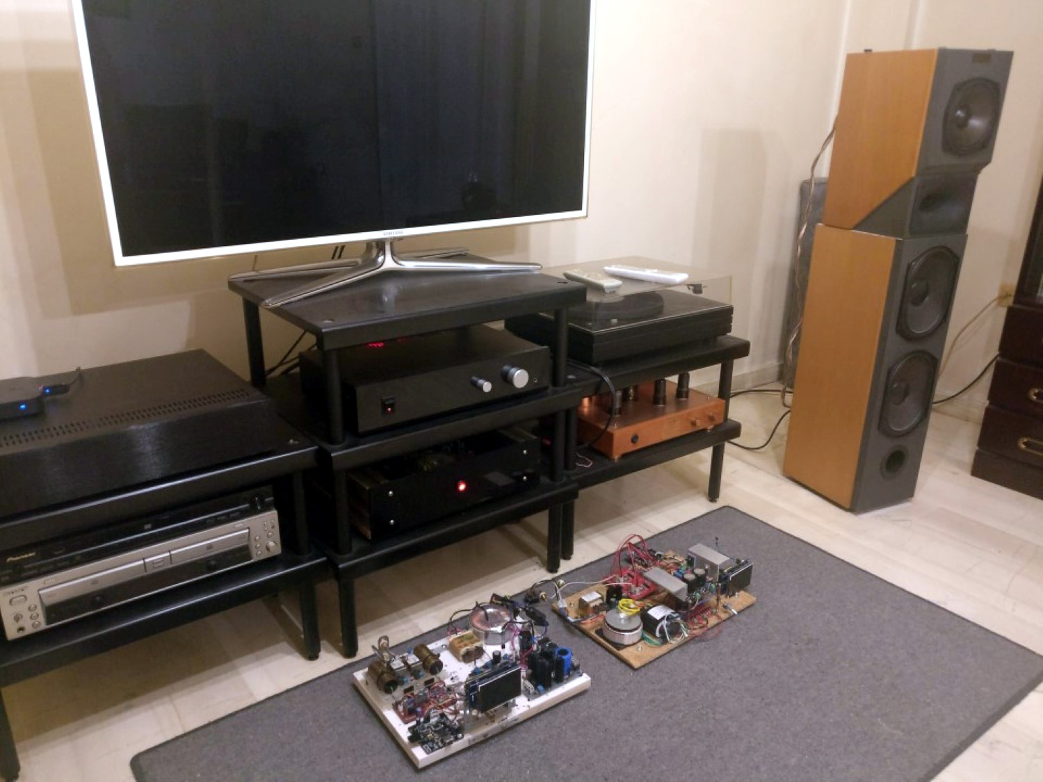

Yesterday Salas was kind enough to have me and lemon over for an audition of our dual mono AKs (seen on the floor).
The two dacs are almost identical, with the exception of their output stages. Lemon's DAC (on the left) uses a pair of Lundahl transformers while mine (on the right) uses a discreet class A output stage.
The audition focused mainly on determining the differences between the two dac implementations but at the end of the audition we also had a brief listen to my Soekris build.
The conclusion was that both of the implementations were very good in SQ, with the transformer-based dac sounding a tad more natural while the one with the discreet stage had a wider sound stage and a more dynamic sound.
I'm sure Salas and Manolis (lemon) will do a better job than me at describing the sonics of the dacs.

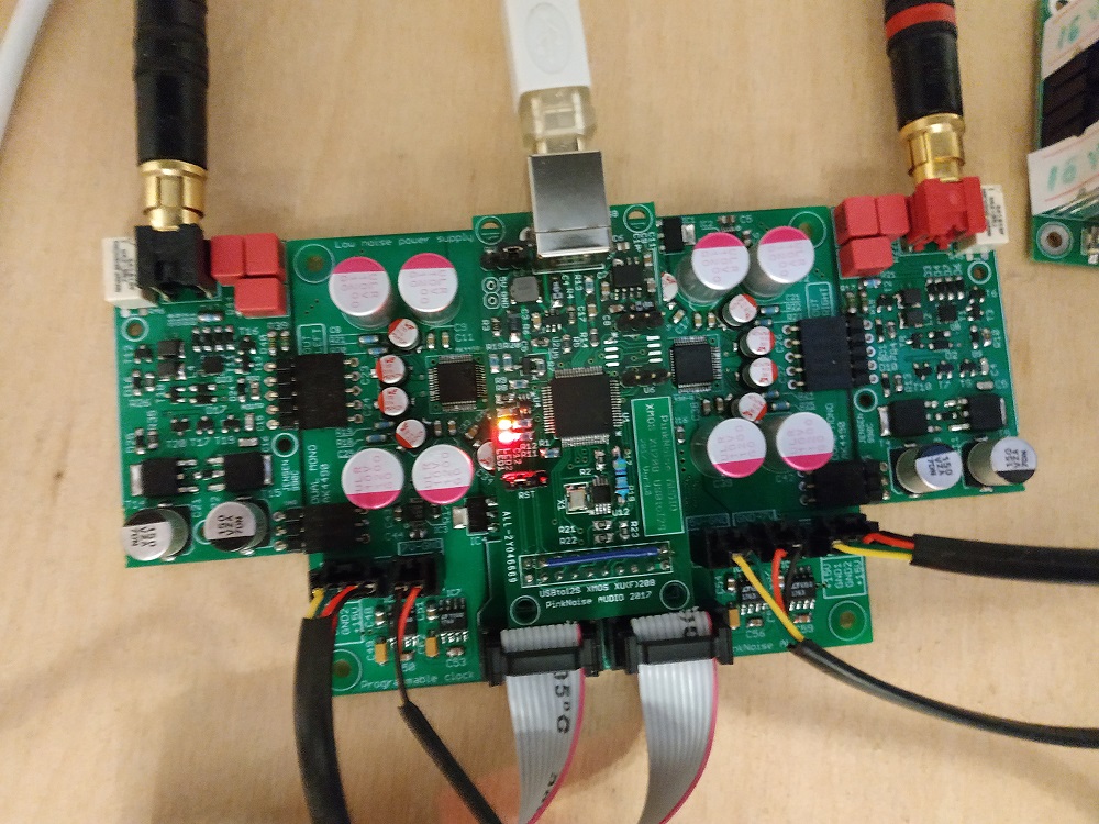

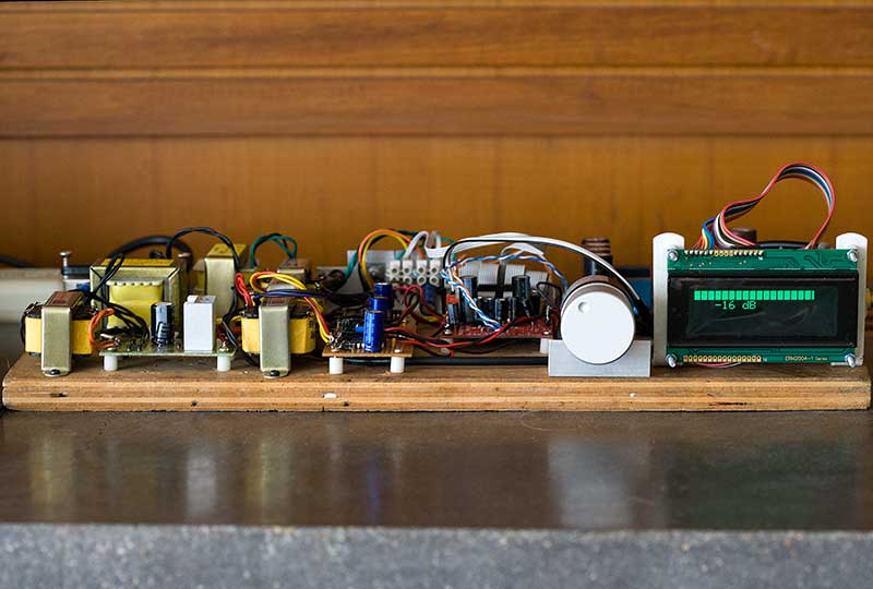

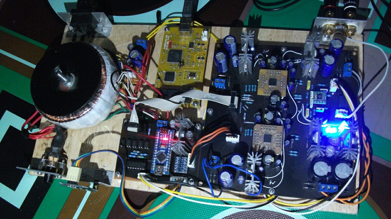

The two dacs are seem at the bottom of photo. They are made on wood boards for adjustment ease.
The usb custom receiver, AK board and controller are identical btw two dacs. The differences was at the pre-reg PSUs and the output stages.
I couldn't to describe better than Salas the listening differences btw these two dacs.

Both DACs had the same source, a custom Amanero-like design by Manolis clocked by the dac's on-board Si570 clock. An arduino-like controller takes care (among other things) of mclk selection according to incoming sampling rate.
The structure of the dac is two ak4490s, both fed the same i2s signal and the same mclk, each of them set up in mono operation. One is set up to output the left channel and the other one the right.
Their analog outputs are summed in the output stages.
Everything is DC coupled.

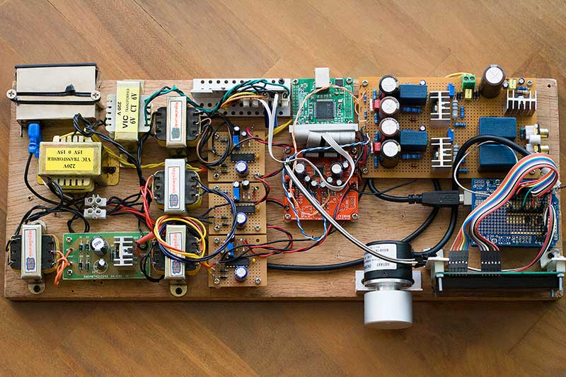

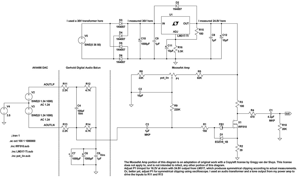

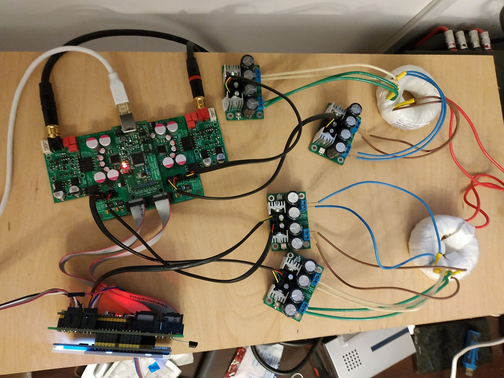

I thought I'd post some info regarding my own Arduino-controlled AK4490. No, it isn't dual mono, but it sounds quite good. It sounds much better than the Chinese AK4490 I previously used, and also better than my Chinese ES9018 before that. I used the DIYINHK AK4490 board and the DIYINHK multichannel XMOS-based USB-I2S board. Although I previously used a 6N16B tube-based output circuit, this time I chose solid state. More on the output circuit below.

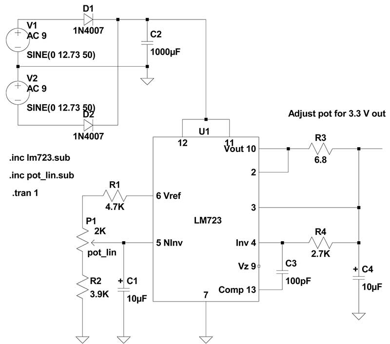

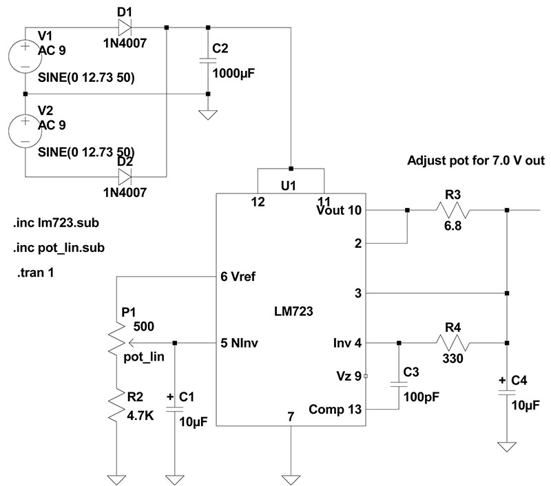

I chose to float all the supplies, so I'm using lots of transformers. The AK4490 board joins its supply grounds in a sort of star ground arrangement under the DAC chip. The grounds are not as strictly separated as they are on the AK evaluation board, but it seems to sound ok anyway. The USB-I2S board and the Arduino UNO R3 are powered by a separate 5V supply, and its ground is cnneccted to the DAC digital ground. The output circuit ground is connected to the DAC analog 7.0V supply ground.
So far I've built separate analog and digital 3.3V supplies, but only one analog 7.0V supply. I'll separate the two channels with individual 7.0V supplies soon, then perhaps another for Vref.
My DAC power supplies are based on the old LM723, which the datasheet shows has pretty low noise with a 10uF Cref capacitor. I chose the LM723 because it is cheap and plentiful locally, easy for a DIYer to solder, not too bad performance, and supplies sufficient current. Schematics are attached. I might decide to experiment with better quality Cref capacitors and see whether I can hear any difference. I might also experiment with using LEDs as a reference instead of the internal zener. Since I don't have golden ears, I expect to hear no difference, but you never know. Note that Horowitz in Art of Electronics says that the production spread on Vref is 6.8 to 7.5 V. The 7.0 V regulator will not work with samples on the low end of that range. He, of course, suggests a solution. My samples were just fine.
I put my Arduino code at Arduino UNO R3 code for AK4490 DAC * GitHub. It implements a volume control using an optical rotary encoder. I tried to document the implementation in code comments. The code is an combination of stuff I've used for other projects, so it might not look so pretty. I use a 4 line LCD display, and I intend to use the two lower lines for selecting and displaying sound quality settings and filter settings. I have not figured out what sort of interface I want yet, so that code is not present.
The output circuit includes an adaptation of a circuit from Barbara Gerhold of TUBECLINIC that she calls a digital audio balun. It also includes an adaptation of the Moosefet amplifier, which is Copyleft licensed by Gregg van der Sluys. The original can be found here: DIY Audio Projects Forum • MooseFET Preamplifier. I modified the gain of the amp so that I get 2.1 Vrms out at 0 dBFS with 7.0 V analog and reference voltages on the AK4490. I'm not smart enough to find a way to eliminate the input coupling cap, though I'm quite sure it is possible. I've attached a schematic. I figured that if I didn't like the sound of this circuit, I could build a PASS BOZ.
I tried this setup with both the DIYINHK multichannel XMOS board and an older XMOS board from Weiliang in China. I got lots of ticks and pops between albums using the Weiliang board but none using the DIYINHK board. It's just a guess, but I suspect the DIYINHK board streams silence all the time when there is no music playing, whereas the Weiliang board does not. I use JRiver Media Center 21 as my player. I could not find a setting in JRiver to tell it to stream silence between albums.
I have not yet experimented with DSD.

So, I took an old XMOS project I've made (Amanero like PCB and pinout) and I easily modified it in order to work in slave mode with Si570. Now all the sample rates work and the sound is absolutely amazing - I can compare it with another AK4490 software controlled project I have.
My PCB version is only 2 layer, because I intended to keep the price as low as possible. After some analyzes, I've found that the mirror placement is the best solution for 2 layers PCB.
Another modify I've made is the output analog filter. It is the filter from the AK4490 datasheet, except instead of monolithic opamp I choose a personal version of JE-990C with SSM2212.
I also made some pre-regulators with LT1085 for a wider power supply range. The trafos are 2x14VAC from TME whom I have made 2 more windings for 7VDC and 5VDC supplies.
Now it is time for the modules to go in a case.

I didn't figure out how to set the Amanero board to work with AK4490 (on Windows) on DSD mode. Both AKMs get DML bit = 1, so if I disable DDM bit, there is a sound in the right channel only. If I set DDM bit = 1, there is no sond on any channel, of course. I've got DSD working with Amanero on Linux, but I didn't like how the system sounds (PCM is OK, but DSD...).
I tested with Slave CPLD with MCLK/2 and all the available main firmwares for Amanero board, but no success with DSD. All PCM sample rates sound excellent.
