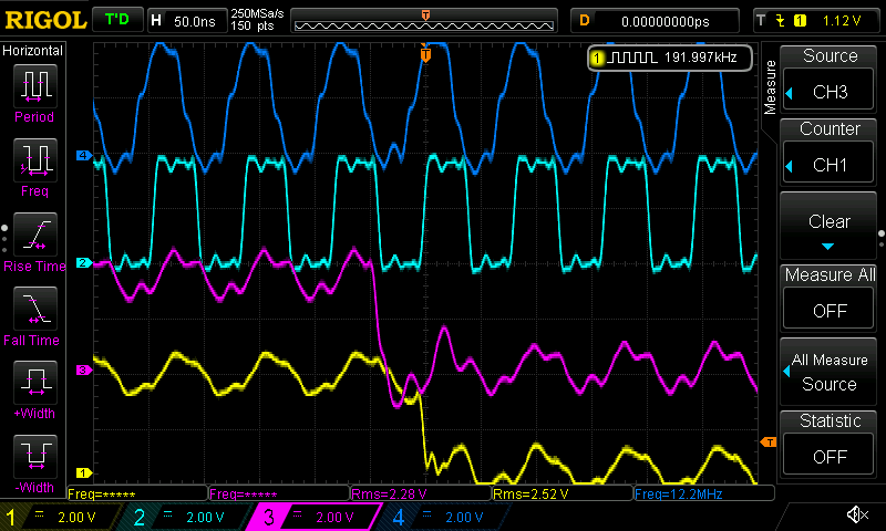

Also, look at this capture of the I2S signal both before (channels 0, 1, 2) and after the flip flops (channels 4, 5, 6). Ignore channel 3, it was supposed to be the MCLK but my logic analyzer has nowhere near the required bandwidth to capture it properly:
https://ibb.co/j2u7oQ
This was done on an unpopulated dual ak4490 board, with just the flip flops for one channel soldered on. Signal source was an Amanero, MCLK was the Amanero's.
It seems that the signal is OK in that the LRCK does start at the falling edge of BCLK.
Also the reclocking seems to be helping the DATA signal.
In this case, the BCLK looks OK on the oscilloscope. No "ghosting" or anything.
But, what you are looking at is the beginning of the capture. After a few seconds things might be different - I didn't think to capture several seconds af data and scroll down a few seconds to see what happens. That is on my to-do list.

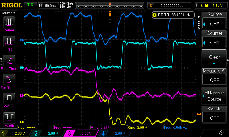

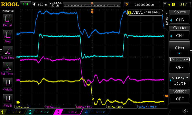

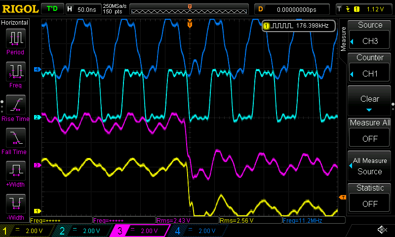

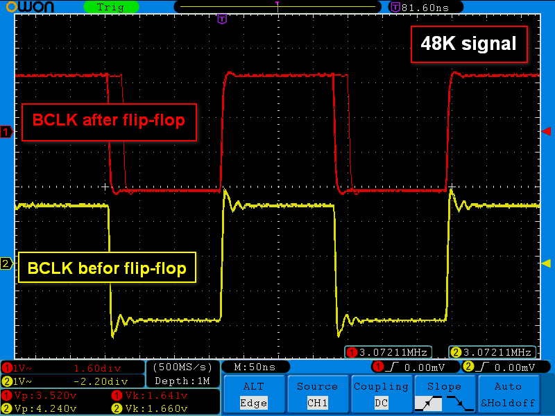

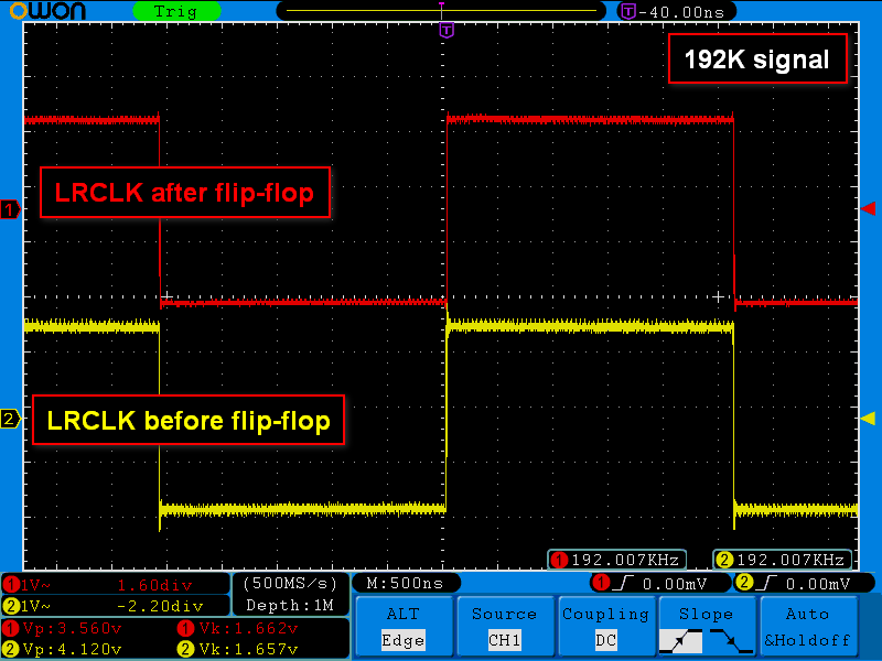

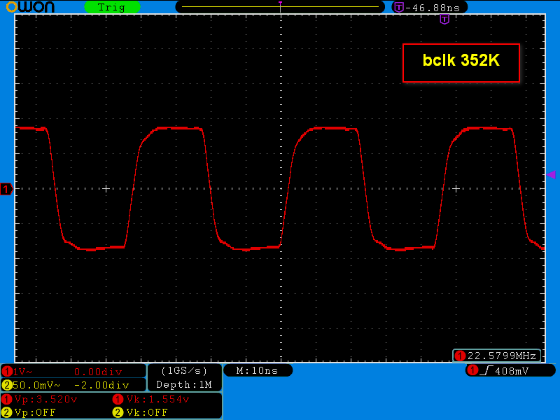

I seem to have made some progress.
I desoldered the Si570 from the board and provided MCLK from my Amanero (22/24MHz clocks).
The "ghosting" of the BCLK went away, proving that it was indeed an "artifact" of the different clock domains between the DAC board and the I2S source board.
Also, the "unlocks" went away as well, at all sampling rates and frequencies.
However, I am still a little worried about the timing between the BCLK and the LRCK.
Looking at these grabs, Input 4 (first trace from the top) is BCLK before the flip-flop, Input 2 (second trace from the top) is BCLK after the flip-flop, Input 3 (third trace from the top) is LRCK before the flip-flop, Input 1 (last trace from the top) is BCLK after the flip-flop.
44.1KHz:
88.2KHz:
172.4KHz:
192KHz:
It looks to me like at some frequencies the LRCK after the flip flops is delayed a little too much, especially in case of the 192K SR. It looks like it's almost gotten to the leading edge of BCLK, which should be a problem. However, the DAC does not seem to mind.
Don't pay too much attention to how clean the traces look - grounding was a mess while I was doing my tests.
One last thing, with the Amanero's MCLKs I couldn't get the flip-flops to do their work for 352K+ SRs but that is to be expected.. I'll also do tests with other I2S sources, ones that have faster MCLKs.
Your thoughts?

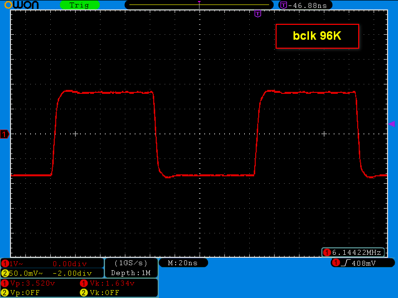

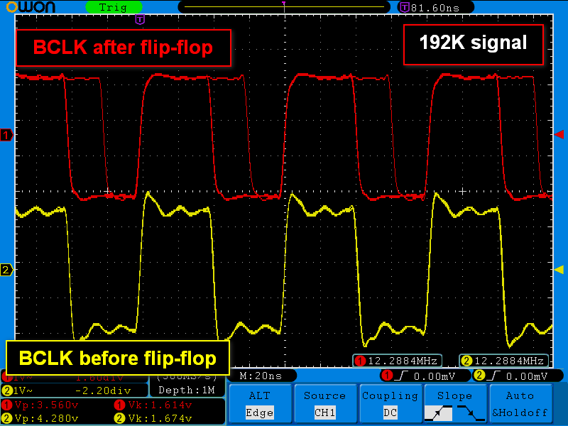

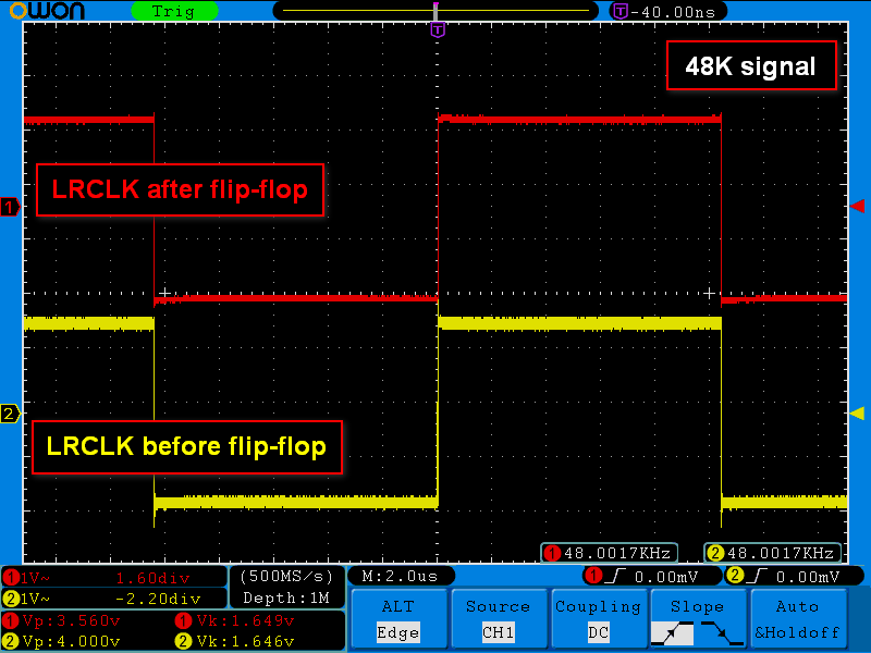

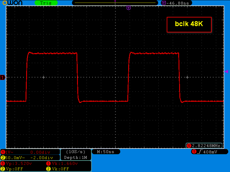

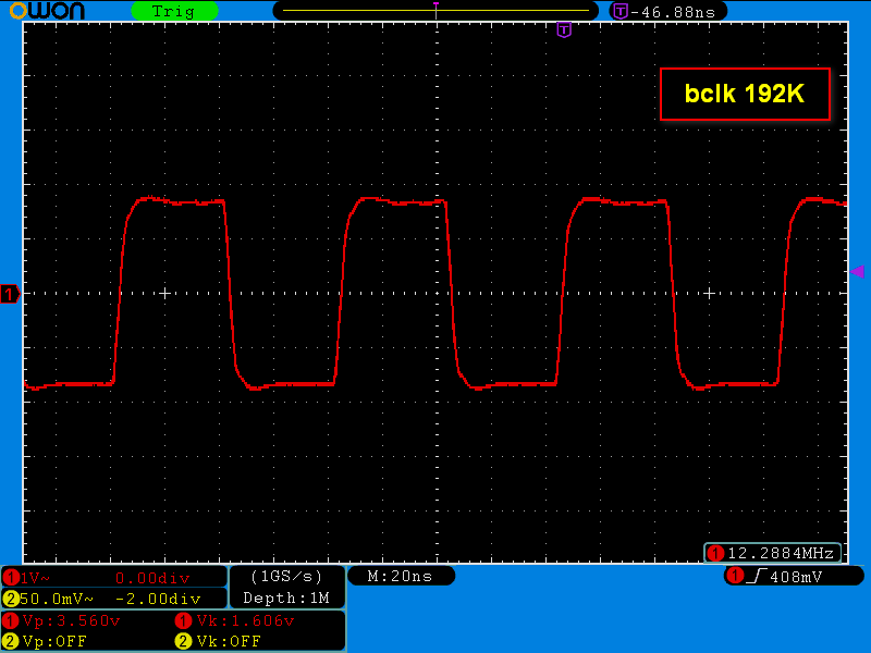

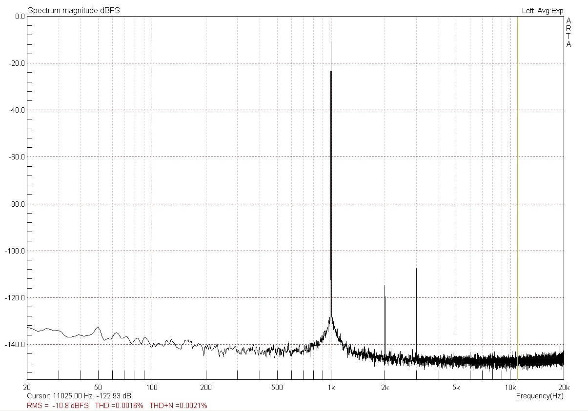

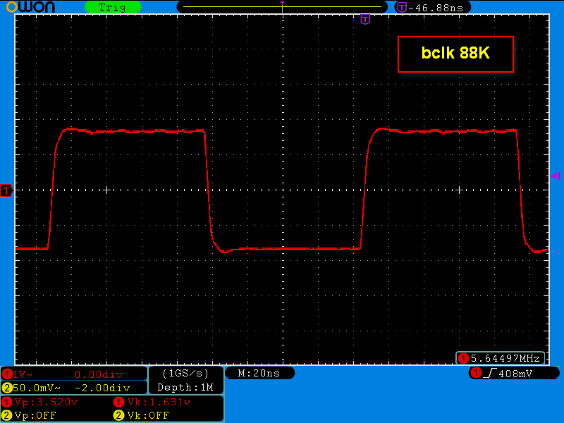

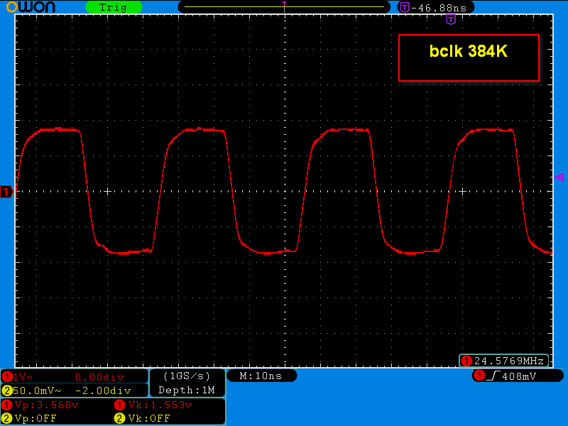

Just, I tried the same method like Dimitris.
I feed with amanero mclk the AK board and the rest of i2s signal are coming from the Acko S03 board normally.
All the "unlocks" went away as well, at all sampling rates and frequencies like Dimitris but I have no any lucky with the "ghosting" of the BCLK pulse that remains with a random "ghosting" delay of 20-22ns depends from the music sampling.
I have included 48/192K captures for this purpose.
I repeat the same for the LRCLK, with capture before and after flip-flop but I don't see the same delay as Dimitris. I have included 48/192K captures for this purpose.
At 352/384K sampling files, the "ghosting" pulse (bclk) is major and at random times covers 2 or 3 pulses with opposite phase or same phase (it is very complicated to captured in photo, only with a video). This is the reason that we can't to reproduce these sampling music files with the reclocking flip-flops.

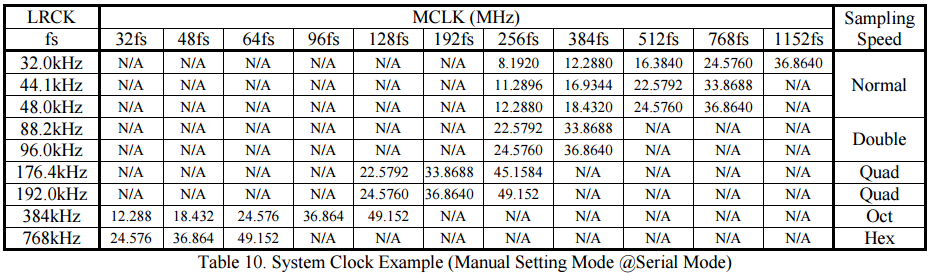

Yesterday I re-soldered the Si570 to the DAC board, set up my Amanero for external MCLK (a.k.a. "slave") and did some tests. Everything seems to be working fine. 🙂
The only problem is that due to the Amanero's requirements I have to run the 4490s at 22/24MHz MCLK while I believe that it's preferable to be running them at their highest supported MCLK.
Meanwhile, the 22/24MHz clock has another drawback: It's not fast enough to do reclocking on 352/384K signals (but it might work if we were to invert it). So in any case, very high SRs are a problem.
Acko's reclocker with its 45/49MHz clocks is OK with the higher SRs but the 4490s are essentially overclocked with 44/49MHz MCLK when fed with low SRs (44.1-96KHz).
However, they seem to be working fine (and measure fine) even at these unsupported MCLKs.
So, for the time being I'll be running at 22/24MHz.
