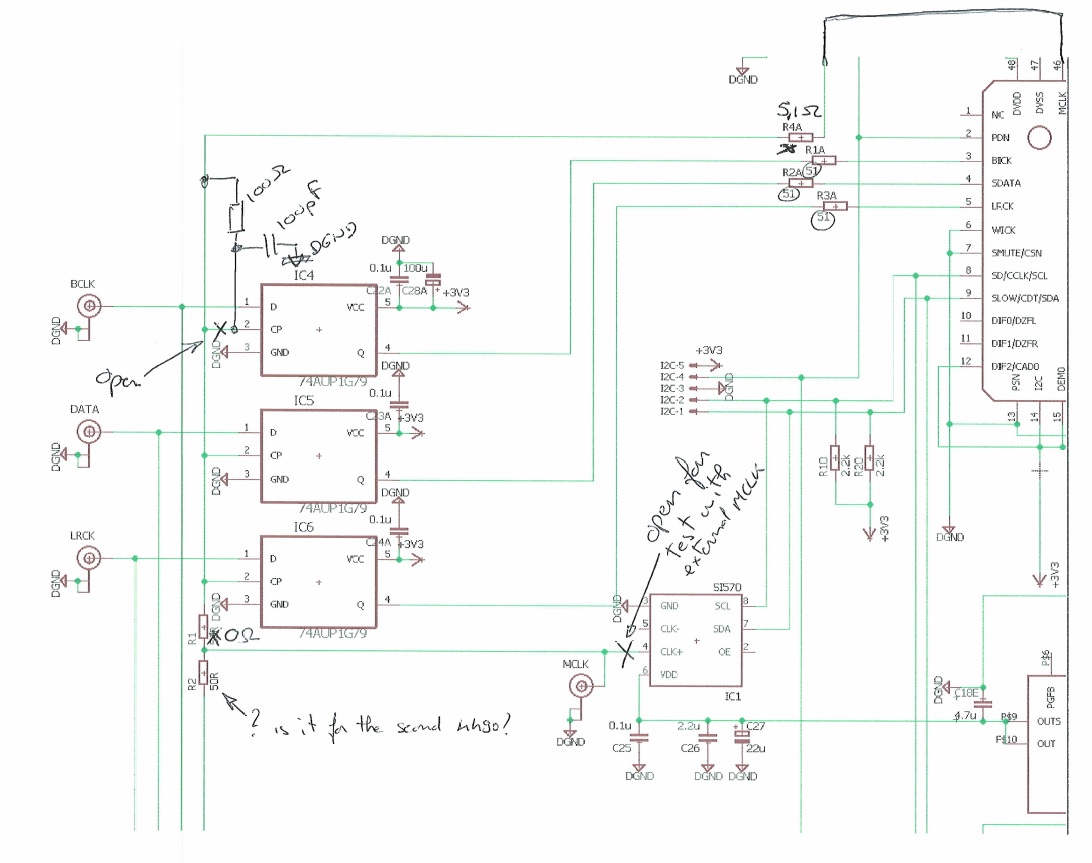

This is not a question a termination, termination issue is for the UFL links, and you right : termination resistors have to be connected to gnd.
The point here is about damping the LC networks formed, at MCLK frequency, by the input cap of the chip (CMOS one) and the pcb layout. This is why we add damping resistors in order to have an RLC with Q factor under control.
My idea was to remove R1 and to have one resistor in serial with MCLK of 4490A and one in serial with MCLK of 4490B (by the way could you post a larger part of the schematic in order to see all the connections of MCLK ?)
About the damping resistor of the 3 D latch : I wouldn't use them, but if you need them it should one in serial per D latch.
About your measurement with the scope : connecting the probe add few pF and may dramatically change the waveform, f0 and Q factor of the LC. The measurement process change the measured value...
Last thing, and I'm not sure this could be another error in AKM documents, on app notes of AK4490 and 4495 the damping resistor of MCLK is 5.1R, not 51R. 51R is for the slower signal : LRCK, BICK and SDATA

Hello Lemon,
Thanks for feedback.
Just to ensure : is the RC network is on the clock of the D latch, not on the D input ?
About damping resistor, please read post#22, akm appnotes use 5.1R for MCLK on 4495 and 90

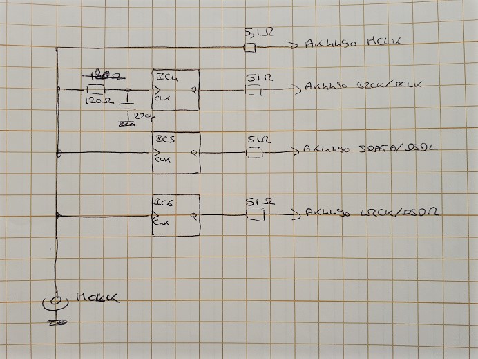

You meant like something this?
The value of mclk terminations resistor was out of my mind...I had forgot it, completely! Thanks.
Hum...., I'm lost ! 😕, what's that schematic ? your reclocker (external ) board ?

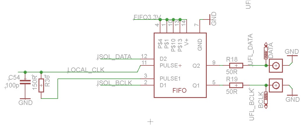

If we do not consider UFL termination for now and only focus on the damping resistors (the 51 and 5.1R ones) and on the BICK delay, what I had in mind is drawn on the schematic attached

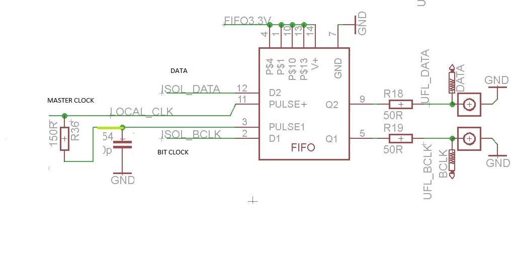

I have applied a different but almost identical solution (I have describe it in post2) for our tests.
This is from a Potato 74AUC1G74 chips d-type flip-flops and works like 74AUP1G79.
The RC network is on the pulse (from the local clocks), and feeds the pin 3 of this FIFO, this is correlated with the D1/Q1 (input bclk/output bclk).
From what I see from you schema, I have applied the same RC on 74AUC1G74.
If I understand yout schematic, MCK, BICK and DATA are coming from the left, and output ( to the AK4490) is on the right. If this is correct, in order to introduce a delay in BICK reclocking, the schematic must looks like this one
Chris, yes you have right.
Now, I see that applied not RC but CR!
