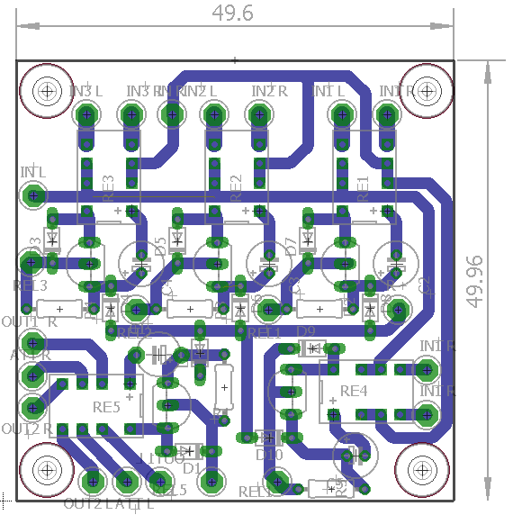

Here we are, here's a version of the latest firmware but including the following changes:
- Modified to support both 2004 and 1602 LCD display sizes by updating LCDCOLUMNS and LCDROWS constant values (3 x 2 font credited to digimike, Arduino forum user)
- Added constants for cursor character and LCD address
- Added support for IR remote repeat code '4' as seen on some clone remotes
The main reason for the change has been to enable support for 1602 LCD displays due to the difficulty had in sourcing suitable cases for 2004 LCDs. Cases that support 1602 LCDs are available from multiple sources.
Chris

Hm, my usb port from nano board disconnects from PC when IR is connected. I am using TSOP34438, and it's correctly connected to controller PCB. Is anyone else experiencing this?
It was the pinout after all. The bom lists TSOP344xx but the link leads to TSOP324XXX. I bought from the link and I thought I had 344 which has reversed power pins.
