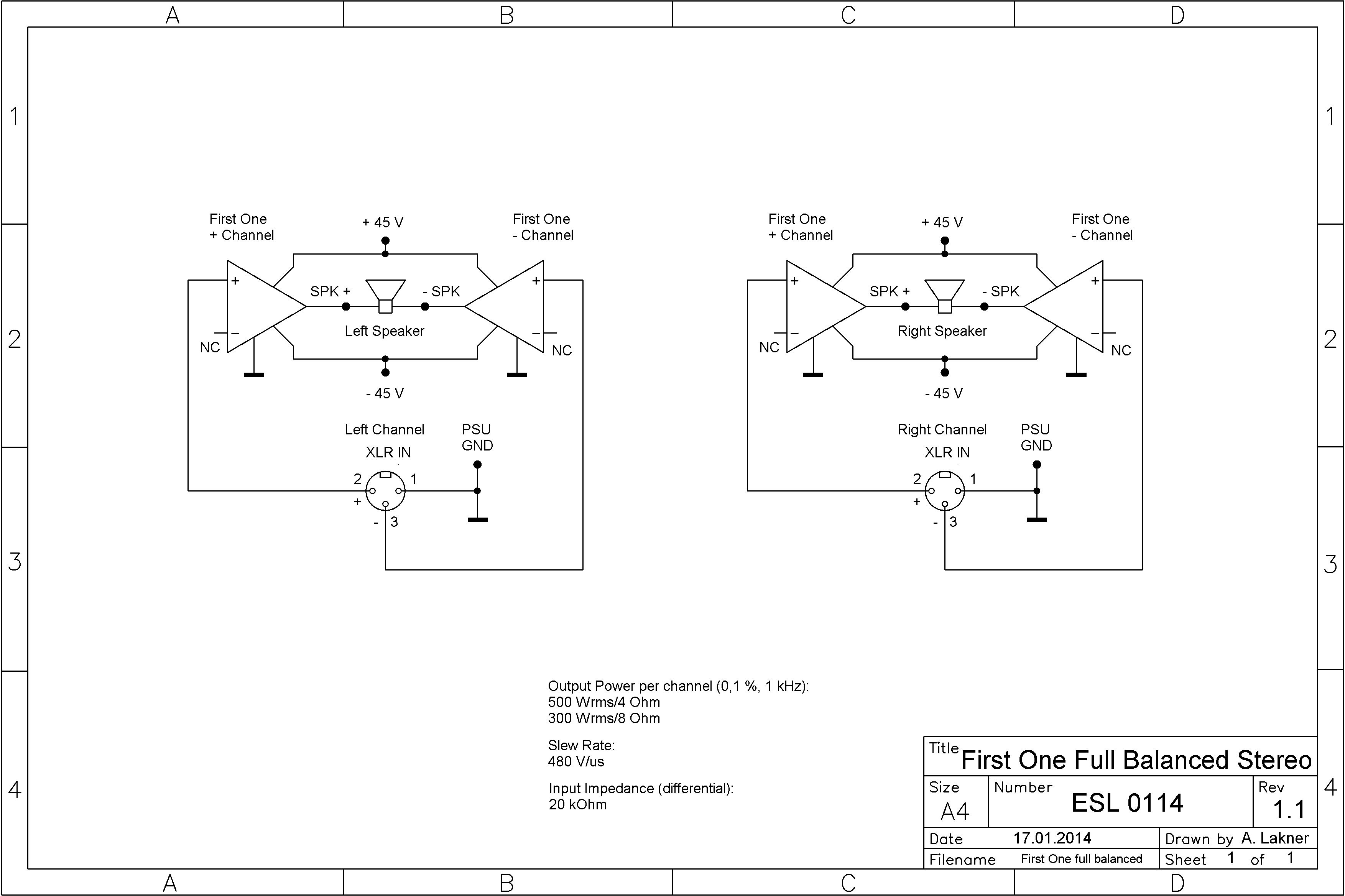

Can we use 2 boards for balanced volume control ?
One board per channel.
Hello Theodosis,
I have never tried, but I think it would be possible to use one board per balanced channel, wired as a balanced series attenuator, having one rotary encoder and one IR receiver wired to both boards... But there may possibly be balance control problems, like when one board changes to another volume level and the other one doesn't, so there should be a way to also control each channel volume separately...
How do you propose to maintain the balance of impedance between the hot and cold signals?
That's why I am asking.
I measured the attenuation on both channels of my Vincent's LDR and found the following variations.
Are they acceptable for balanced use?

Thank you Vincent.
I plan to use 2 encoders and 2 IR receivers side by side.
Do you think I will have channel synchronization problems ?
I'll use two amplifier modules in full balanced configuration.
First One has voltage gain in very tight tolerances, so doesn't need to be extra matched.
If you want to bridge your power amplifiers then first check they are capable of driving half load impedances safely and/or well.
Then build a 2phase circuit to drive the two amplifiers out of phase.
That is very different from using a balanced impedance connection.
My CD player has XLR output, so I guess I don't need extra circuit for phase conversion.
Can I use just a balanced potensiometer made from LDR to control the volume ?
