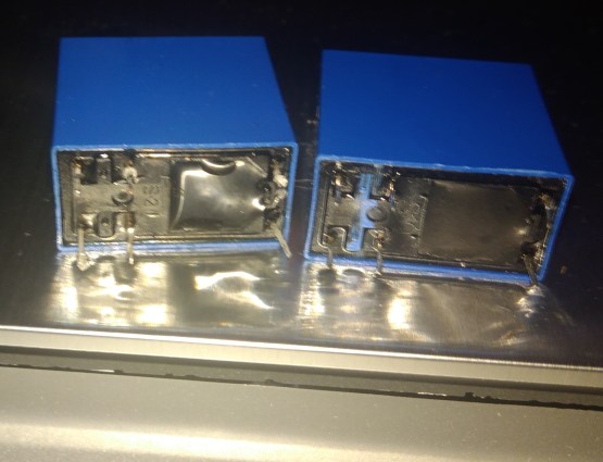

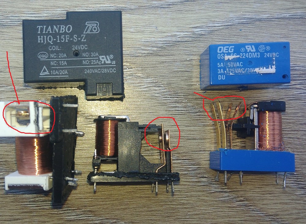

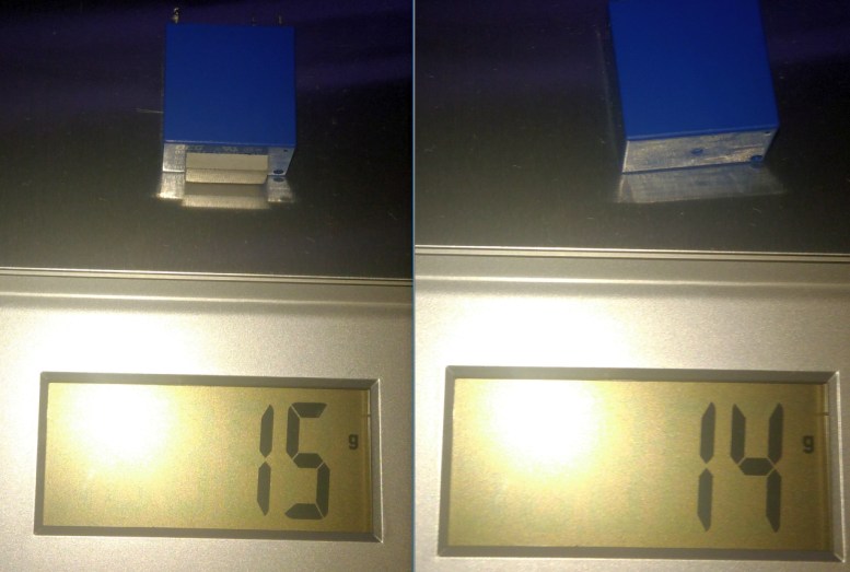

I bought new relays. the difference from the old relays in the photo. and the mass of new relays is 1 gram lighter ! installed. I didn't notice any difference in the sound.

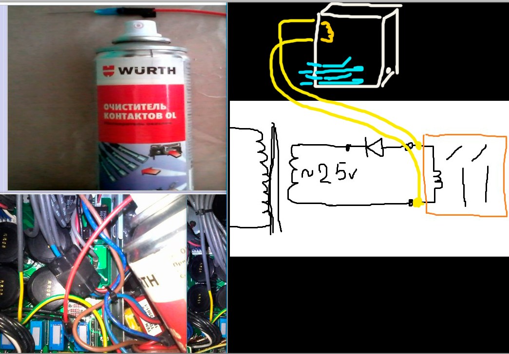

I repeat my method of restoring any relays.
Liquid German -wurth contact cleaneris needed .
We solder the relay. we make a hole in the relay. through the needle, we inject the liquid into the relay.
We include the relay in such a scheme. Several times a minute.
It is important that the position of the relay is as in the picture, so that the moving contacts are in the liquid!
This will completely restore the relay contacts for at least a year

Have you ever dismantled the relays to see what physical damage there is? Nowadays, the relays are sealed and filled with an inert gas, evidenced by a one-piece plastic case with a thermosetting resin compound poured around the connecting leads - as your pic at #41 shows. Copies of old style speaker relays with removable, clear plastic covers are available to the DIY market but audio manufacturers ceased using them 20 years ago.
If you puncture the casing of a sealed relay and allow air to enter, the relay life will be shortened if it isn't already but owners probably wouldn't notice any immediate problem. You have to ask yourself though; what caused the contacts to stop working? Sealing means there should be little or no chance of contamination so is it arcing residue? If so, there will be arcing damage or pitting of the contacts. That's a more serious problem and the relay should be replaced regardless of what has been achieved in a temporary fix. Of course, you won't be able to visually inspect this damage until the relays are opened up but the solution should be self-evident.
I've seen many unsealed speaker relays from the old days; all of them giving some degree of trouble but most could be restored with careful burnishing of the contacts with a small strip of card (thick paper). Done properly, this could restore relays like Omron's quality products, for a further number of years use but we can't be certain if we don't keep detailed records or see the unit again.

Have you ever dismantled the relays to see what physical damage there is?....
I'll photograph the old relays tomorrow.
my relay recovery method (german liquid Wurth) described for cases when it is not possible to buy new ones. And my method helps.
Regarding the Gas/tightness in the relay - I described earlier the USSR relay with gold contacts that work outdoors for 50 years. The main thing in the relay is the quality of the contacts.
That is why sometimes it is better to repair an old relay than to buy a Chinese one, which (as I showed above) is why about 1 gram lighter than the original one.

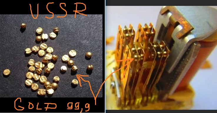

In the USSR there were interesting relays -
8Э14 (6A 27V)) the relay on the contacts is 3 grams of silver. No sealing and even more so. inert gas inside.
these relays work to this day without problems. Probably there is silver of the highest grade (99,99), as in the batteries of submarines.

For such expensive Arcam equipment (price in 2010 AVR600 = 4000$ !!!) it would be ideal to use a relay with gold contacts (as in the USSR) and then no neutral gas is needed at all for OMRON penny relays.
in the photo, radio components of the USSR - gold 99.9
here are the contacts you need to put in high-quality equipment

3 grams of gold in a relay would make it costly, so would silver.
Ordinary consumer grade audio or auto relays would have contacts made of mostly a hard copper alloy, with Tungsten, Beryllium, Cadmium, and Silver as possible additives.
even if 3 grams of gold x 4 relays = 12 grams, which is $500 in prices. But at the price of an amplifier of $ 5000 , gold will be unnoticeable ! I'm not saying that you need to put 3 grams of gold in each relay, I'm talking about the fact that when selling products worth thousands of dollars, it makes sense to put high-quality radio components in important nodes if they cost this + 10% of the total price.

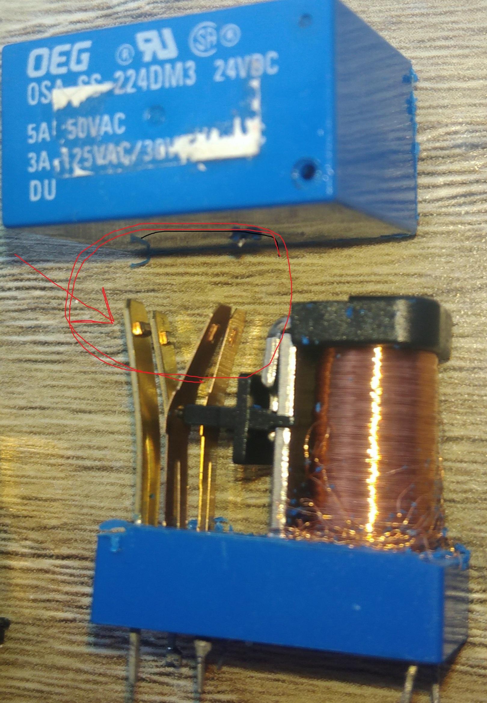

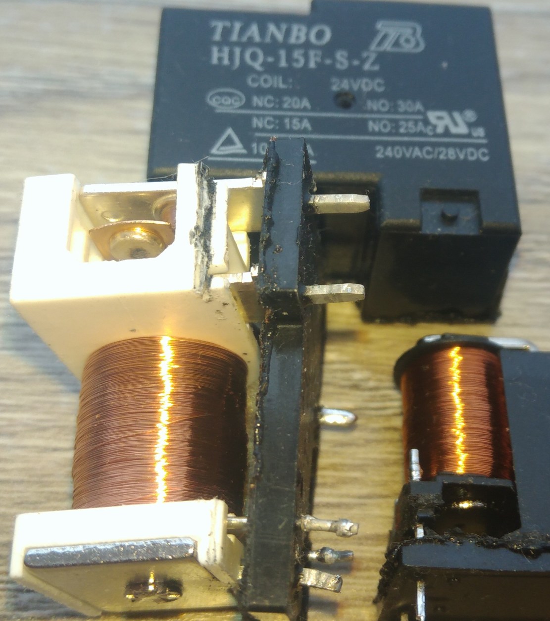

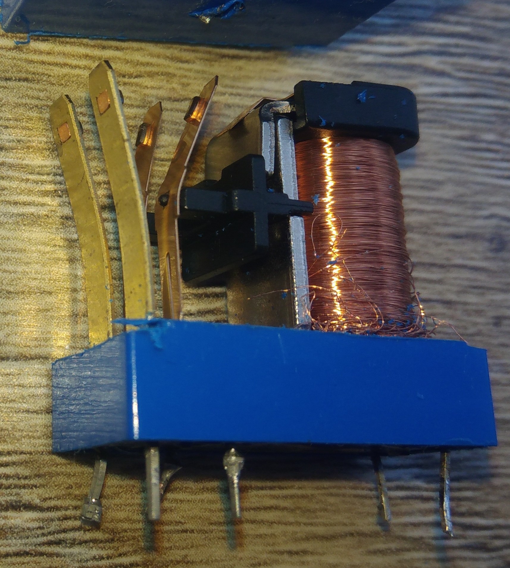

here are photos of the relays that are used in Arcam 2xx-3xx .
Black is the power relay, blue is the sound In black shows a large contact. And I note that it has turned black.
And in the blue relays , the contact is very small ! And you can also see that they have turned black.
Now think about why such weak relays are put into the sound circuit of the device at a price of thousands of dollars.
I can't say about the need for a budget amplifier of 12 grams of gold, but if I were a developer, I would give up blue relays in favor of black ones.

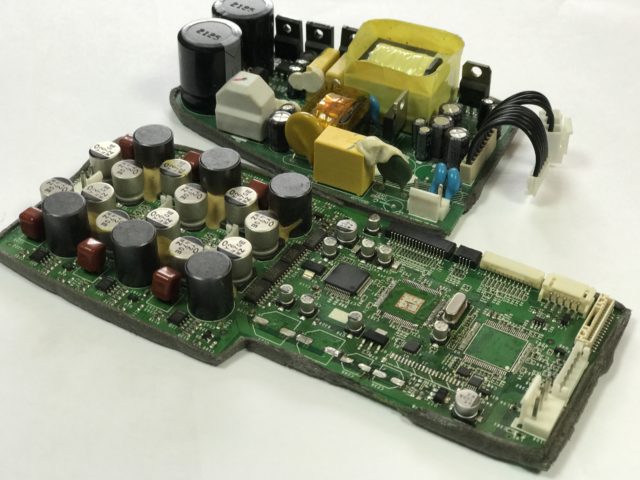

the very quality of the manufactured equipment also suffers. For example, take a scandal with the same (not cheap!) with a B&W Zeppelin Air column (the power supply always breaks, repair is impossible. board replacement only)

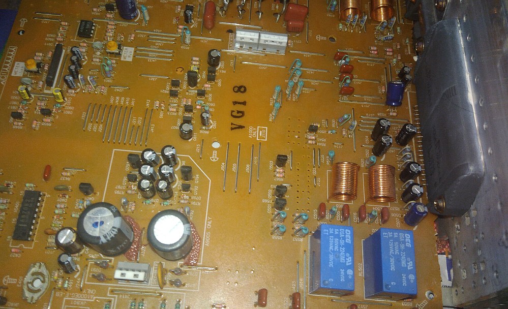

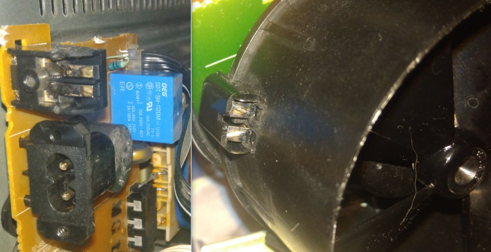

hello everyone.

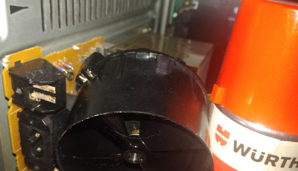

brought for repair - Technics SE-A900S
1. an interesting point - the relays are exactly the same as in the Arcam 300
2. if the fan is not spinning, then check and clean the contacts. they are oxidized.
