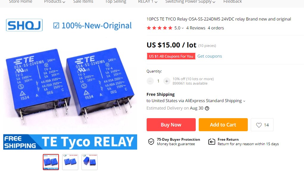

2. 500 Rupees = 10$ ? Then I advise you to spend this money on the Chinese relays 10PCS TE TYCO Relay OSA-SS-224DM5 24VDC

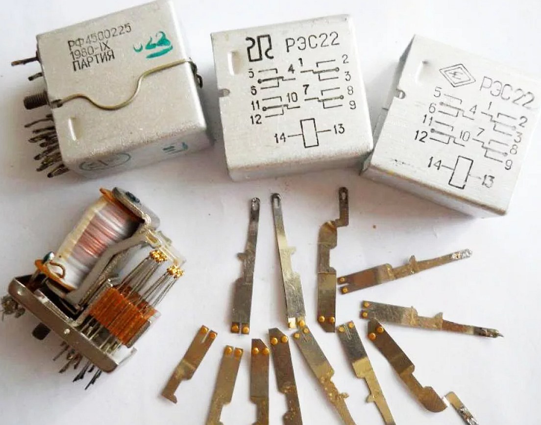

I know a relay made in the USSR on the contacts of which there is real gold 999,9. palladium. platinum.
(In the photo, the Soviet relay contains 0.5 grams of 999 gold on the contacts !!!!!!!!!!!!!!!!!! ) I am sure that such relays do not spoil the sound. Unfortunately, they very rarely fit the scheme.
And I'm not sure about the relays from China even if they look 1 to 1 with the native ones. Therefore, I am a supporter of restoring the NATIVE relay.

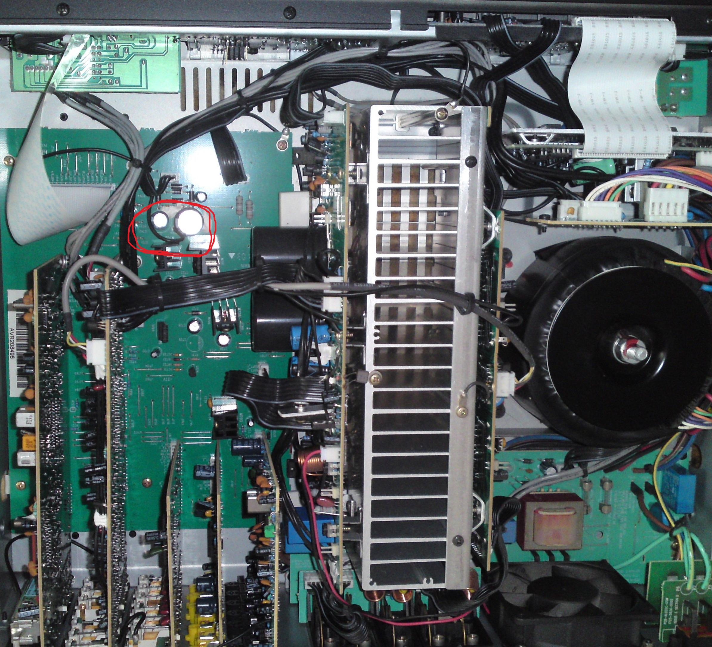

I was surprised that the capacitor swelled up. only 10 volts (the actual voltage is even less)! There is no heating next to it.
I repeat that the products of the company Arcam are very expensive. The power supply unit in the receiver is traditional, not pulsed
yes, for 3 years now, all my computers (3xx chip) are MSI. The work of MSI satisfies completely. But I note that today solid-state capacitors are used in boards. Old electrolytic capacitors swell from heating, and the capacitor is heated either by high-frequency currents in the electrical circuit (which, together with a bad ESR (this is the capacitor's own internal resistance), heat up the capacitor), or by accompanying heating from nearby parts. But not all capacitors swell. By the way, I note that solid-state capacitors are also capable of exploding.

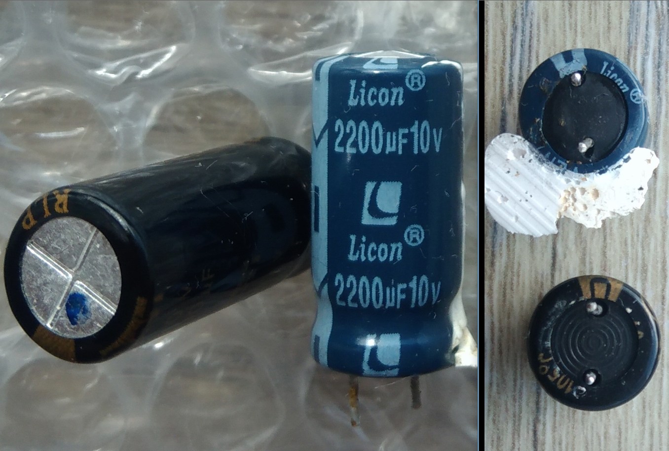

on the left is a capacitor from the Asus board, on the right is a capacitor from Arcam. the photo shows that the quality of Arcam is mediocre. Both were made in 2004-2005 years
Wow, things have gone really downhill then. Samwha capacitors are not bad at all, and Arcam used to use those and Rubycon before they were bought by Harman. The products used to be well made on site in England as well.

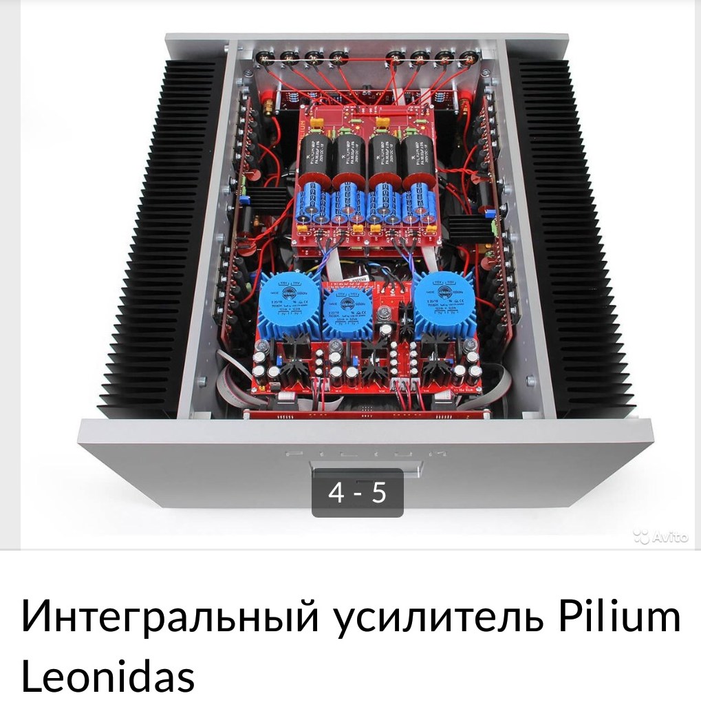

Samwha capacitors were installed 20 years ago and in Meridian products. However,, it seems ridiculous to me to buy a receiver for $ 5000 with capacitors for$ 1 / I prefer high-quality products and the price is slightly more expensive than $ 1 per piece - for example, vishay/ I will especially note that high-quality capacitors affect the sound quality.
the photo shows a quite decent amplifier, vishay capacitors are visible in the photo
why am I a simple person who can buy normal vishay capacitors, and the corporation installs junk 10 times cheaper. but he sells products worth thousands of dollars ??
