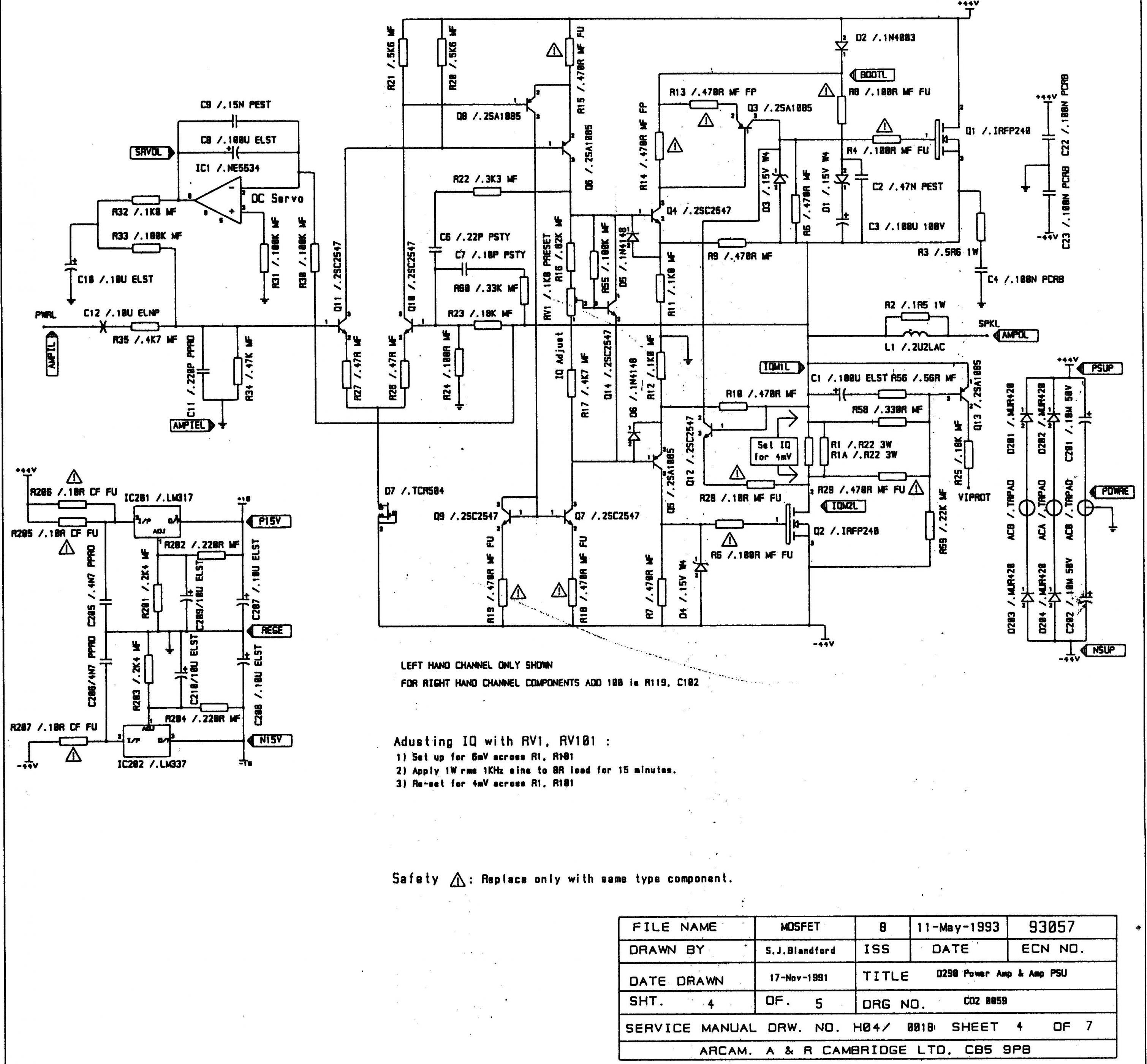

Arcam Delta 290P keeps blowing fuse
1st picture. Do a quick resistance check (and/or use the diode range on meter) to see if any of the four large BYW diodes reads short.
Beyond that and you must rig up a bulb tester which will allow working on the equipment when its powered and without it blowing fuses. And most important of all... for remote help we need to see the correct circuit diagram.
Circuit diagram pdf/jpg

Hi Mooly.
Thanks again. I checked here;- Mastech M-830B Diode Test to make sure I was using my meter correctly.
Bear in mind I am measuring these 'in situ'. From top to bottom, the measurement on the meter was 001, 000, 001, 000.
This measured the same with the positive on the cathode and same readings in other direction.
The meter uses a test voltage of 3 V, and a test current of 0.8 mA for this measurement.

Your link says, the meter will show 001 indicating infinite resistance in the blocking direction and then when the probes are reversed it will read a three digit number to indicate the forward voltage across the diode.
If that is the case then 001 followed by 000 does not match their guidance.

You only need to pull one leg of each diode to be able to measure it in isolation.
Build up that Mains Bulb Tester (MBT) and power ON.
You will see the 40W bulb switch on to fairly bright. Remember the amp is now LIVE - be careful.
The voltage on the primary will probably be around 5Vac to 10Vac.
The diodes in the bridge should all show some low voltage. The smoothing capacitors should also show a low voltage, maybe as little as 2Vdc.
Power ON via the MBT and measure.
The fuse will not pop with a 40, 60 or 100 watt mains filament bulb in series with the supply.
Those diode readings look a little suspect, even for in circuit. 000 and 001 seem to show an almost dead short irrespective of whether the meter is on low ohms or diode range.
The bulb goes in series with the live mains feed to the amp.
If the amp has a problem and draws excess current then the bulb can not support that and so the current lights the bulb... all non destructive. If the amp is OK then the bulb can just about manage and the amp will run and the bulb is out.
The reason it works so well is that bulb filament resistance is very non linear with regard to temperature (caused by the current draw).
Check those diodes first though. Reading in circuit can only show catastrophic failure and shorts, but readings of 000 and 001 (for low ohms range and diode range) are certainly that. So make sure.
