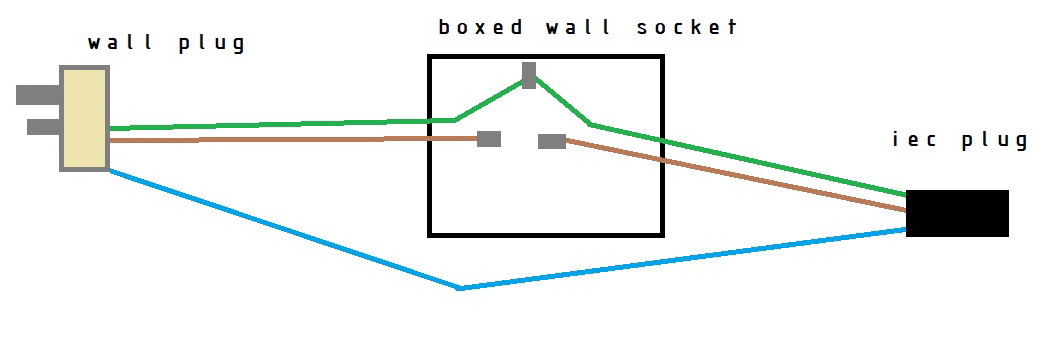

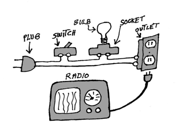

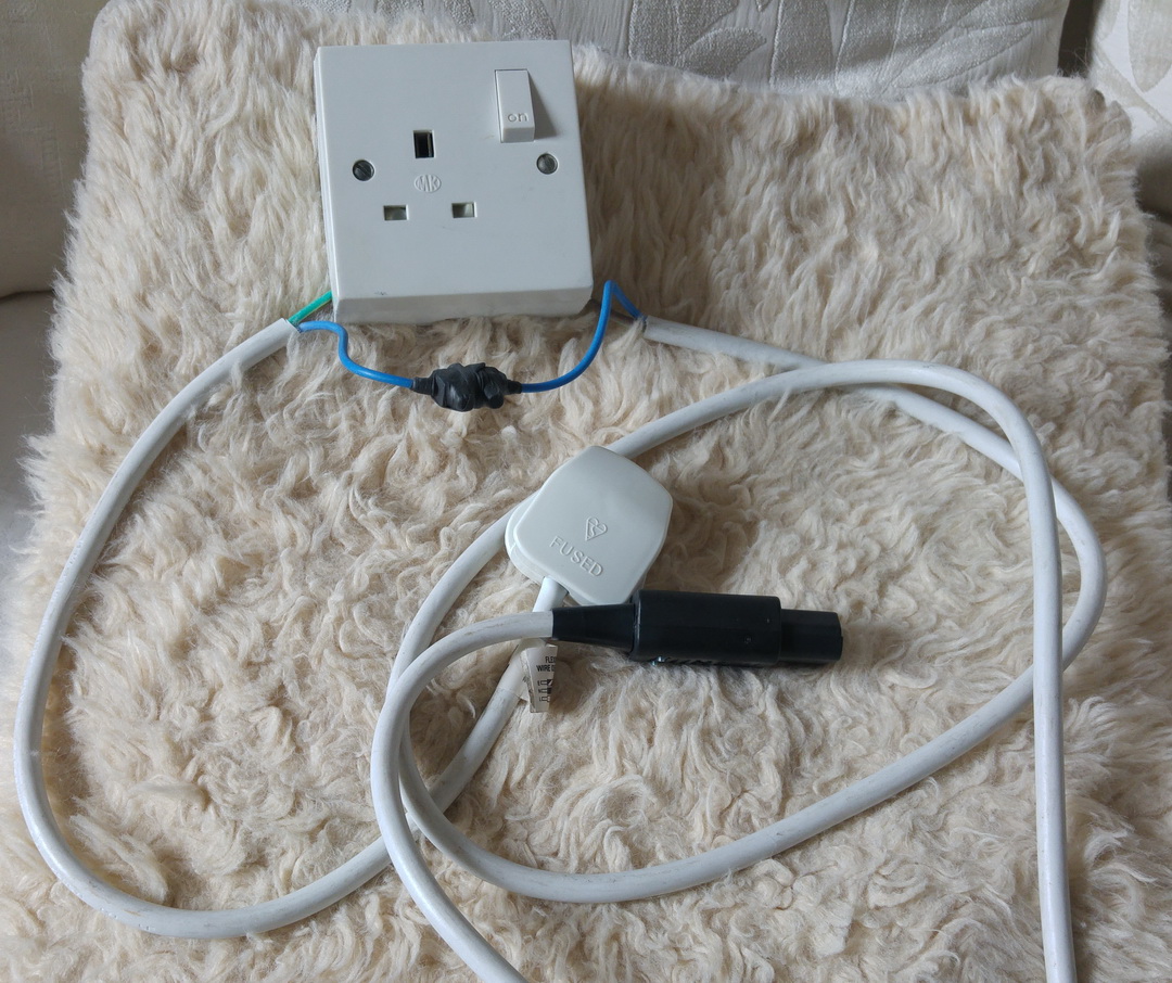

The blue spark only happened once, but it was certainly odd. Has not done that since. But I must make up a bulb test rig.
Although the only old filament bulb I have is a 10 watter!
the mains Halogen bulbs are also tungsten filament and make a good substitute.The blue spark only happened once, but it was certainly odd. Has not done that since. But I must make up a bulb test rig.
I have seen them in 28W and 42W sizes.
Lol, my bulb tester looks a a lot scarier than that 😀

The table lamp would put the bulb across L and N in the socket and thus in series with the supply, so yes
Thanks, it seemed simple but good to get approval! Just watching Grand Prix now. I will then start some testing.

OK, first of all, the bulb comes on brighter then dulls down and remains dull, is that OK. Only using a 10 watter.

That sounds OK... to good really for just a 10 watt bulb... however !
First thing is to check the supplies and see they are correct. The -/+44 and -/+15. They may be low with using a bulb, although on the other hand, if they were low then current would be being drawn and the bulb would light.
It is a mains filament type bulb ? and not an energy saver type. It must be a tungsten filament type.
Yep you need to use a bulb with a real filament in it. A CFL or a LED lamp will not work! I have some old 60W and 100W incandescent bulbs i guard jealously for this purpose 😉
OK, yeah 10W is a bit too low. 60W is better. 100W will be OK.
You should get a brief flash as the power supply capacitors charge, and maybe a dim glow if the unit is operating normally. If the bulb gets bright, something is drawing significant current - at idle, the amp should not do that.
