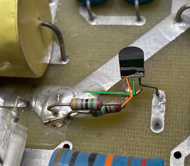

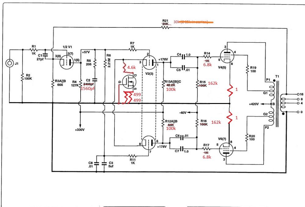

Basically, I'm working on this old arc vt60. When they first released the amp, the driver pair was biased using resistors, as you'd expect. About 2 years later, arc released a "sonic improvement" kit, that I guess you could order and modify the amp yourself. I've marked on the schematic what parts have changed, and although arc never comes out and says it (they color over the fets so you can't read the number) I was able to scrape enough of it off to figure out it's a 2535 mosfet.

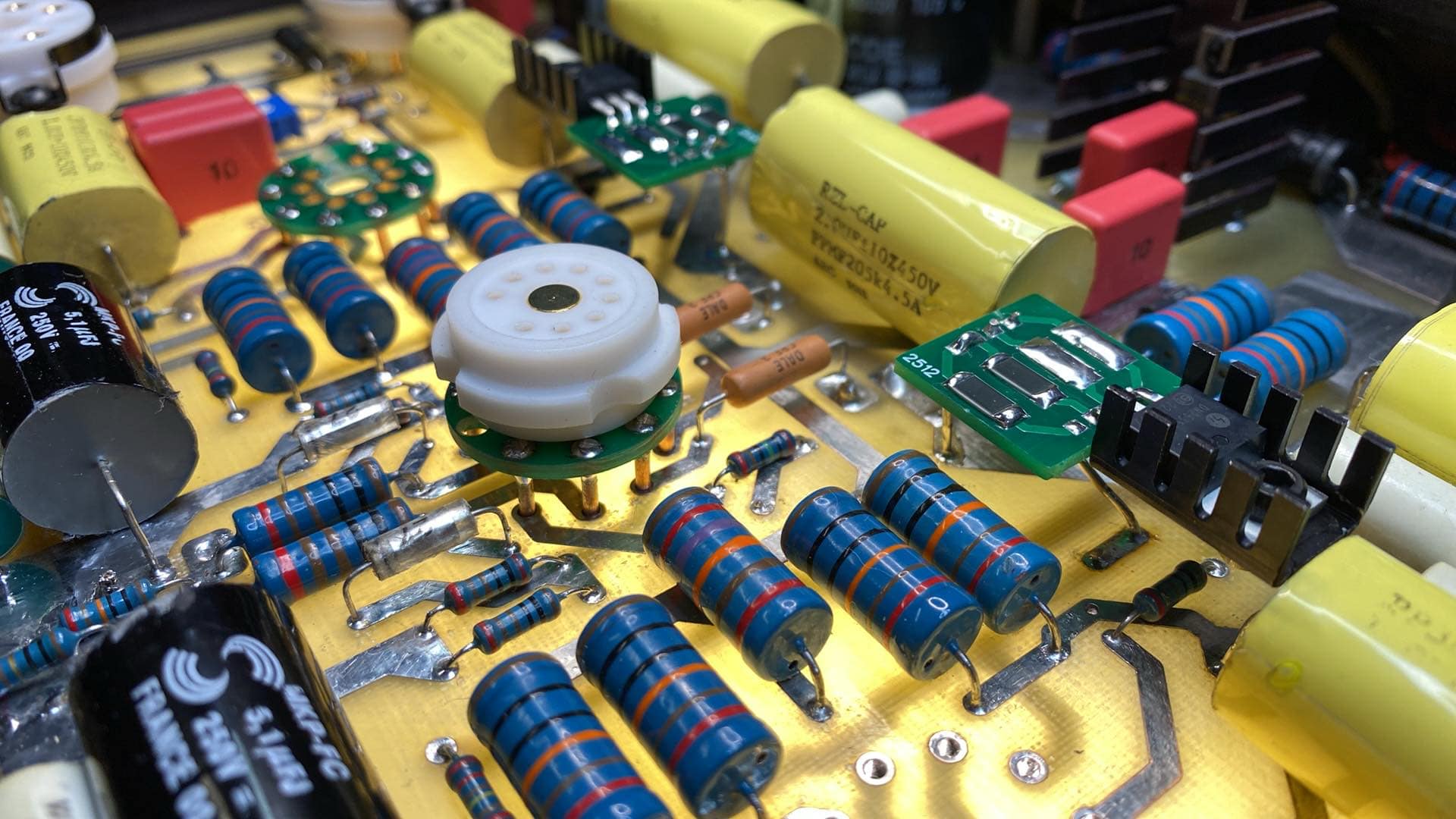

The issue is, the instructions had the person solder it dead bug style, and it's just kinda ugly and gross, so I've been trying to figure out a better way to do it. I got a few extra 2535 mosfets in both to-92 and to-220 packages, just to experiment with various ways of mounting and wiring. Right now, it's on a small board that was meant to be a 2512 size breakout board along with the set resistors, arc wanted 2 499r in parallel.
It hasn't been powered up yet because I'm still fussing with fixing solder and making a few changes, but over the last couple of days, since I've been reading more and more about ccs implementation, I'm becoming increasingly paranoid that the increase in lead lengths and using the boards like I have are going to make it behave poorly or oscillate, so I've been trying to come up with alternate ideas. One idea which I half jokingly thought to myself...I bet there's enough room on the board to solder the fet right down, the 220 package 2535 has the drain on the case, and the spot on the board where it goes...well, it just might fit.
The pictures are how it was done by whomever modded it originally in the 90s with arc's instructions, and the second one shows the board I was going to use that I'm having second thoughts about. Ignore the blue circles on the schema, I'm still messing with it, I'll probably make a final one with kicad later.
Edit: Attached a version of the schema that has more corrections on it.

The first picture is how I would have likely done it. Looks good. The board option looks neat as well. Give it a go. Valves can sustain quite some abuse before giving up the ghost (save output trannies). However, I think you will be OK with your css boards.

8mA is way too high a guess. Consider the valves' anode resistors and the voltage drop across them. 330V - 178V = 152 VDC / 100K Ohms, x2 = 3.04mA. 8mA would probably be a better number, but anode loads would need to be adjusted.
