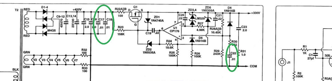

The last question I had, if anyone wants to chime in, was about the 0.01uf bypass capacitors, which honestly, I don't even really care about enough to keep the thread open.
I'm just gonna put some vishay 0.01uf 1000v caps in there instead and call it good.
I'm not a fan of bypass caps and they can change the sound of the amp, not always for the better. I'd try the amp without them first, if it sounds good just leave them out.
Hey Stephe, love your youtube channel 🙂 I comment sometimes, love watching you build amps.
I've never been a huge believer in capacitor sonics, though I do like things that are well made and good quality, so I usually don't mind spending a few dollars on decent caps. I've been considering getting a couple of Jantzen z caps for the interstage couplers.
As far as the bypass caps, I probably will pull most of them, at least the ones in the audio areas. There's a couple in the power supply sections in positions that I probably won't mess with unless they read funny. (pic)

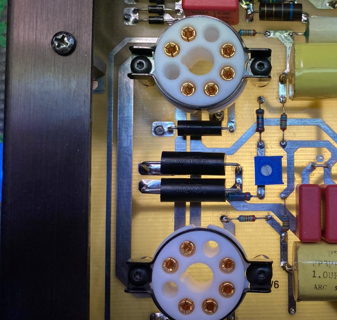

In a push pull output stage that shares a current lol resistor, I.E both tube cathodes are together, and then share a 0.5 ohm resistor to ground (A) there's no issue with changing it to 2 resistors (B) so the current can be seen individually?
That's not going to make it upset, right? If the cathodes aren't directly connected to each other anymore?
It will work, but Dyna said there is some distortion deduction with the common connection that shares a resistor.
Reactions: DrDyna
If I'm being honest, half of the reason I've started getting into tube amps is I like a bit of distortion, so as long as it's not terrible, I'm good with it. 1-2% is probably fine for me.
This amp will eventually get individual bias adjustments for the outputs at the very least. I'm having a great deal of fun tinkering with it and using it as a learning platform, so it might end up with qi boards or arduino management..who knows.

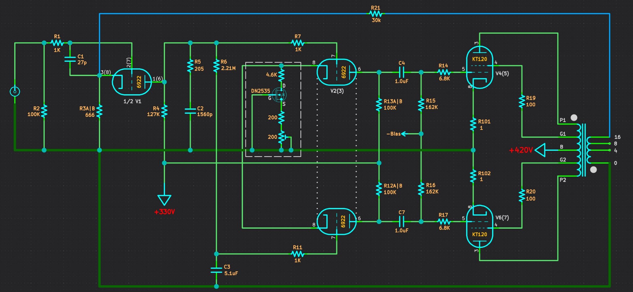

Got the audio section moved over into kicad so I don't have to keep scribbling on an mspaint scan.
Anyone spot any sources of fire? This is most likely going to be the first fire-up state.

How critical is C2? This is currently a pair of polystyrene capacitors, 1000pF and 560pF. It would be convenient for it to be a single capacitor.
I should be able to put a 1600pF in there, right?
