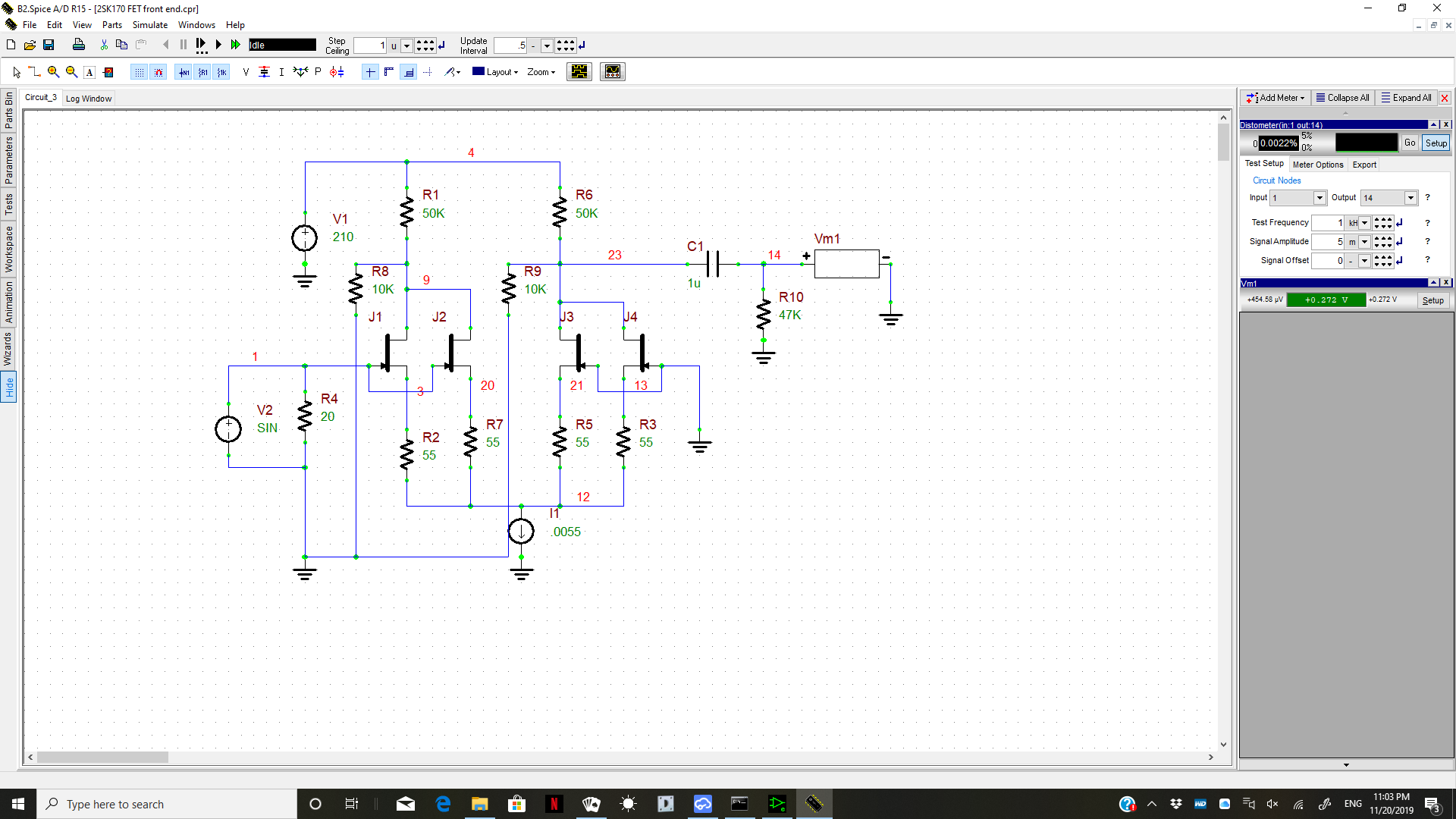

I ran through B2 Spice as well, specs look nice for the 2SK170 JFET.
THD is 0.002% for a 5mV Input, output is 27mV p-p
Output noise at 20K measured 70nV/sq.rt.Hz.

Just so I understand, 4 matched 2SK170BL for the difamp and one for the CCS?

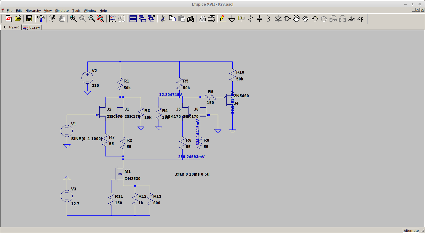

Hi All,
It's been a little while since we talked. If I wanted to add passive RIAA to this design, where should I add it? I'm thinking after Q5? Am I correct that there is a RIAA filter already there...just not the complete network? The second network (bass?) is the feedback loop...which I want to remove. I plan to use something like the passive RIAA network from the PASS or Salas designs.
The Salas folded Simplistic and the Pass Pearl (1 & 2) have it between the input stage and second stage? Not that I need to copy them, just a question. I could put the second filter after the tube stage. Trying to remove the feedback...but maybe I should just trust ARC.

I don't think I can make comment without simulation. Just to say I find if you want the lowest distortion as with an op-amp have lots of gain and apply negative feedback. The circuit does look like an op-amp.
