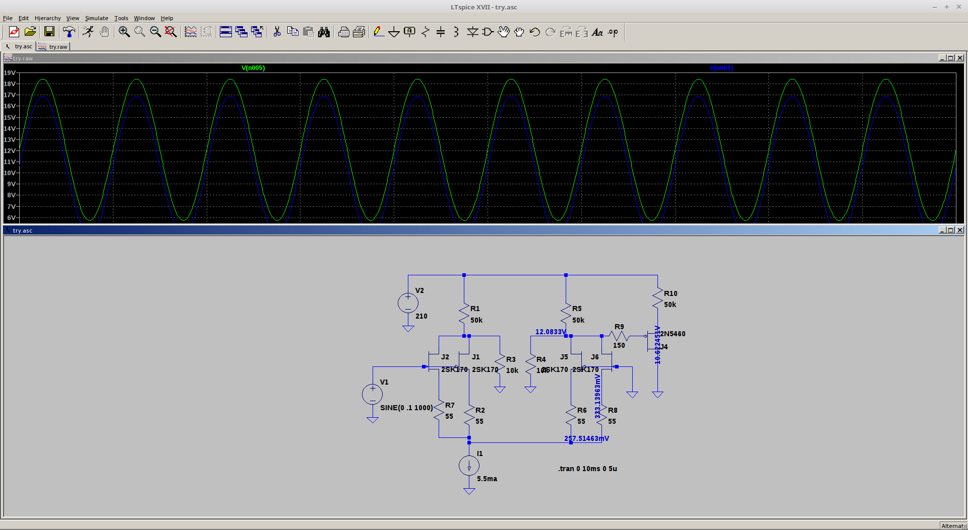

Just so I understand, 4 matched 2SK170BL for the difamp and one for the CCS?

The CCS is a mosfet not jfet - so you will something else for that. LT spice is free and free to download. You will need a spice model for 2SK170 - diy audio!

LTSpice is a free download, but you will have to acquire Most tube models, and a majority of discrete SS components yourself.
B2 Spice is a John Broskie product, that was put together several years ago, I got in on the ground floor, before the price was marked up. It will run close to $600.00, but it is loaded 1000’s of components, including ALL the popular tubes, OPT’s are another story, I haven’t been able to get any OPT model to work properly. I’ve asked for technical help but didn’t get very far.
But so far as accuracy, it’s been at least 90%. Which saves a lot of breadboarding, I’ve designed phono stages that have been better than 95% accurate with B2 Spice.

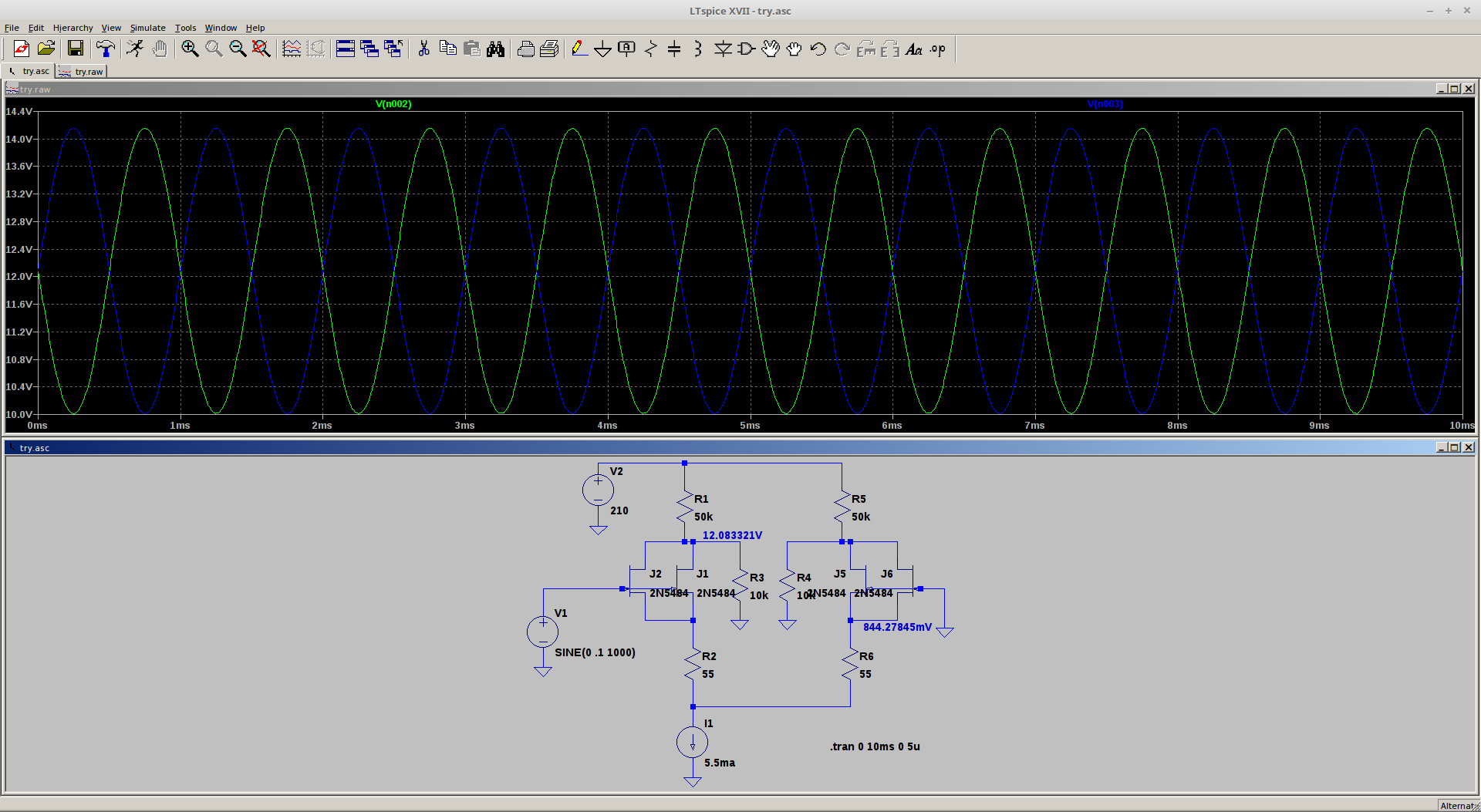

I downloaded LT Spice. Is there a "spice for dummy's"?

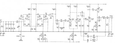

It's been a little while since we talked. If I wanted to add passive RIAA to this design, where should I add it? I'm thinking after Q5? Am I correct that there is a RIAA filter already there...just not the complete network? The second network (bass?) is the feedback loop...which I want to remove. I plan to use something like the passive RIAA network from the PASS or Salas designs.
If you put it all there I think you will affect the noise performance. As the feedback will reduce both the signal and the noise at HF. If its all in one place you may struggle.
The Salas folded Simplistic and the Pass Pearl (1 & 2) have it between the input stage and second stage? Not that I need to copy them, just a question. I could put the second filter after the tube stage. Trying to remove the feedback...but maybe I should just trust ARC.

I don't think I can make comment without simulation. Just to say I find if you want the lowest distortion as with an op-amp have lots of gain and apply negative feedback. The circuit does look like an op-amp.

I have it on good authority that Audio Research used the Toshiba 2SK117 in many of their front ends. Selected and matched, no doubt. This JFET looks like a "detuned" 2SK170. It is probably also hard to find now:
