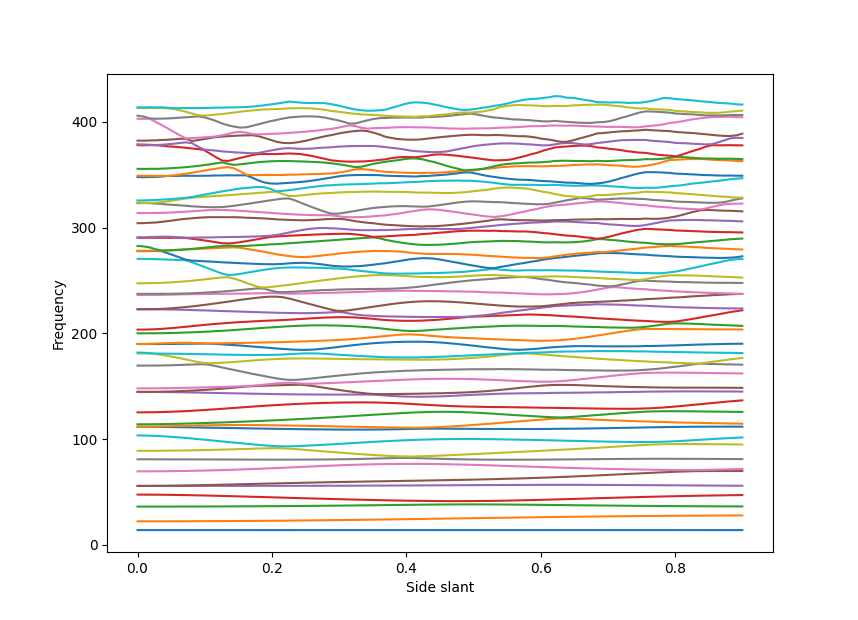

This is an interesting graph, and seems to show what I had hoped to see.
It shows graphs of the first 50 eigenfrequencies vs slant.
I don't have access to m,n mode indices as with the exact solution, so I cannot trace the evolution of individual modes as before. Mode indices would lose their significance anyhow when moving away from rectangular geometry, I guess. Anyhow, you need to trace the curves by eye.
What is interesting is that in many cases, the apparent curves which are head toward a crossing point, actually do NOT cross, they diverge again.
I'm not saying this is a chaotic billiard (I don't think it could be with only straight edges), but this is the sort of thing I had hoped to show occurring as I introduce asymmetry. In the chaotic billiard literature, they talk about eigenmodes 'repelling', and this seems to be similar.
The horizontal resolution is only 100, so in some cases it may be an illusion, but certainly its a real effect...
I'd like to get a better graph but its not so easy to produce. I'd have to produce all the data, then scan back and forth doing linear extrapolation to assign data to a 'mode' line. I'm also having some issues with the solver failing at certain particular shapes. But if you run the mesh again and solve, it doesn't fail. So there must be some indeterminacy in the meshing and/or solving, plus a bug (in the solver I guess).

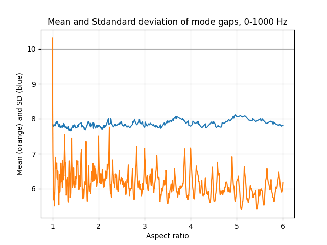

Comparison of the formula method vs fem method for mode stats vs aspect ratio. Resolution is 1000 points across in each case.
Blue is mean, orange is SD in each case. Agreement is not perfect, but the peaks at 2, 3, 4 are present. Sharpness of the peaks is less overall for FEM, and also gets less as the frequency increases.
Note the formula method graph is not identical to the one I posted before. At first I found the average and SD did not agree, and on closer inspection turns out I was using area=0.6 m^2 previously.

Very cool Paul.
I think you are right about the mode indicies losing their significance. But I also think that your mode "lines" really do cross. When I look at your data I see some "smiley" face curves (highlighted below) that I suspect represent the true lines for particular modes. Probably if your resolution was higher you would see it more clearly. Recall how the "aspect ratio" graphs looked where there where clear "families" of curves where each "family" had a particular character and crossed over other families? I think it's realisitc to suspect that this graph would look similar in character to that if each line in the graph represented a particular mode.
Nice work.

Paul,Comparison of the formula method vs fem method for mode stats vs aspect ratio. Resolution is 1000 points across in each case.
Is your model based on the Kirchhoff plate (no shear deformation) or Mindlin or other? I think the "exact" solution for the simply supported plate actually only applies to the Kirchoff plate. I'm not certain of that but I think so.
My LISA model is based on the Kirchhoff plate.
I suspect that for a real plate, even if it is isotropic, the sharpness of the peaks (in the SD line) at integer aspect ratios would smaller than for the "exact" solution. I expect that different modes would be affected differently by shear deformations and rotational inertia, so that modes that "should" be at the same frequency for a (simplified) Kirchhoff plate wouldn't land in the same frequency for real plate, and that the amount of deviation would increase at increasing frequency, as the effects of shear and rotational inertia become more significant.

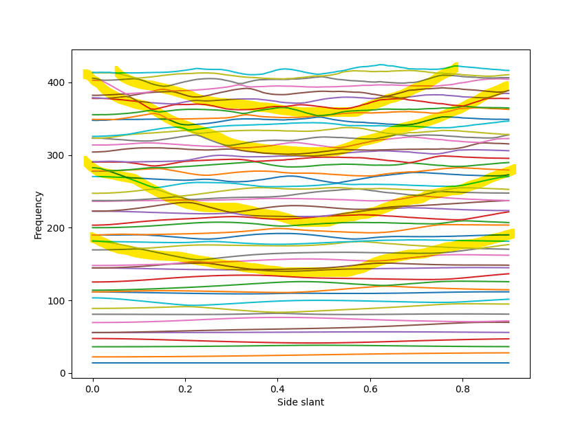

- in #121, by which criteria, the frequencies are linked in the same curve for different slants? My question comes from the fact I known only for now 2 ways to organize the eigenfrequenies from calculation or simulation : by the knowledge of the m, n which are relevant for rectangular plates (in my FDM script I have a short algorithm to retrieve the m,n from the mode shape and make the link with the formula) or by sorting them. None of them seem applied here?
Of course Paul will correct me if I'm wrong, but my assumption for the graph in #121 is that the frequencies are sorted in order (say lowest to highest) and the "nth" line simply links the "nth" highest frequency for each aspect ratio. I think that's what you mean when you wrote "by sorting them". Let's see what Paul says!
That would explain why they never cross, right? But maybe I'm missing something.

Those trends are very clear, and represent the evolution of something, of course, but I don't thing its correct to label them as the 'true' mode lines. While there are no double a few illusions cause by low res, there are also clear cases of modal divergence breaking up the original pattern. You can see each curve approach, then steer away from a point where they might have otherwise crossed.I see some "smiley" face curves (highlighted below) that I suspect represent the true lines for particular modes. Probably if your resolution was higher you would see it more clearly.
There will be patterns for each of these (intermediate) shapes also, because each will have its own characteristic symmetry.I think it's realisitc to suspect that this graph would look similar in character to that if each line in the graph represented a particular mode.
But I think we are also seeing partial 'breakup' of the original patterns with removal of a dominant symmetry and we are seeing remnant patterns in the mode lines.
I may try to do again at higher res, but to make it worthwhile I would need to write a script to extract the actual mode lines. Relatively easy by tracing one line at a time, and that should work reasonably well, but could not guarantee correct assignment globally. Maybe will ask in statistics stack overflow for a technique or existing code.
The takeaway I think is that there is an improvement of the SD of the mode gaps caused by fewer gaps at or near near zero. I don't think there is any way to arrive at this without there being fewer mode line crossings.
