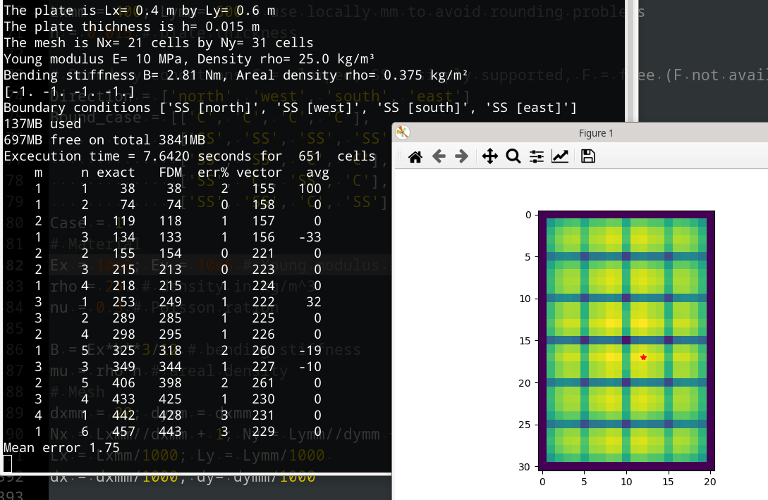

Following your post Eric with M Zenker's paper below a raw result of the FDM script. The case is easy as being a simply supported plate. Not written the mesh is 20mm. The red point is a proposal of driving point based on the idea of the paper (seems some indication are missing...) and for only the odd odd modes (a close position is obtained with all the modes). This remind me old posts saying "off center not too far". Encouraging. Don't be afraid by the execution time shown in the terminal view, my computer is old; much better on my son's one.

Awesome, you are on your way! I don't see a poissons ratio (or Shear Modulus). Doesn't your FDM script require one or the other?

No Poisson's ratio for now as "only" clamped or simply supported conditions for isotropic material are implemented at this step. Next as the script gives encouraging results is free boundary condition which need it. The script is already prepared for orthotropic conditions which also requires it.
So coming next

Christian,
I think your FDM is working very well.
Today I tried comparing my LISA results to the "exact" results for your exact dimensions and properties. Firstly, I realized that probably had never actually compared the two before! Why not I cannot even imagine!
In any event, my LISA model results were very similar to your FDM results, with the model predicting frequencies that were about 0.5% to 2.5% lower than the exact solution. I must admit I expected they would be a little better than that, but regardless I think it's good enough.
My "standard" model is 40x40 elements, 8 nodes each. I tried increasing the number of elements to 60x60, and also tried making the elements more square, but neither approach gave any better results than my original 40x40 model.

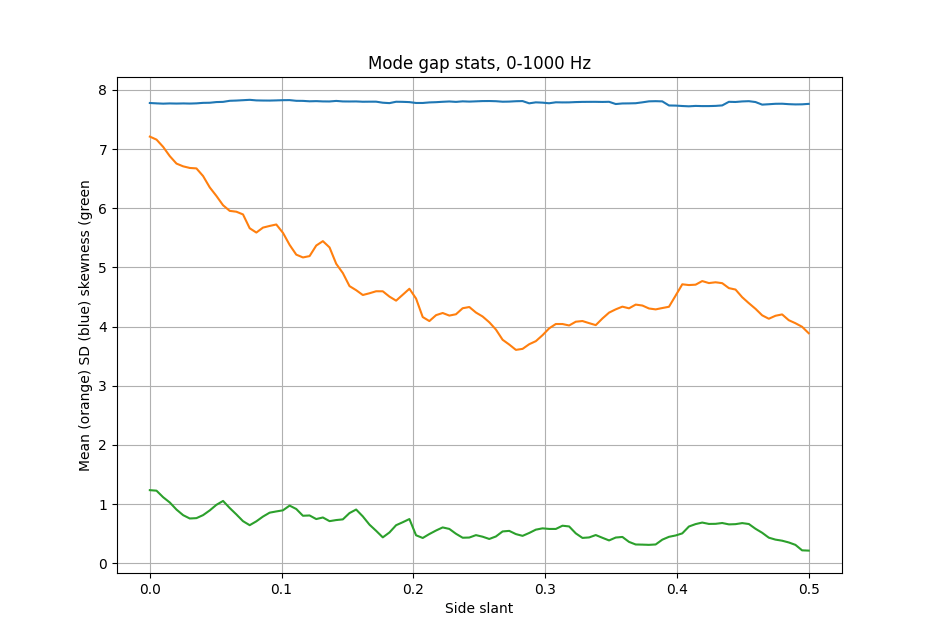

First run of Elmer in Python, investigating the effect of introducing asymmetries into a rectangular panel.
First slanting one of the panel sides, by decreasing top length and increasing bottom length.
100% slant turns the rectangle into a triangle
The plot has 100 points.
Aspect ratio is 2. Area 0.5 m^2
Plot shows mean, SD, and skewness. A gaussian distribution has a skewness of 0.
Looks like it's worthwhile going beyond 0.5, will post another graph.

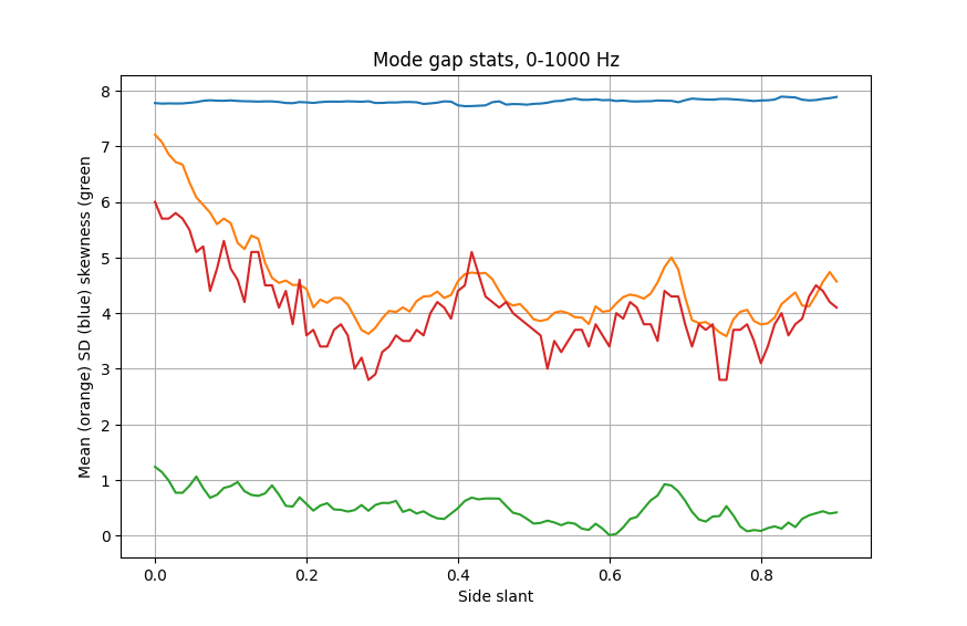

Graph below shows stats for side-slant from 0 to 0.9
The unlabeled red curve is a simple count of mode gaps < 5 Hz divided by 10, indicating that most of the SD variation is caused by the number of mode gaps near zero.

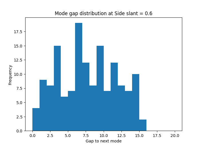

Interesting that the skewness is almost 0 at 0.6 slant. Unfortunately, zero skew does not imply Gaussian distribution:

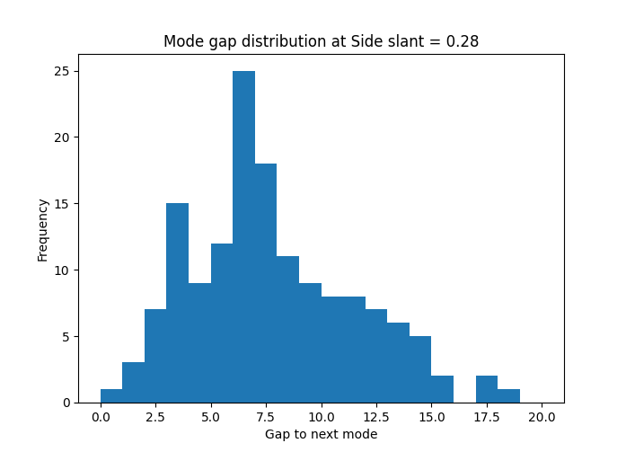

A better histogram found at 0.28 slant where SD is minimum.
