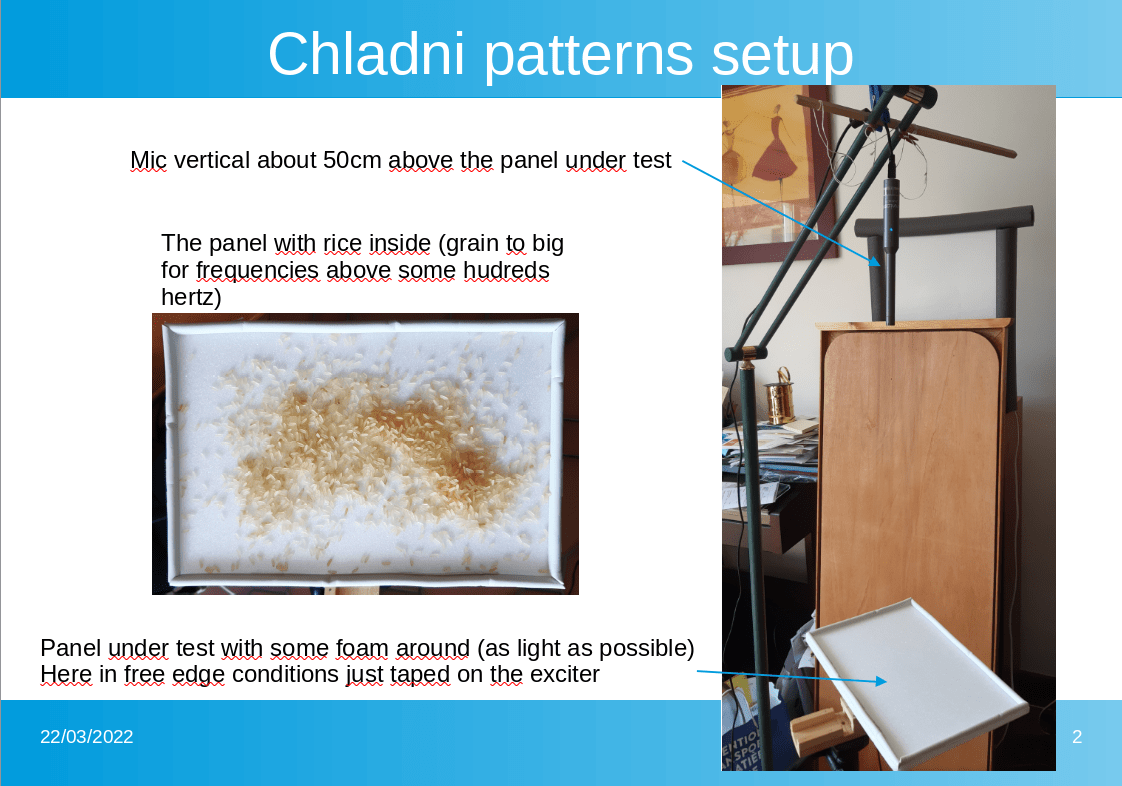

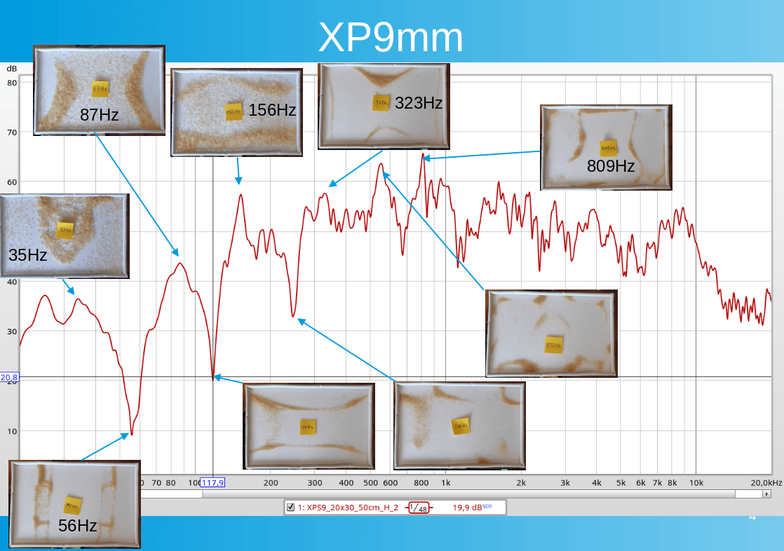

@Veleric + all
Just to share I started some additional tests in the idea of the Chladni patterns. No so nice pictures as with the guitar above but probably informative, at least that help to understand the DML behavior.
apart the possible link with the mode type, I was impressed seeing vibration in modes without sound. See the holes in the FR.
Below some slides to explain.
To be improved probably.
Advice welcome
Christian

Christian,
Nice work on the Chlandi plate! I tried a very similar thing a few weeks ago. I did see some shapes but not even as good as yours.
For my plate I used and aluminum sheet attached to a frame by foam, since I was trying to simulate something close to the construction method I use usually. I chose the aluminum plate only to minimize the damping and hopefully encourage the shapes to be much clearer. Like you, I used a strip of foam around the edges as a wall to hold in the particles. I tried salt and sugar, but not rice.
Overall, I was disappointed in my experiment turned out. Nothing as pretty as the Chlandi images you find online, or even as clear as yours.
This is a 20x30 plate, right?
Eric

Christian,
Eric
Thanks. Yes it is a 20x30cm XPS9 (9.4mm) we just discussed before.

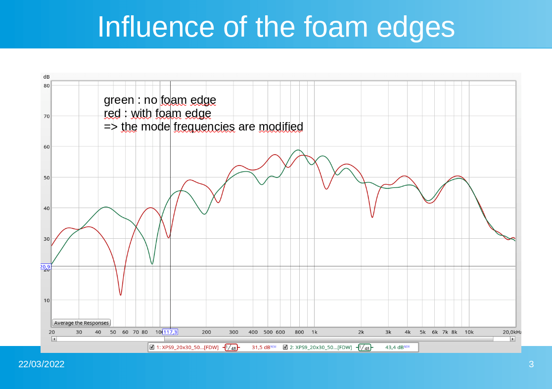

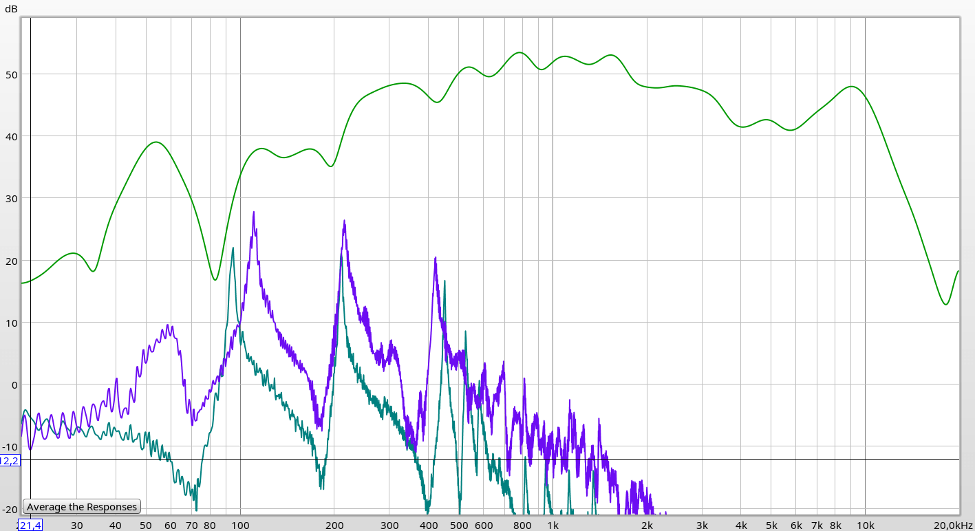

Eric,
Below a test with the XPS 9mm 20x30cm panel
  • green is the FR
  • dark green is the tap test without the exciter
  • purple is the tap test with the exciter
So it seems confirm the increase of the mode frequencies. Due to the additional stiffness from the exciter?
I don't know what to think about hte humps between 50 and 60Hz. In the FR, the 54Hz hump seems linked to the room. I have another FR where the panel was at the door window, the rear side firing to the garden; this hump is not so present.
As there is no hump in regard the other peaks, I understand that for the next modes, if they don't appear in the FR, it is because they have a low or even no contribution to the sound.
A tap test at 1/3 1/3 might be instructive ?
Christian

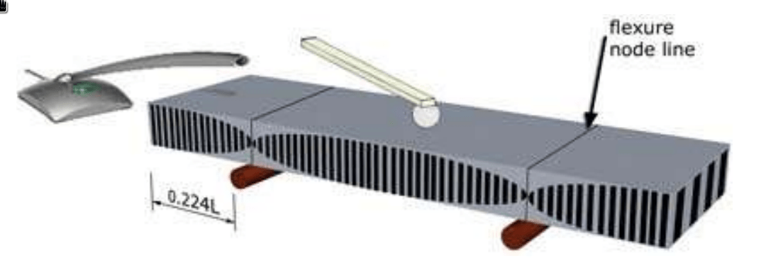

Trying to follow along as best I can with limited math...
But what is "0.22 point"?
Hello NaRenaud
IET Impulse Excitation Technique is based on mode excitation. The sample plate has to be held at a node of the desired mode. In flexion, this node line is at 0.22 x plate side (see attachement)
As you can see in the posts here, I experienced the method. The math behind are not really difficult with Excel or equivalent, just applied what is on the net. The more tricky aspect for me is to get the culture of modes, in one sample modes had the same frequencies so not easy to understand what is what.
In the videos about guitar top, you'll see it is the node line used for the tap test.
Christian

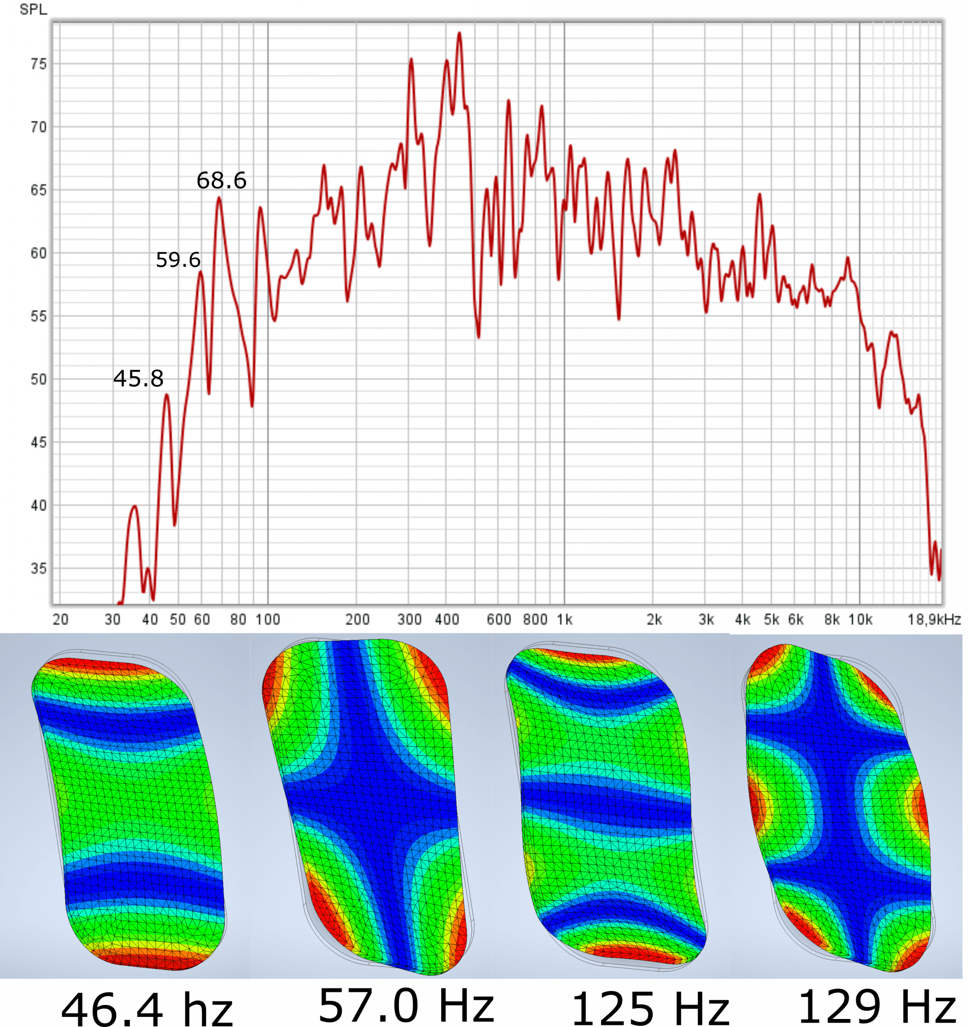

Hey, I just stumled across your thread. Very nice read! Thanks for the tip with Freecad. I absolutely overlooked that one.
I am suprised to see that basic modes are in the audible spectrum. From some rough calculations I expected them to be much lower. This changes a lot for creating a good sounding bass. All the tricks with weights and asymetric panels shouldn't work in that frequency range, at least with the panel size and thickness that most people are using.
Have you tried suspending your plates with long rubber bands? That should make them free Mindlin-Rissner plates as there is no more momentum transfer to the suspending structure no matter the position of the suspension points.
You were also talking about the question whether some modes don't produce any sound at all bc all the positive pressure zones would cancel with negative ones. I stubled across this sentence: "When the bending wavelength is longer than the wavelength in air, real sound power is radiated to air" (A. Dumčius, L. Bernatavičius, The Research of the DML Loudspeakers Propertie, check the google drive collection for it). My understanding is that when this condition is not met high and low pressure zones can compensate directly in front of the plate. So you don't even get sound in the near field. In the far field I would expect the soundwaves to cancel out even if the condition is met but since we get sound out of these speakers it obviously doesn't. Mb someone here has an explanation why the sound doesn't cancel out when facing perpendicular to the plate.

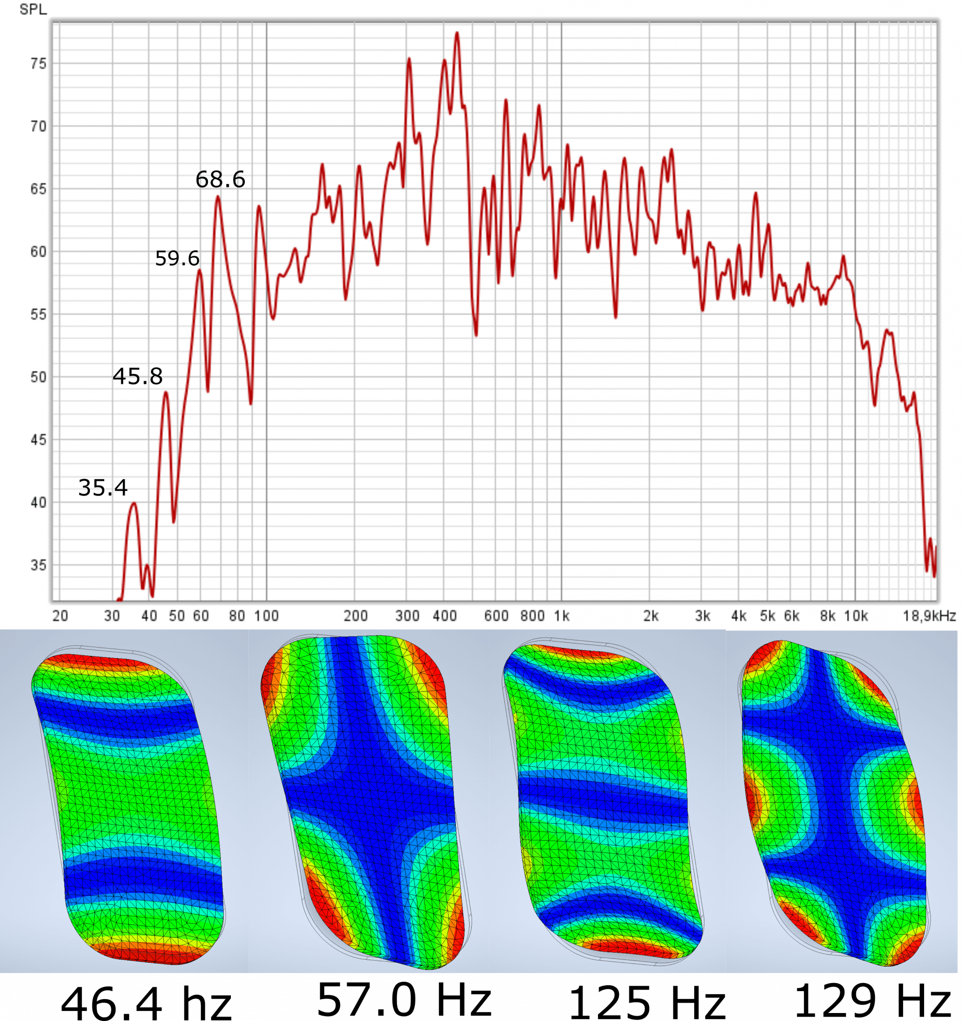

I modeled my current speaker which is a 1200mm*600mm*20mm xps board with rounded corners in Inventor and ran a mode analysis. I also recorded a frequency sweep with the exciter attatched at the common 3/5th position.
Now the great guessing game starts which one of the peaks resembles the base mode. Unfortunately I don't have the material constants for my specific xps plate, So I just used a rough estimate with values I could find online. Now comparing the simulated modes with the responsecurve I think the base mode is the 35.4 Hz one because the frequency ratio with the next one is very similar to the frequency ratio for the simulated modes (1.29 measurment 1.23 simulation). But when looking further up the frequency range there is a huge gap to the next simulated mode. The response curve does not feature such a gap at all. I also found a paper which simulated the the first couple of modes of a free mindlin plate: https://www.hindawi.com/journals/sv/2018/8562079/
They have a similar gap between the 2nd and 3rd mode, with the 3rd and 4th super close together again. Take note the paper has a rectangular shape, my board has a 2 by 1 aspect ratio.
So the question is what the other peaks are. I will definetly do the impulse excitation test you did as well. This should tell us if the other peaks are due to the exciter (impedance, god knows what...).

Hello Harzer99
About Freecad, I haven't really pushed further for now... it is a bit aside my knowledge area but the main reason is 2 aspects are missing : for low mass membran, I think the exciter changes the behavior by its mass and stiffness and also a calculation of the SPL might be a plus. So good tool for some 3D drawing but for DML?
Different types of suspensions have been tried. The best low freq response seems given by some surrounding foam.
I have read also about the role of the wavelenght in the materail compare to the air but for now, I don't know what to do with it... You can make measurements at short disdances. If I remember, the FR is much flat so the hypothesis of areas cancelling at distance make sense.
