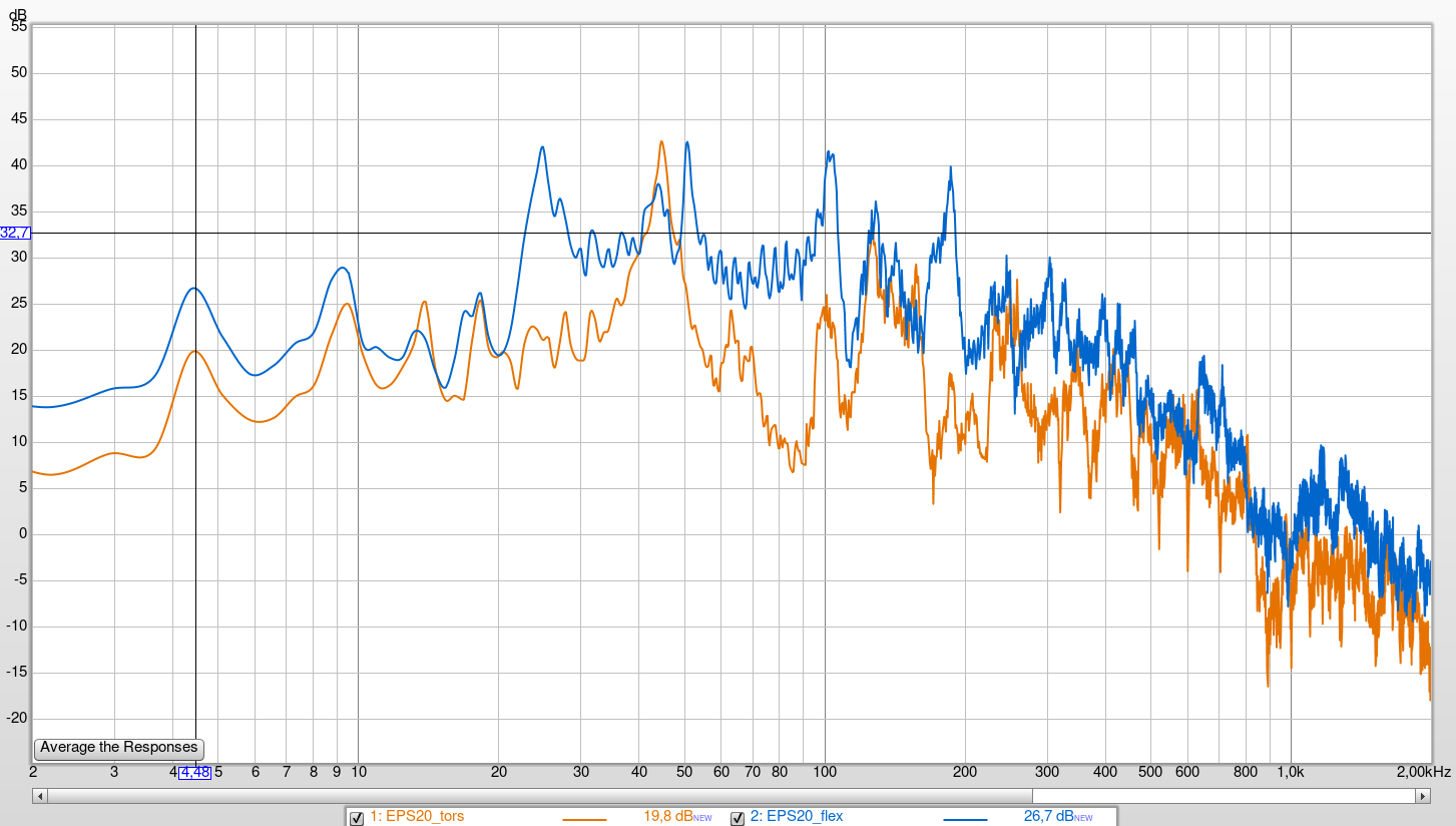

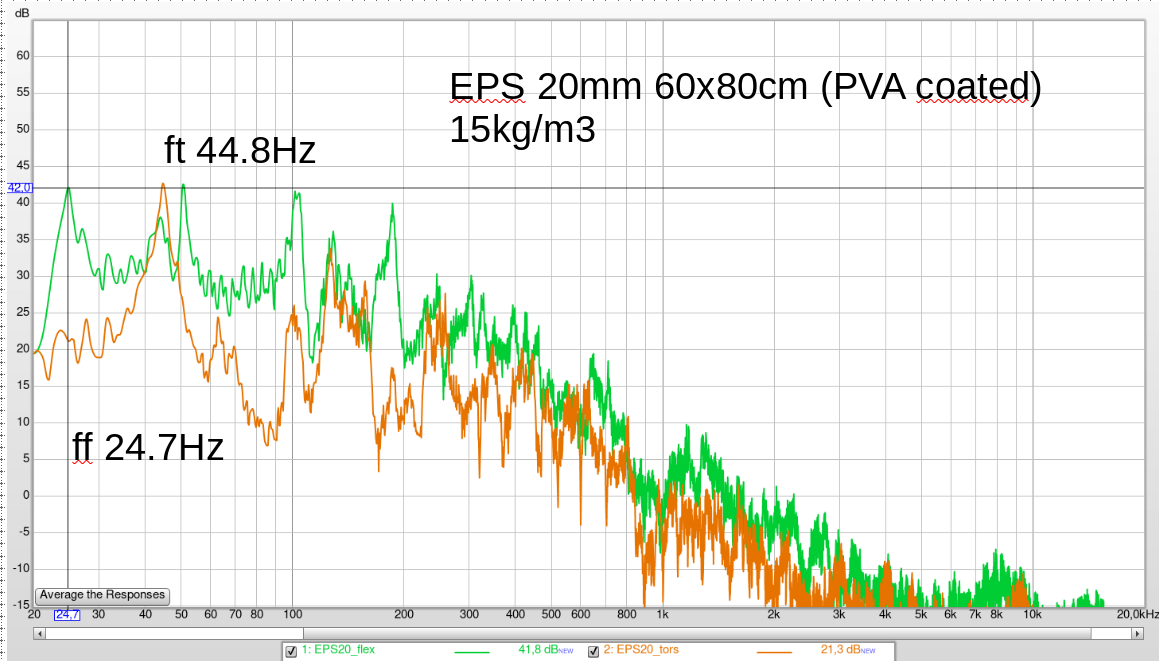

Hello again Eric,
Here is a new case study (or simply a new case)
I took the opportunity of having a piece of EPS in the grade Spedge is talking about in the main thread about DML.
60x80cm 20mm thick (19.6mm more precisely ;-) ).
The 2 modes appear quite clearly (tap/mic @0.22 in torsion)
flexion= 24.7Hz (green), torsion = 44.8Hz (orange)
It comes E = 9.3MPa. I have in my notes 6MPa probably for an EPS without coating (to be checked...)... why not.
And also G = 18.5MPa. Higher than E????
I think the method is applicable but can we use the data in the same way? At firs sight there is not a big difference compare to the plywood except it is not an orthotropic material.
Christian

Christian,
Using the LISA FEM and iterating values of the elastic constants to fit your results as well as possible, I get the following:
E1=6.9 GPa
E2=1.25 GPa
G=0.72 GPa
nu12=0.1
I got these by choosing values of the elastic constants to get as close as possible to:
Torsion mode: 79.5 Hz (model result 79.6)
Saddle (X) mode: 156 Hz (model results 155)
Breathing (O) mode" 161 Hz (model result 160)
Having never tried creating/testing/measuring a Poisson plate before, I was not exactly sure of the best way to determine the Poisson ratio (nu12). But what I observed in the FEM is that nu12 mainly influences the difference in frequency between the saddle and breathing modes. For example, i got the following for various choices of nu12:
nu12 = 0.05: Fb-Fs=156-153=3Hz
nu12 = 0.10: Fb-Fs=160-155=5Hz
nu12 = 0.20: Fb-Fs = 163-153=10 Hz.
I chose nu12=0.1 as it came closest to my best interpretation of your tapping results.
Note, concerning the 145 Hz frequency you observed when you tapped the center and held at the corners, I believe that is the the Breathing mode (160 Hz), but shifted down by the mass of the supports, which are not at the nodes of that mode (in that measurement).
I always check to be sure that a few of the next higher modes observed in tapping are consistent with those predicted by the FEM. It give me more confidence in the result. The next modes in this case predicted by the FEM are shown below, at 223 Hz, 225 Hz, and 391 Hz.
Those resonances do seem to be in your tap results, as for example in this measurement below. The one at just under 200 Hz bothered me a bit at first, as it is so far below the 223 or 225 Hz predicted. But I expect that is the same effect as the 145 Hz one I mentioned above. That is, the supports are not in the ideal position for that particular mode, so the mass of the supports shifts it down. Also note that typically the FEM predicts the higher modes at higher frequencies than are experimentally observed. This is due to the fact that the FEM (mine anyway!) uses the Euler beam equation. At higher frequencies this simplification becomes less valid. Thicker plates are even more affected by this simplification than thin ones.
Overall, I think we have a pretty decent fit to your results here.

Christian,
I agree that EPS should probably be isotropic, or nearly so. But why not simply do the flex test in both orientations, just to confirm?
And you are correct to questions G>E, it can't be so. At most, it can only be E/2.
I suspect you have a torsion mode below 20 Hz hat you can't see.
Lower frequencies are harder to get accurately with the RTA/Spectrum in REW, but if you increase the FFT length to 128 or 256 it will help the resolution but slow the updates.
You could also cut a smaller piece.
Eric

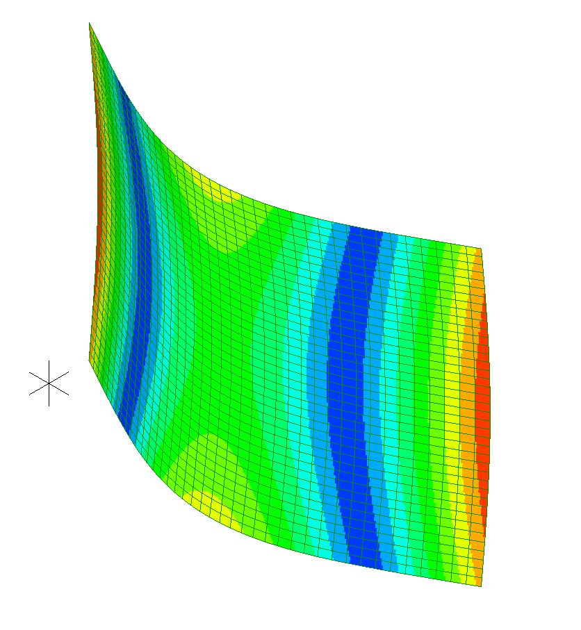

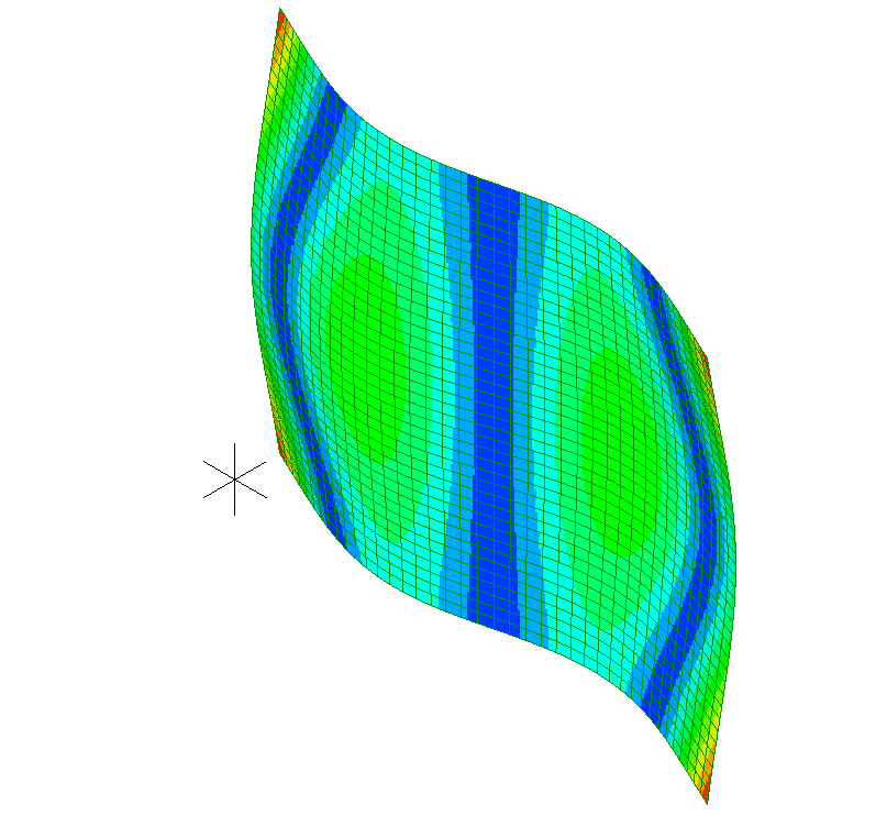

For now, I am not able to make a link between the modes from simulation you show and the naming of the modes with the 2 integers (m,n). Torsion, flexure, saddle... many names. Do all occur in a DML?
Then we can imagine different criteria to classify the suspension solution :
- the lowest fundamental
- the best modes density
- the capacity to keep the membrane flat... it was the one that leads me for the plywood panel seeing how it warps after a varnish layer.
The conventional naming of the modes that I have referred to in the past (1,1), (1,2), etc, has only been with respect to plates with all four edges either simply supported (hinged) or clamped. I'm afraid I don't know if there is a convention for naming of the modes of free hanging panels. Lots of funky modes can happen. What to call this for example?
Probably one of the most important questions also is "which of the modes actually contribute to the output?". For the simple or clamped plates we know it's the odd,odd modes. But what about for the free plate? My guess is that modes that include identically shaped areas moving out of phase with each other would not contribute much, while those without such "symmetry" would not. Hence, I would imagine the fundamental torsional mode would ineffective, while the bending modes like the first one below might contribute, while the second would not. Because for the second one, for every point on one half of the panel moving in one direction, there is a second point on the other half of the panel that is moving at exactly the same speed but in the opposite direction. At any distance, the effect of these two points on the motion of the air would be cancelled, I suspect. But this is only me speculating.
Eric

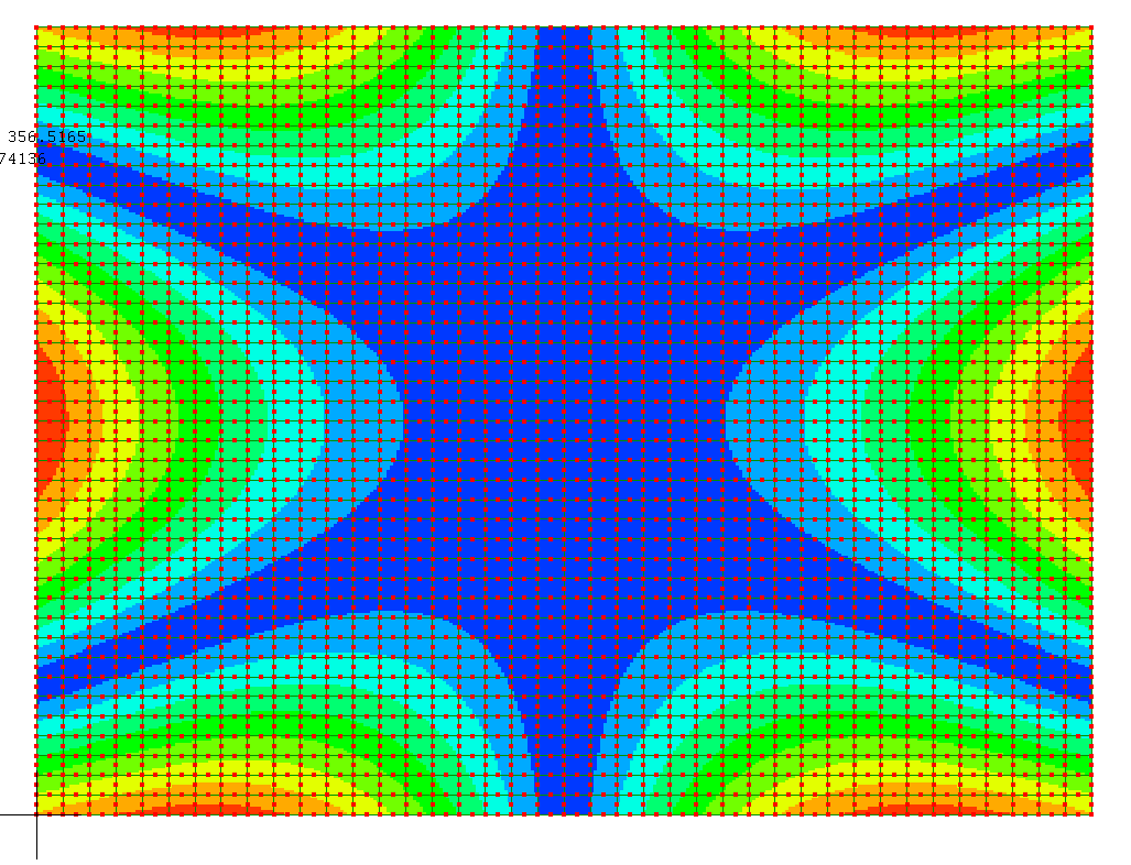

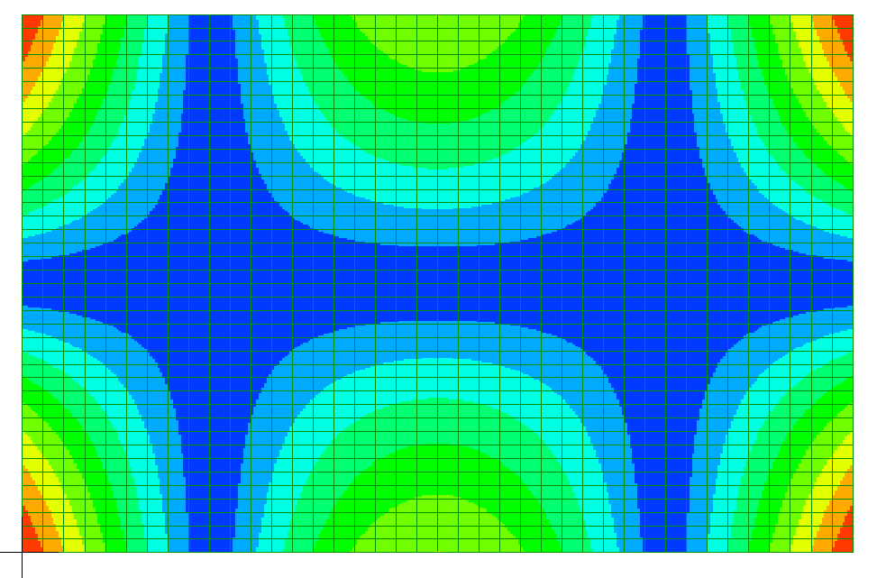

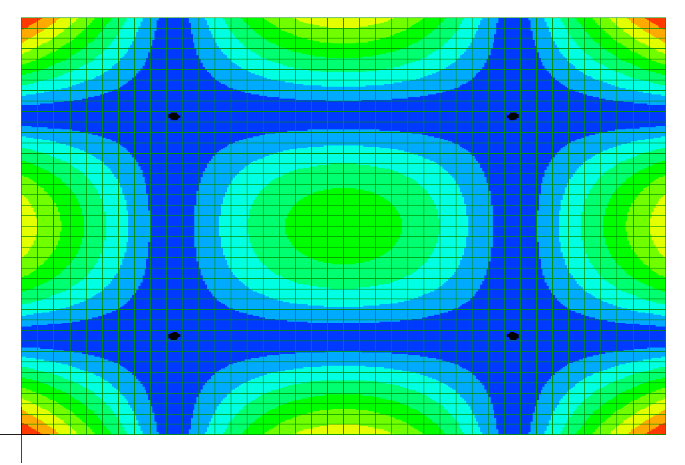

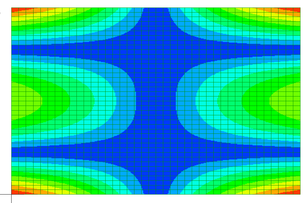

Hello EricChristian,
E1=6.9 GPa
E2=1.25 GPa
G=0.72 GPa
nu12=0.1
View attachment 1035121 View attachment 1035122 View attachment 1035123
Eric

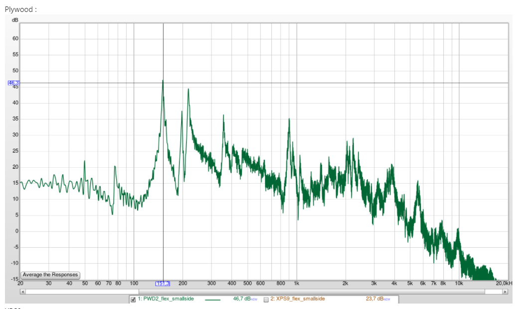

That's good that simulations and tests match pretty well. The values you use for E1, E2, G are not very different from the one from the IET formulas give.
I am not sure about the mass of the support as an explanation. The clothespin I use are not the standard one but very small one (25x7x2mm) used in decoration. The string is light also.
I don't know if I will do the test but do you think that to drill a small hole (2mm?) near the edge can replace the support avoiding the question of mass?
For the XPS, as it is thicker than the plywood, the clothespin can't open enough so I use some trips of tape to reduce the thickness for the mini clothespins. A better practice might be perhaps to use only tape and string?

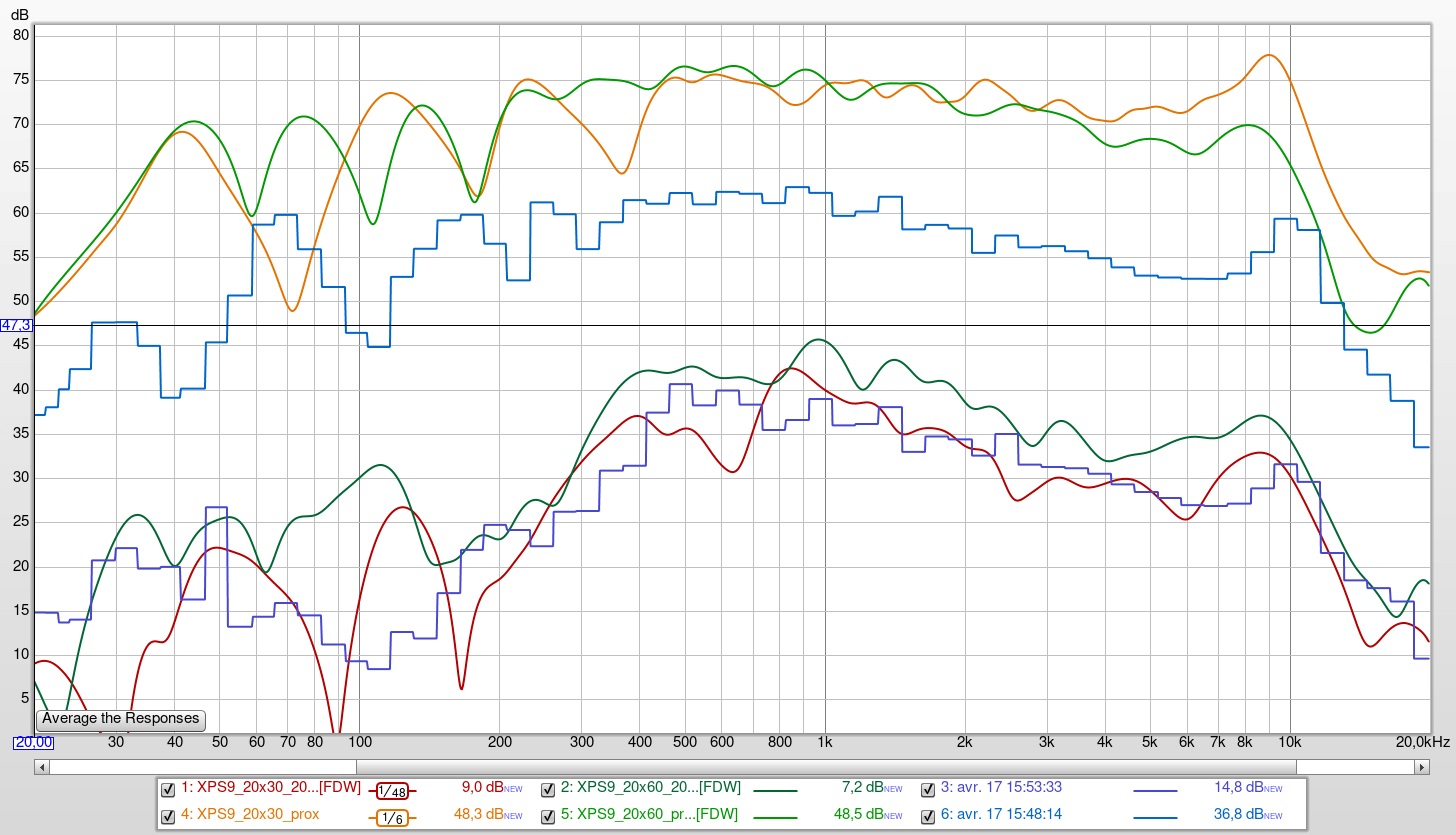

Flex test using the embedded beam configuration is what I did when I bought this EPS..; only in one direction because I didn't want at this time cut the panel. It gives me E=6MPa comparing to the 9.3MPa evaluated with the tapping method.
For G, I don't know an alternative method to the tapping one.
The RTA is set to 65536 for the FFT and 48kHz as sampling frequency. Are are the spectrum. Some filters are probably acting in the range 2 to 20Hz. Anyway, the shape is here.
An other good practice is to be prepared for cutting a second sample (see the XPS case) to readjust the frequencies.

It makes sens EricThe conventional naming of the modes that I have referred to in the past (1,1), (1,2), etc, has only been with respect to plates with all four edges either simply supported (hinged) or clamped. I'm afraid I don't know if there is a convention for naming of the modes of free hanging panels. Lots of funky modes can happen. What to call this for example?
Curious. Assuming the panel is nearly isotropic, the torsion mode should fall just below the lower of the two bending modes, for this shape of panel, regardless of the poisson ratio, according to my FEM. I wonder if the bump at about 18 isn't it. If you have extra material, I'd try a smaller plate.

In the main thread about DML, I answered to a question about the tension of my canvas panel. I use Audacity also. Now that I have tested the technique proposed by Veleric, REW is more convenient.
@Veleric
Eric,
In my posts, you have perhaps noticed that I try to understand why my second panel didn't work. No bass, no treble. It was a 60x80cm panel made of XPS 9mm. The one I use for testing. On this panel I use the same surround foam than in my plywood panel : a 17x17mm "light" foam on the 4 sides. This technique (and foam) seems working with the plywood, not for the XPS. Have you already tried to put some data on the suspension in regard to the panel characteristic? In other words, I wonder if the stiffness of the foam I used is not too high for the XPS while it is acceptable for the plywood?
Writing that and putting to gather recent measurements and older one... I have doubts... Is there a full improper use? When in parallel you say you get a response down to 100Hz... I would say yes, some thing is wrong.
The three upper trace are at close proximity of the exciter in order to give an idea of the mode at the exciter
The three lower at 2m (far!)
green / dark green are a 20x60cm panel just glued on the exciter (no suspension, no string)
orange / red are a 20x30cm also just glued
blue / purple are a 60x80cm with surround foam
Thank you for your help in the analysis.
