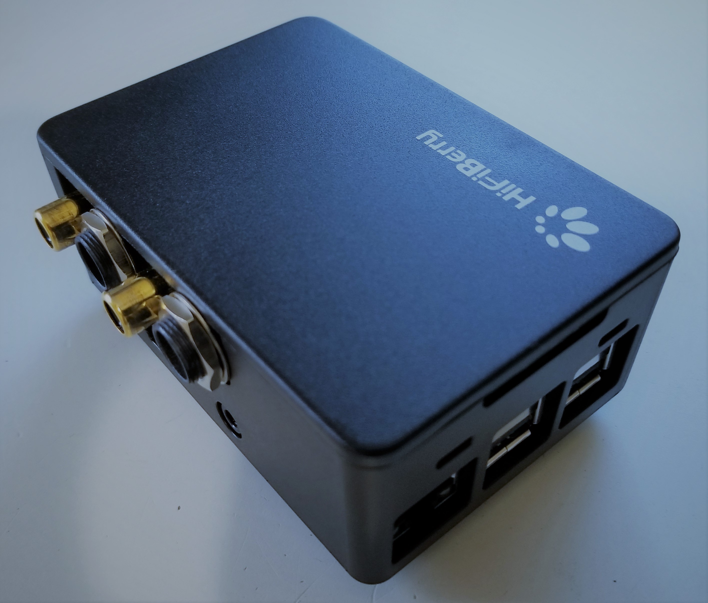

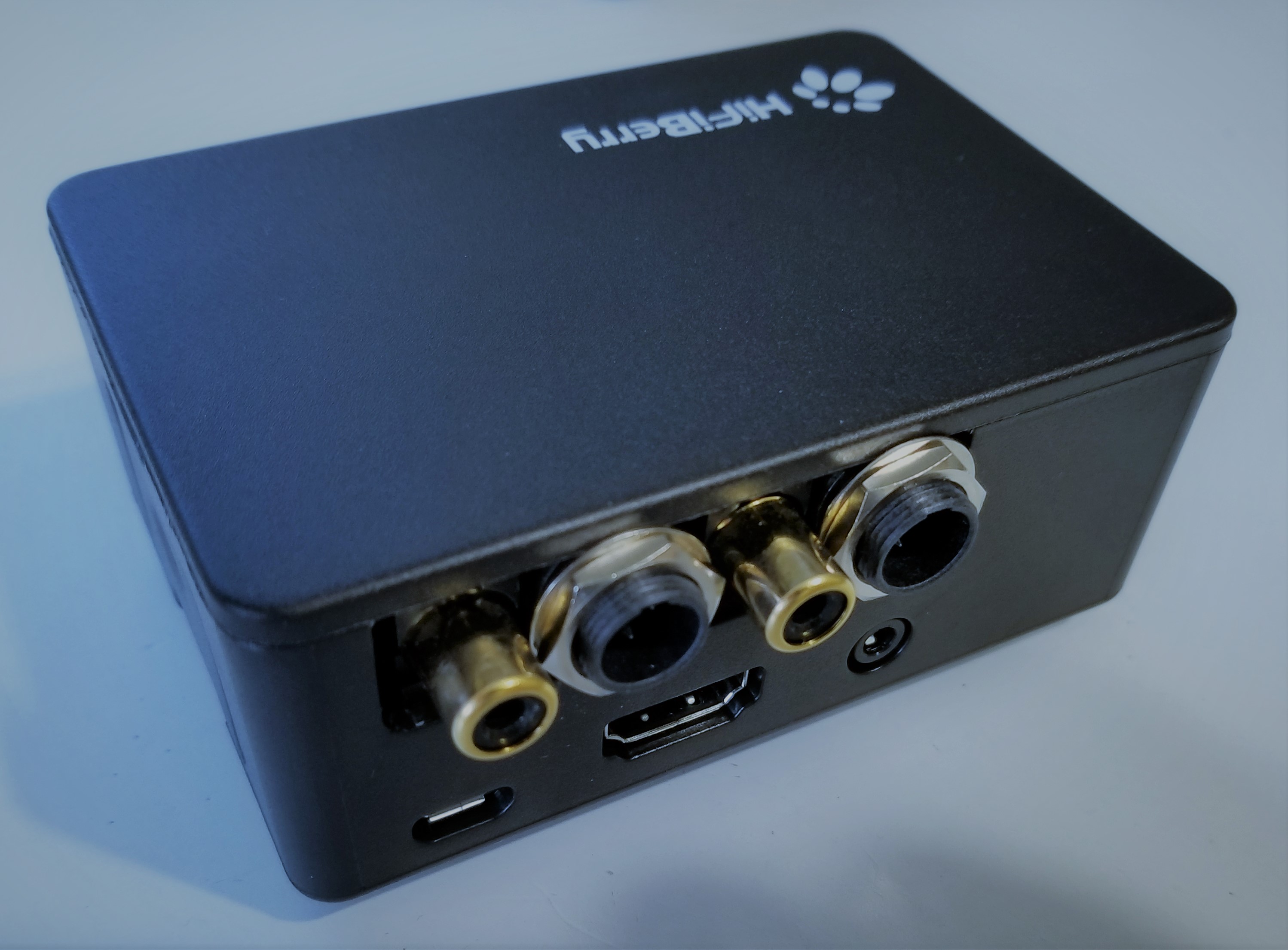

Case for ApplePi DAC...
Thanks to one of my customers (Rick D.) I can say that the HifiBerry Universal Case, fits the ApplePi DAC perfectly:
HiFiBerry universal case, black | HiFiBerry
I would highly recommend getting these heat sinks for the DAC chips:
https://www.newark.com/fischer-elektronik/ick-smd-a-8-sa/heat-sink-dip-ssop-tssop/dp/34M6428
In addition to the heat sinks I additionally recommend drilling a few holes in the top cover to improve airflow.
The case will not work with ApplePi Volume-Clocker.
Here are some pictures:
