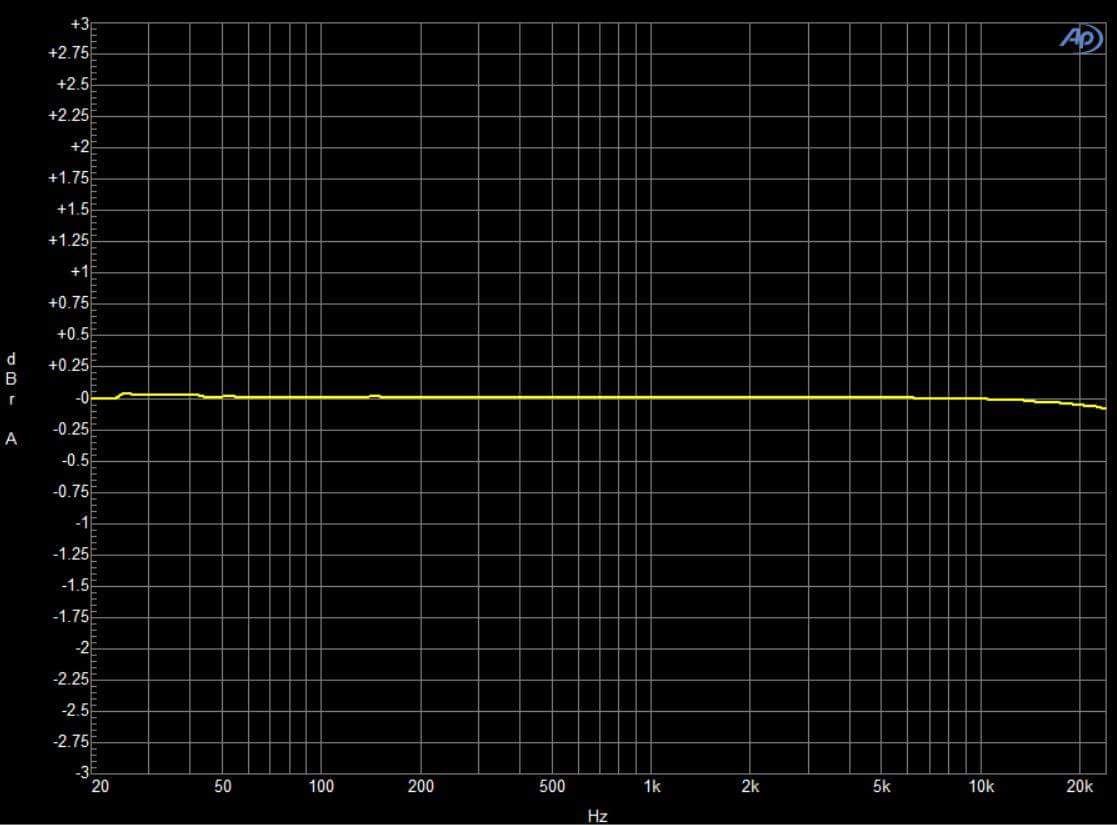

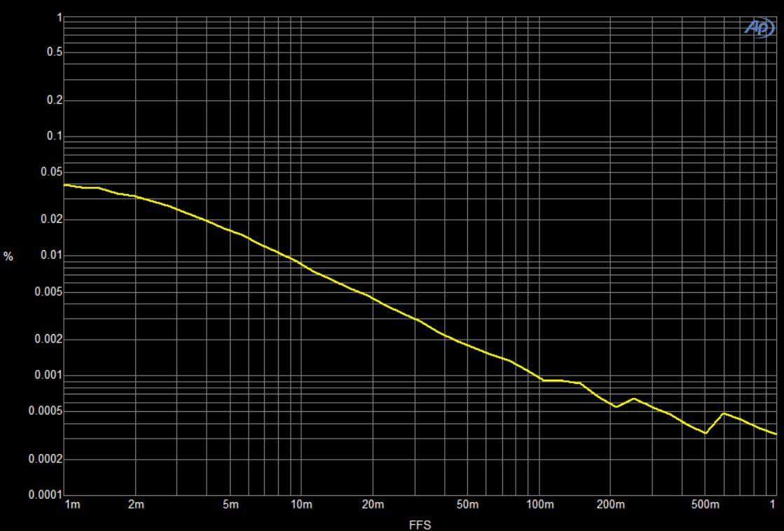

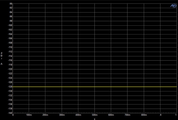

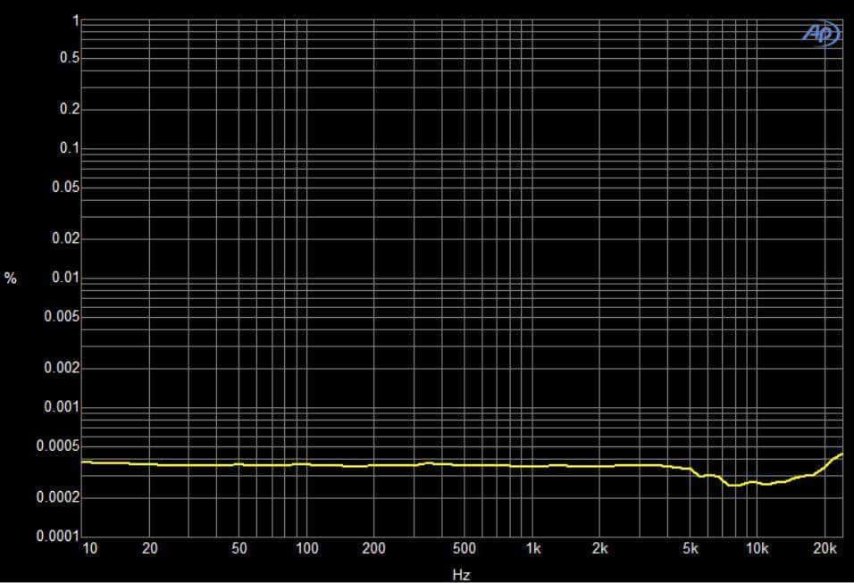

I am sorry for any mis-information, I have reviewed all of the measurement data that I have received and I do not know how the third party came up with a dynamic range of 135dB.
In the future I will have to review all data more carefully.
All other measurements are correct.
See attached plots.
1. THD+N vs amplitude
2. THD+N vs frequency (0dBFS 1kHz)
3. Frequncy Response (0dBFS 1kHz)
4. SNR

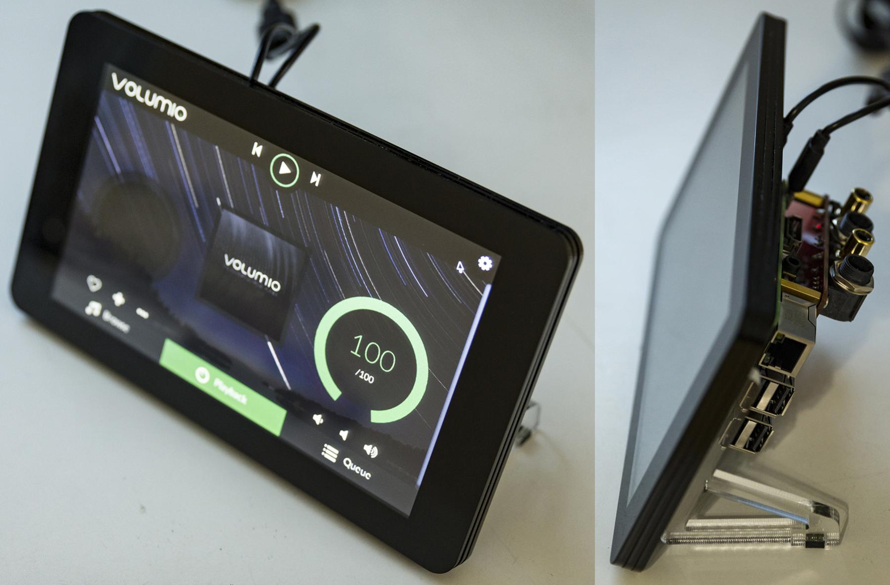

Now you can get and ApplePi DAC system that is completely ready to go out of the box, and includes a 7" touchscreen.
Here is a video showing it in action:
ApplePi DAC System w/ 7" Touchscreen
