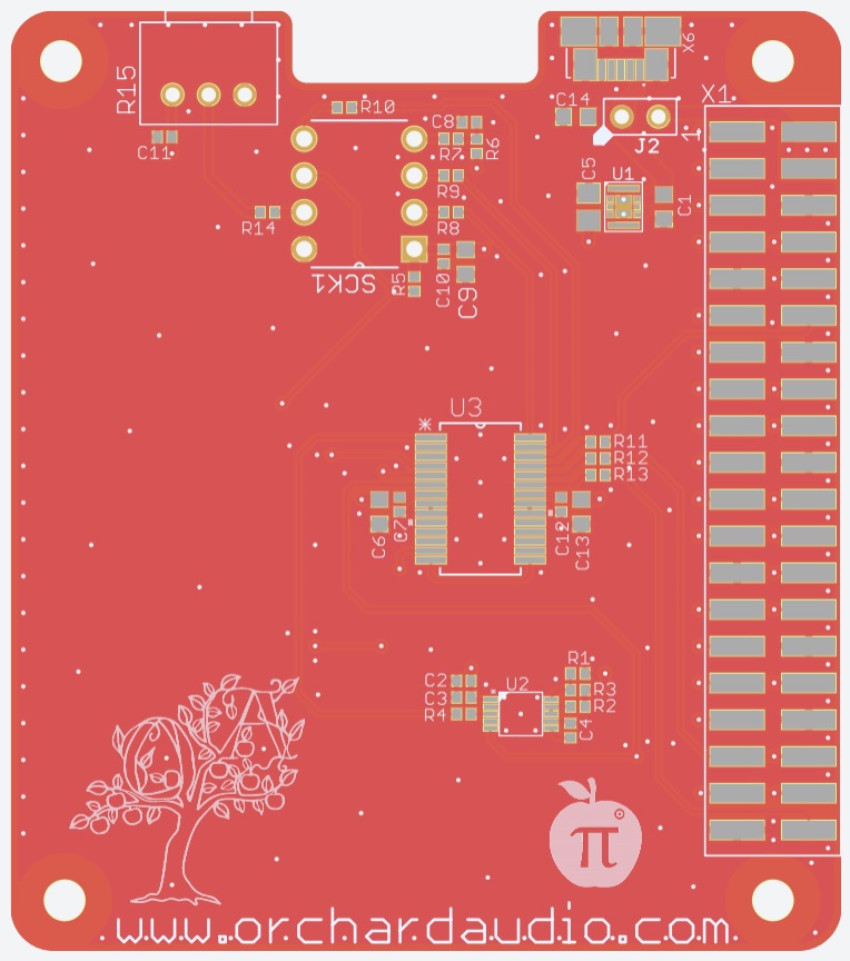

The ApplePi Volume-Clocker allows you add hardware volume control to any RapsberryPi I2S DAC.
Volume is controlled by a potentiometer R15. Volume is adjustable from 0 dB to -127.5dB, in 256 steps.
In addition to HW volume control this board will also remove jitter from the RapsberryPi's I2S signals improving audio quality.
It can be powered externally though it's own micro USB (X6) connector or from the Raspberry Pi. The ApplePi Volume-Clocker cannot back power the Raspberry Pi.

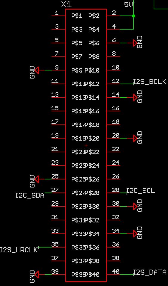

You can use the ApplePi DAC without a Raspberry Pi and hook it up to either a USB to I2S converter like this one.
You can also hook it up to an SPDIF to I2S converter like this one.
There are many different option for SPDIF to I2S and USB to I2S.
Here is the pin out of the ApplePi DAC's connector. All you need is 5V and then the I2S signals. The I2C lines are not needed if you are not using with Raspberry Pi.

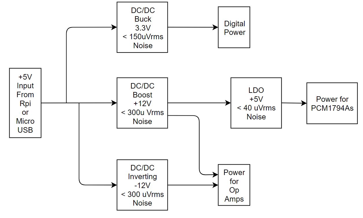

Orchard, i really dig your enthusiasm about your product, and as i've said before your product appears good, but kindly entertain the notion that 98.5% of the people in this particular forum know the difference about I2S and SPDIF, for instance.
Please don't take this the wrong way, i believe you are well within your forum rights to say whatever and as often as you'd like, still i can't help but think you might get more positive attention(and by extension, perhaps more interest in your product in the future) from the community as a whole if you engaged us more as a designer and maker than as an (understandably so) excited salesperson.
Your PSU btw looks nice, did you ever consider a bigger board with separate regs per dac? Can you give us any insight into your design process thinking for the PSU?
See attachment for the power supply topology on the ApplePi DAC.
As you can see all of the power supplies generate little noise whether they are digital or analog. Couple that with the PSRR of the parts and noise become extremely low. That is how the DAC is able to achieve such good SNR. All power supply noise figures are measured band limited 20Hz to 20kHz.
The OPA1612 opamps have a PSRR of >70dB below 20kHz.
If proper decoupling techniques are used there is really no need use separate power supplies for each of the DAC chips. This board already achieves a cross talk of > 135dB.
In order to stay within the Raspberry Pi hat specification the board has to be the size that it is.

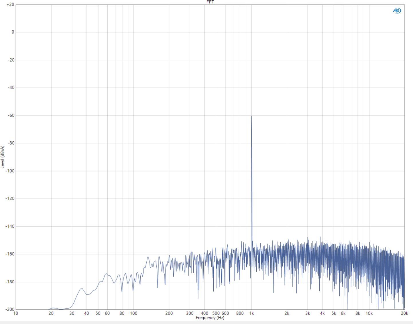

The second image shows FFT (A-Weighed) of the output of the DAC with 0 FS input.

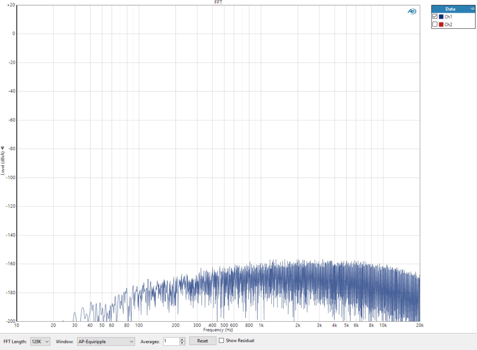

The third image shows FFT (A-Weighed) of the output of the DAC with -60 dBFS input.

Comparing the 'grass' between the two plots there does look to be significant modulation of the noise floor by the presence of the -60dB signal. Would that be attributable to the DAC chip or some other factor do you think?
It is an attribute of the PCM1794A, due to the way that it handles 0 input (silence).

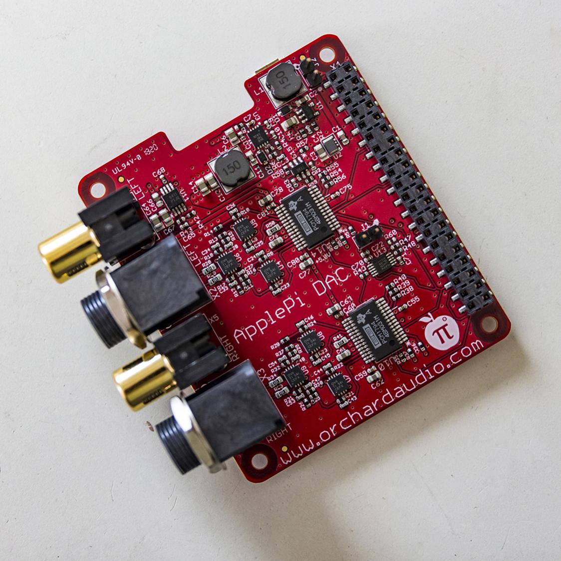

Here is how the final ApplePi DAC will look like. Will be available for sale in about 1 month.
