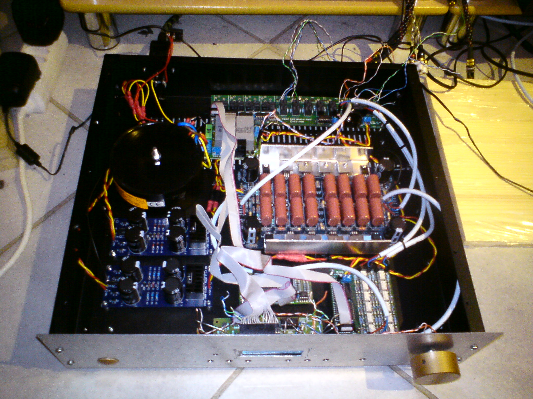

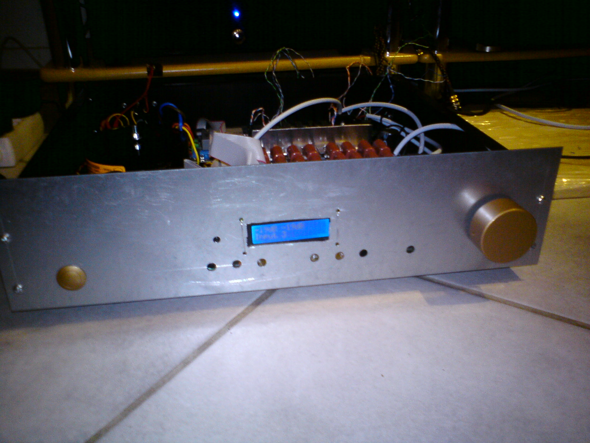

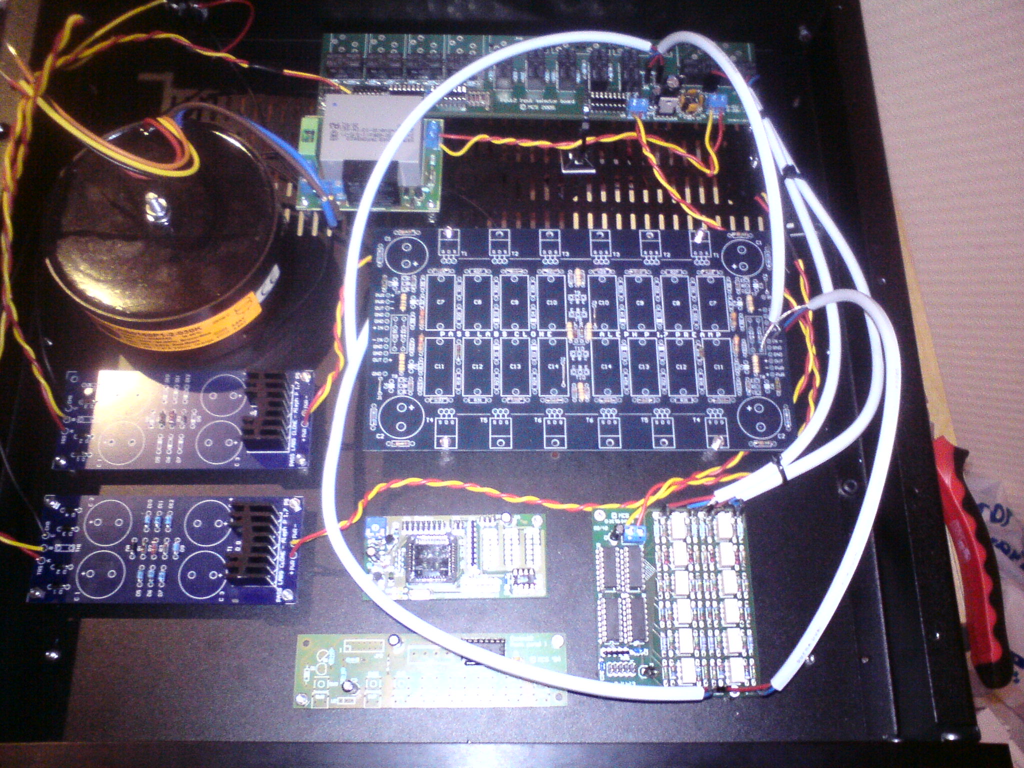

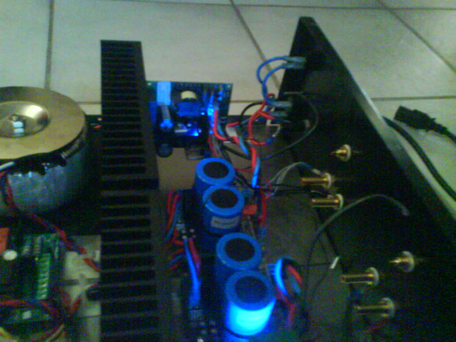

mine is comming together.
soon ready for startup:)
With the Aleph, you need 1K sets with volume control on the output. This way the output impedance stays relatively 'low'. When you put the volume control on the input (as is done with many other preamps), you want a close match to the input impedance of your preamp.
