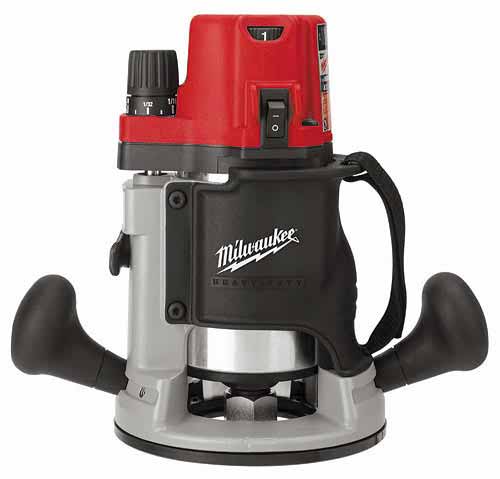

A quick search reveals this Millwakee 2 1/4 hp router looks like it has a really nice smooth bodied motor that could be removed from the router frame and placed into some kind of a sturdy head mount on a CNC router. The 1/2 inch chuck would give it a lot more rigidity and moving to a 1/2 inch mill would speed up machining time a lot since it can remove twice as much material at the same feed rate. Also, a router like this would have much better bearings and cut more accurately. With a 1/2 inch chuck you can also use a much longer mill or router bit which allows you to machine deeper pockets such as a foam mold or something.
Just ideas.
...A quick search reveals this Millwakee 2 1/4 hp router looks like it has a really nice smooth bodied motor that could be removed from the router frame and placed into some kind of a sturdy head mount on a CNC router...
Hi Hezz - yep, that's basically what I do. I have a 2.25hp Porter Cable 892 router (a motor body like this: Porter Cable Product Details for 2-1/4 HP (Maximum Motor HP) Variable-Speed Replacement Motor for 890 Series Routers - Model # 8902)

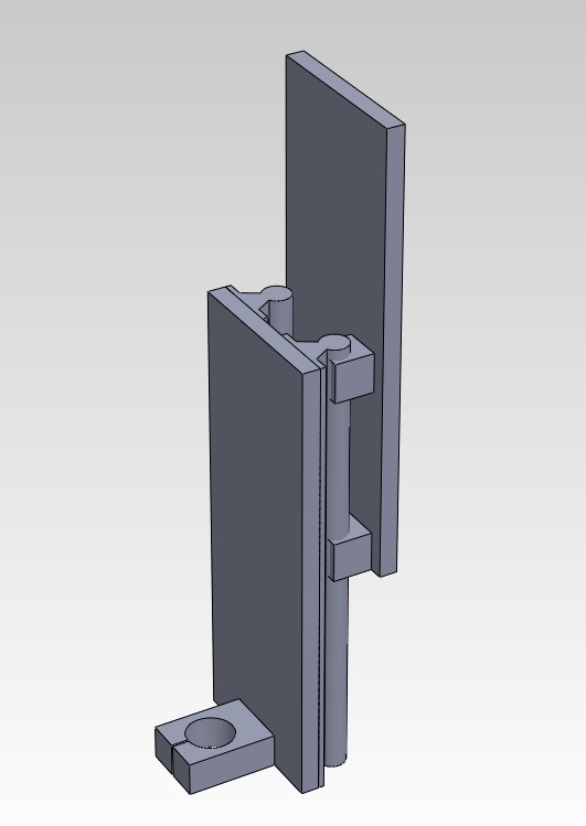

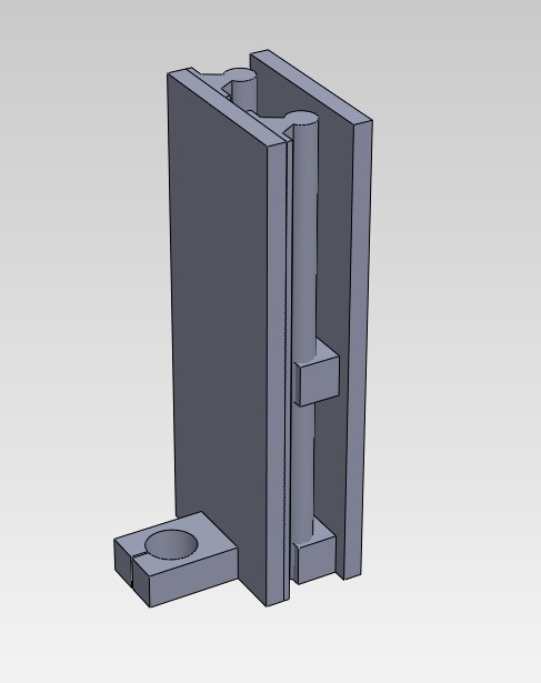

Here's the new Z axis construction that they're doing for the replacement. I've done the drawing in solidworks just to convey the basic idea. Its neat because the higher up the working area the less the Z act as a lever - ideal for alu where you'd raise the stock and take benefit of this.

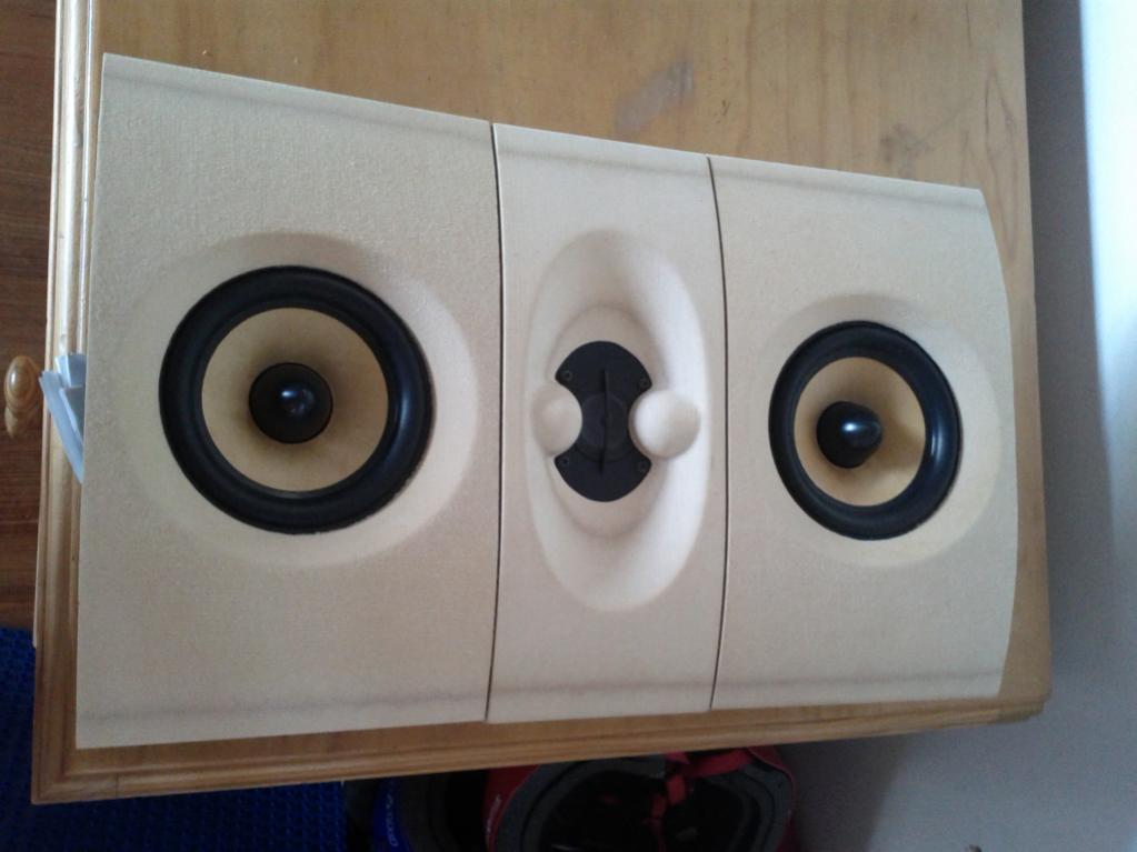

Try this manually...
