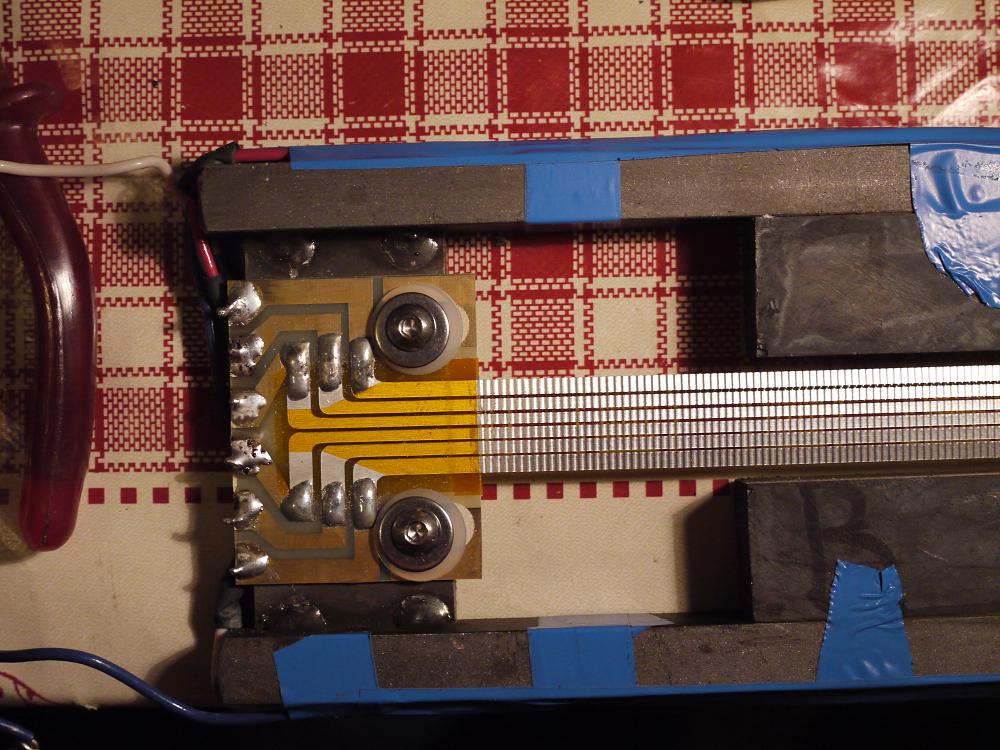

3 trace 2 sided ....just to be sure....some of the Calpier sig have foil on front an back on the MRT?.......thanks so much for the insite.....an time...

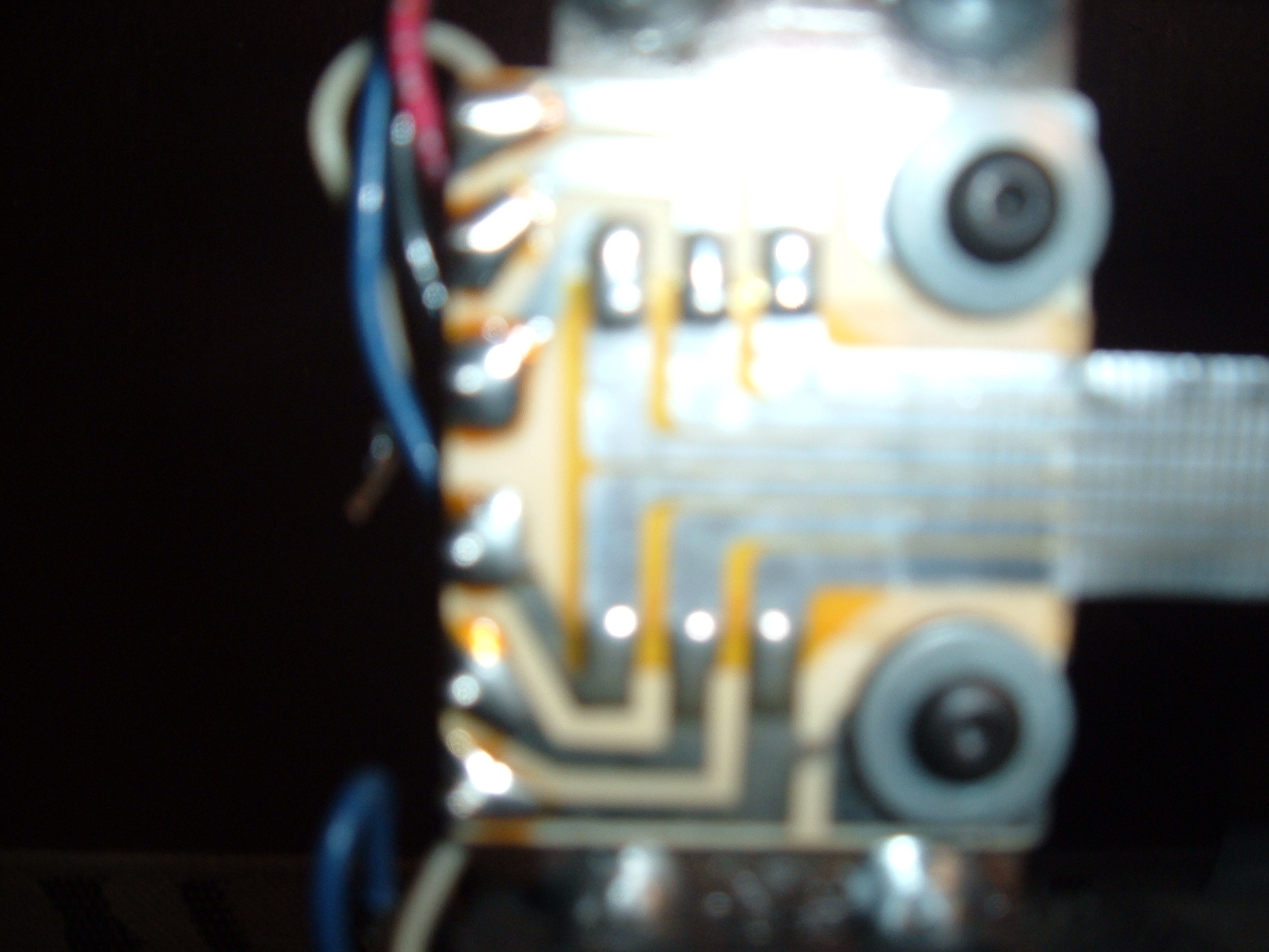

I have posted this be for ....but the ribbon for the Minors 26"MRt ...that have the fix end...this type of mount..... makes a BIg diff in the sound.... I have pulled the bars that Apogee use that go a cross the ribbons top an bottom.....off an mounted just the board......as in the pic.... the sound stage get better...sweeter more....extended sound.....
I been trying to find a way to do this on my Stages.....it ribbon is longer an has the top an bottom board....then the bars go a cross the ribbons...in the pic......

tyu, I dont believe the Cal sigs MRT is two sided. Just a 3 trace one side. Not sure what to tell ya about the ribbon end mount. I see no reasion removing that bar should change sound at all, unless you maybe retnsioned the ribbon differently. If you tension the ribbon and flatten the corrugations out you can change some of the ribbons response as the bending modes have changed BUT not sure why u are hearing a change.

ref the clamping bars, on my centaurs both MT ribbons fractured at that point. The Graz replacements have a much better mounting which removes the stress points there.
The bars pressing...down adding pressure on the foils 6 traces.....dose give more mid.....but this added mid may be good for good Specifications #.....but to my ear is not needed.... also

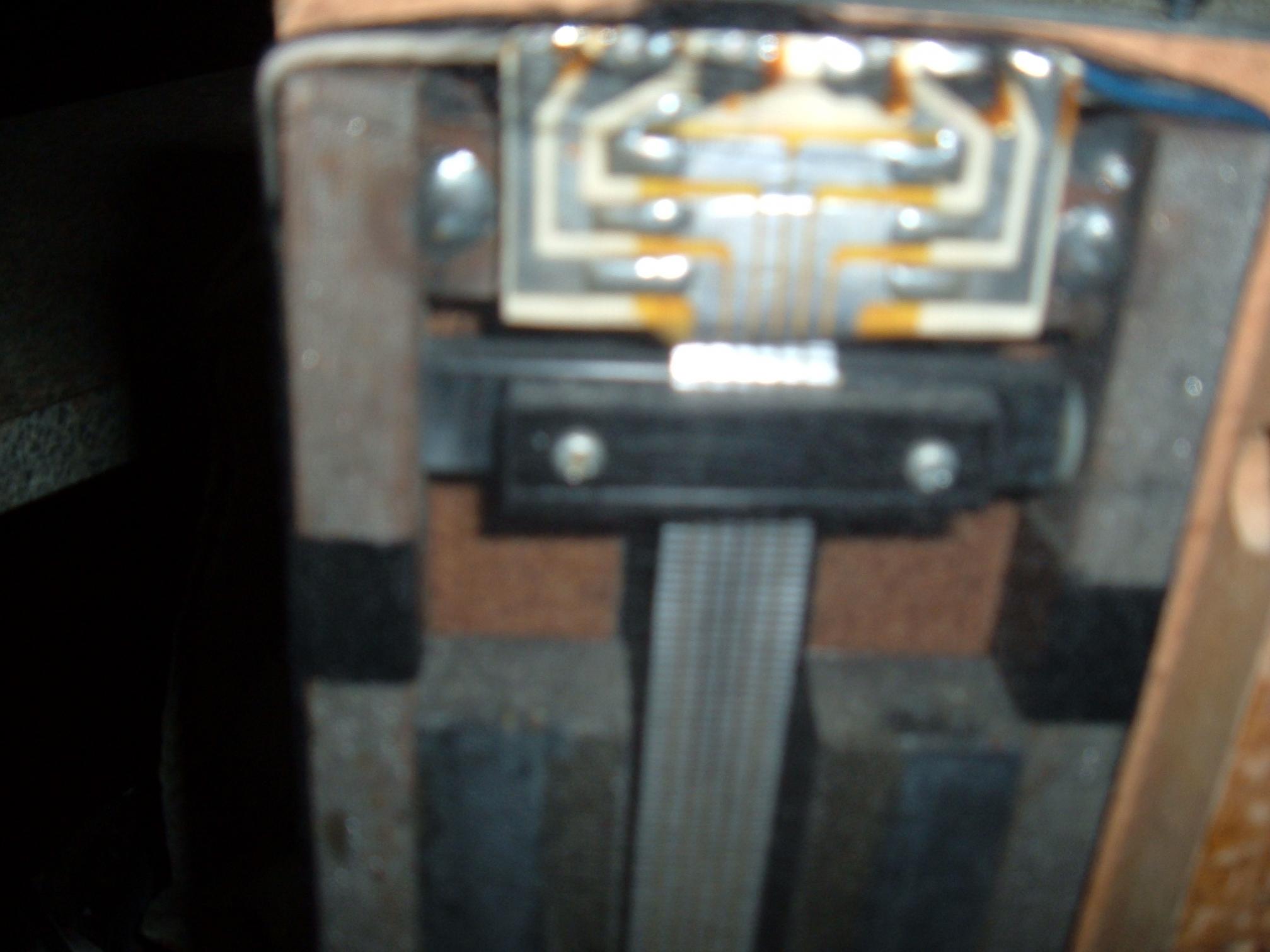

Graz went to this mount with replacement MRT ....with out the bares..as seen in the pic..there were talk of using diff mounts types for other replament MRTs for better sound.....from a installers...

I have found no Apogee MRT or bass drive...just the Stage....with foil on front an back...only front... less there all foil......here a Calpier Sig......
you can also see how all other Apogees .... bass driver pole magnet peace is mounted from in side ..this setup makes a small box......an the Stage is mounted from the outside..

The reason the Stage magnet array being mounted under vs the others over is the Stage does not have a lower clamp set (costs). This is also one of the reasons for the speakers failure mode in the bass. The other planars all involve upper and lower clamp sets, a good thing...
