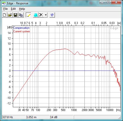

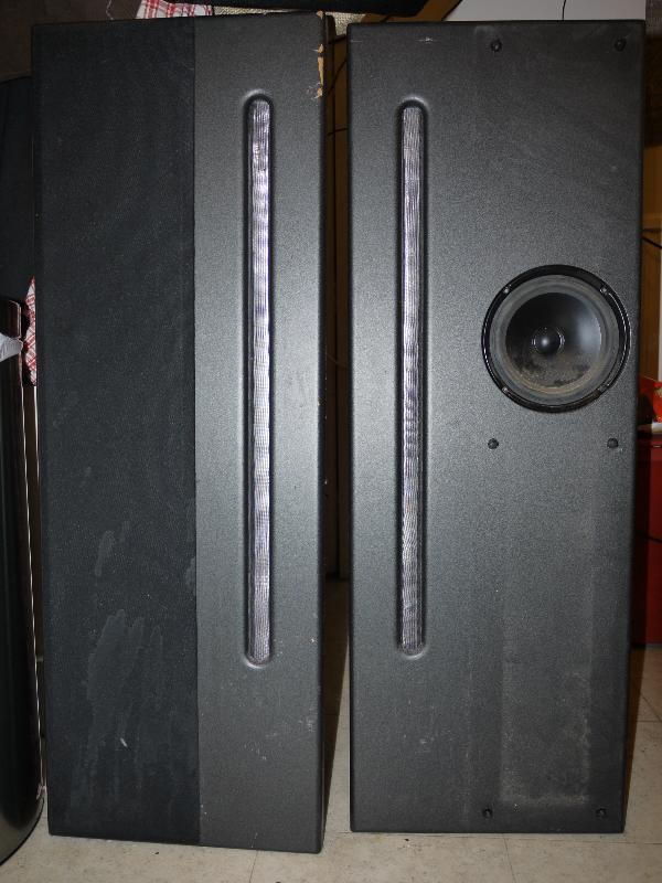

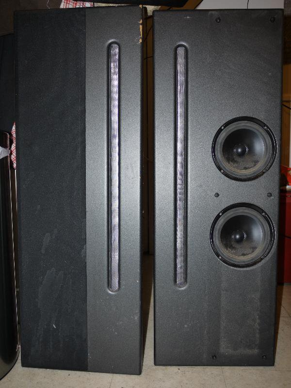

A***, suddenly realised that I had forgotten to take the baffle thickness into account with my sims. So re-ran the calculations with an extra 60mm effective baffle width. suddenly not as flat. 2 drivers again becomes optimal. Knew it was going too well. Not sure how to best flatten that, notch around 300Hz or shelf at 700 yet.

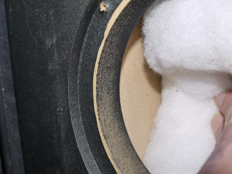

And some pics for your delectation.

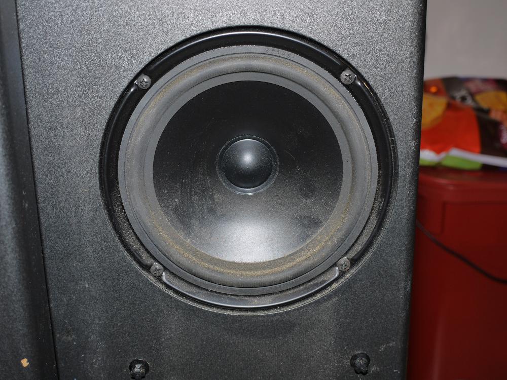

First one shows the woofer. Yes I know it needs a clean

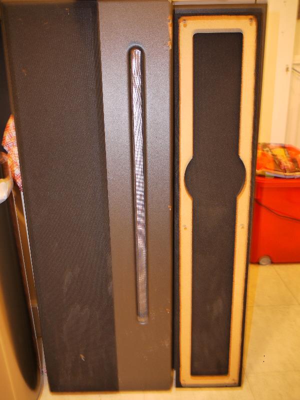

Second shows I can't operate the flash on my camera, but gives you an idea how constrictive the std grille is. Memsahib is adamant that grilles must be in place when not in use, so will drill out the retaining holes and use velcro or magnets for quick removal

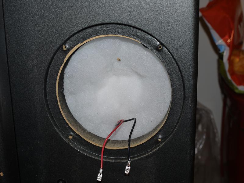

third shows how stuffed the cabinet is. No science there.
And last one shows what the poor driver has to work with. No chamfering of the baffle to help airflow and it's up against the side of the box on 3 sides. I will do some work on that before the new ribbons arrive.

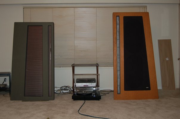

here you go.
Before anyone claims abuse of speakers, note that they have been in storage (AKA kitchen) for 10 months and had a small accident, hence the filthy grille. The missing bit from the Left hand one was my dear middle daughter knocking it over about 13 years ago. It hit the cd rack on the way down.
I think they actually look better without the grilles on. SWMBO differs in that opinion...

Is it a bad thing? One of the few interesting recent innovations is loading a dome tweeter in a shallow horn to achieve the same low end response boost shown in your sim. It suggests the tweeter can be crossed a little lower and still stay in its safe operating area. I wonder if it was Bloom's intent.
I'm only showing the woofer response in that SIM. With a thin baffle it would have been nicely flat to 200Hz. I need to get 150Hz LR2 HP and 700Hz LR4 LP out of that. If the driver has a falling response there I might be ok...

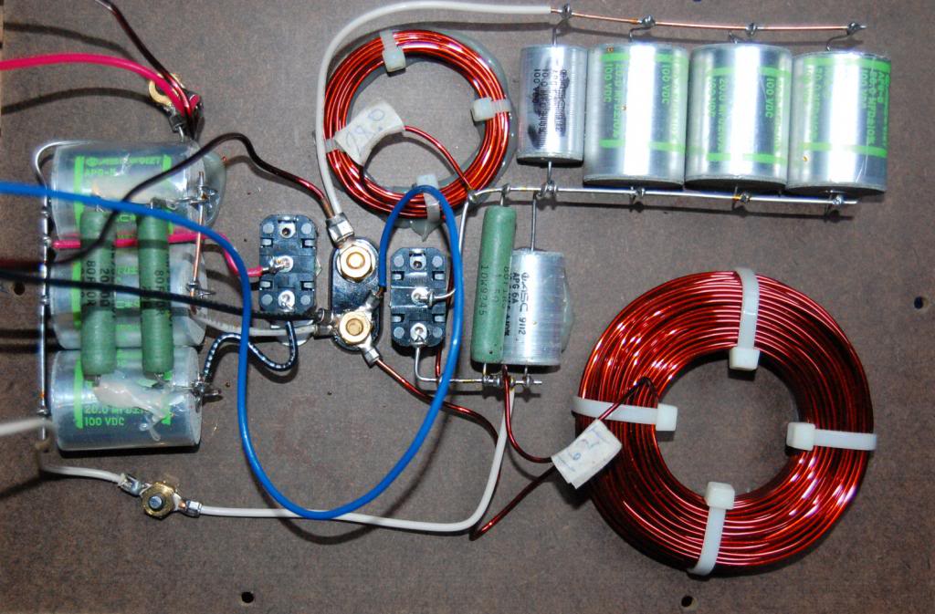

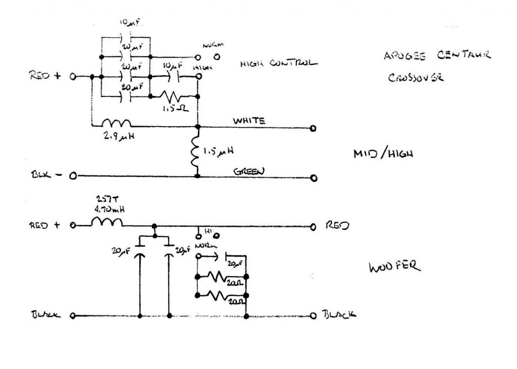

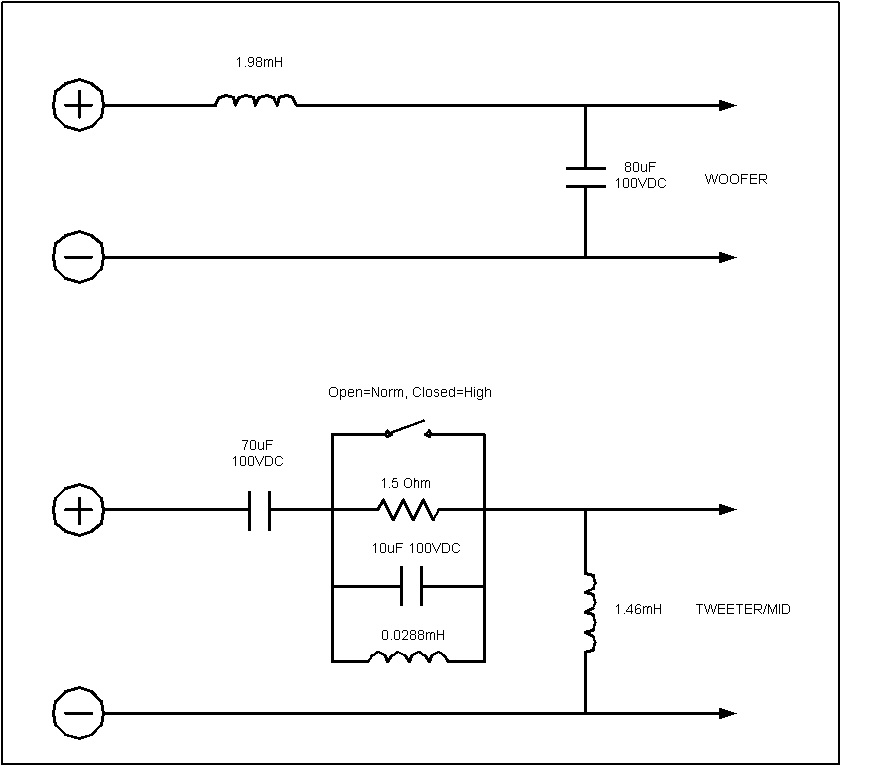

This post is just to add info that some may not have seen....
Centaur or the Minors.... NEVER had two pr of binging post on ea speaker,setup for bi-wireing or bi-amping.......Only the Magors came with this setup....
The Centaur crossover Schematic that for years has been on the Apogee Speaker user web site...an post around as Dave pointout in 02 is Not Right!
In the Schematic at the pos input to the Mid/high.....the coils input is in front of the 70mf cap input....this needs to be moved.... as seen in crossover pic of the Stock centaur ....
To the other side of the of the 70mf an input to the 10mf an 1.5 res....
Then the Coil valus may be off.... but all then looks right ?....
Othere well point out my falings...
But now we can see that MT crossover in the centaur is vary close to the Stages......an the MT in the Minors crossover much higher....
Thanks for Any An all info on Apogee speakers..

I'm only showing the woofer response in that SIM. .... I do wonder if something similar could be done on the apogee ribbons.....
Do the sims show similar augmentation for the ribbon's location?
A set back waveguide large enough to provide meaningful gain in the xover region might also create the offset required to time align a dynamic woofer. Might make for a killer setup.
