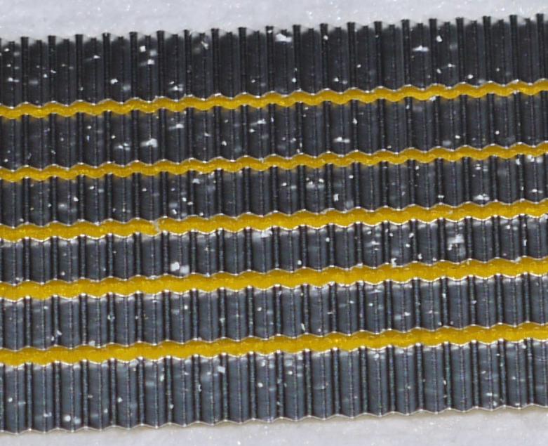

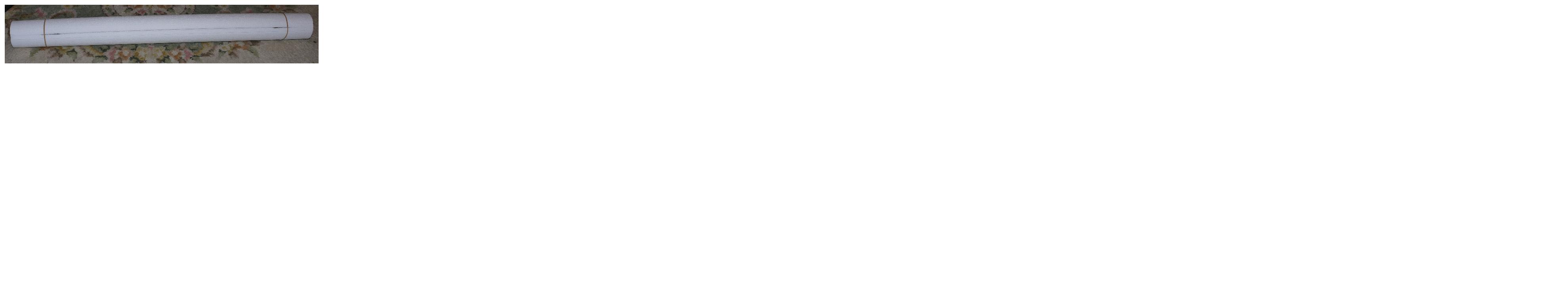

As promised, pics of the new ribbon
Nicely packaged in the tube

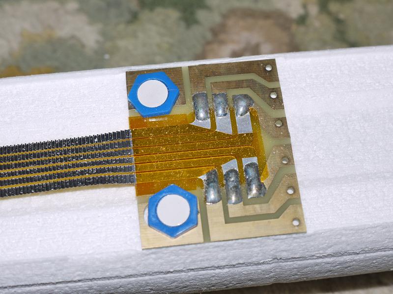

it's revealed
Nice end plate, at least nicer than the stock part. Glad i don't have to solder alumium.

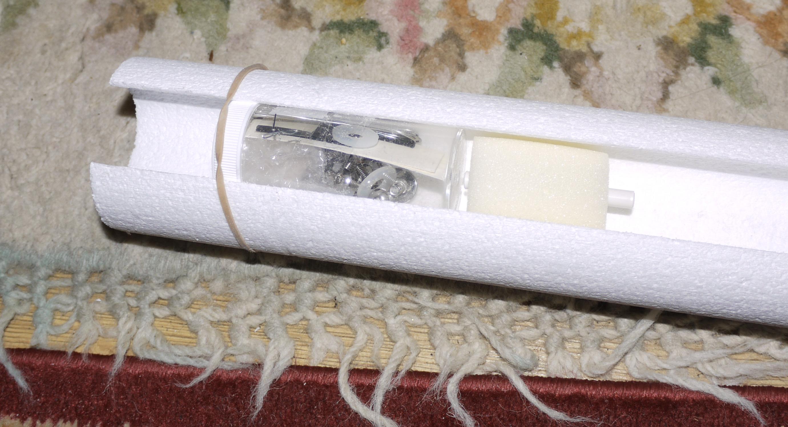

Nice fresh pleating. You will laugh when you see my manky old ones
New fixings and a foam roller that must have some purpose.
Now need to find the instructions before I leap in.
it's revealed

Vary nice........No ribbon suspension peaces....?
I gess grazs ribbon dose not need help... like the stock replacement ribbons..
