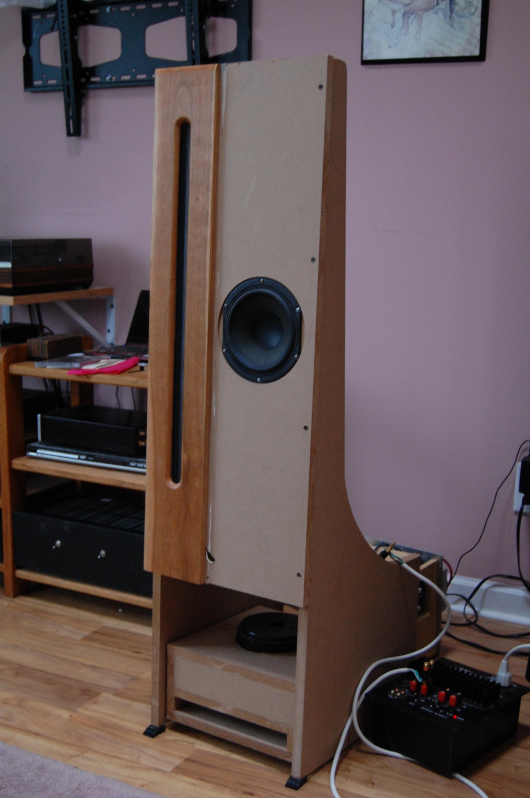

OB mock-up
Just assembled the OB pair using the Peeress6.5" Nomex woofer.
Baffle is 14" wide and 36" high, with tapered wings. 12" space under the baffle for the Ripole sub, plate amp and D class amp boards when I get them. Presently running stereo Symasym per side.
Playing with the minidsp and currently crossing at 500Hz, LR4/LR2 equalizing to reduce room modes.
I had to taper the highs with a -5db shelf starting at about 1500Hz. The 26" ribbon has always boosted the top end somewhat but this arrangement seemed to accentuate that.
Vertical dispertion extremely poor as per Apogee, but the horizontal dispertion seems much improved and doesn't suffer the limited sweet spot. I can sit anywhere on the couch and get a really good stereo image.
So far, very pleased.

The dipole baffle generally widens the response (relative to the original box) until you get all the way to the cancellation nulls. In your case, there's also wall reflections from the higher frequencies of the 6.5" driver range now contributing to the off-axis response. It should be easy to hear the relative difference just by walking around the speaker as you're listening.
I like the idea of ultimately using multiple drivers.....maybe four total....on your baffle. Those Peerless Nomex drivers are terrific and an excellent choice for this project.
Nice setup.
Dave.
Looking good. I am still waiting for the first parts to arrive. Have worked out how to build the amps into the stands (although looking at your ripoles that is a very tempting option too. Will have to research those.
You might get better response moving the driver up a bit. but depends if you want to correct a peak at 300Hz or a dip at 1kHz.
How are the drivers handling the workload? That was my biggest worry over chopping the cabinet off.
And when I showed the pic to SWMBO and she said she was ok with the look 🙂

I did some test frequency measuring today of the raw drivers, separately without any crossover or EQ.
L and R channels measured within 1db of each other.
Woofers were +-2db from 312hz to 3.12khz with the lowest point being at 1.25khz, a wide very shallow dip. Woofer output rose 5/6db at 5khz and fell sharply after 6.3khz. Woofer output fell 6db/octave below 312hz.
Ribbon output was + - 2db from 400hz to 2.5 kHz and then climbed 6db/octave to 8khz. Then fell off(my old ears reach their limit at 10khz anyway).
The tweeter exhibited a wide shallow dip centered at 900hz. Tweeter output was down 3db at 250hz.
I have since adjusted the minidsp to cross at 700hz LR4/LR2 and with very gentle EQ.
I'm still working on the low end where room modes affect each channel differently. But very pleased with the results so far.
Those measurements are certainly of the frequencies and directions that I would have expected, so gives me hope that I am in the ballpark.
Interesting to note the 900Hz dip on the ribbon. Does explain the big suckout on the minors. Correcting that on its own will bring big dividends I suspect.
