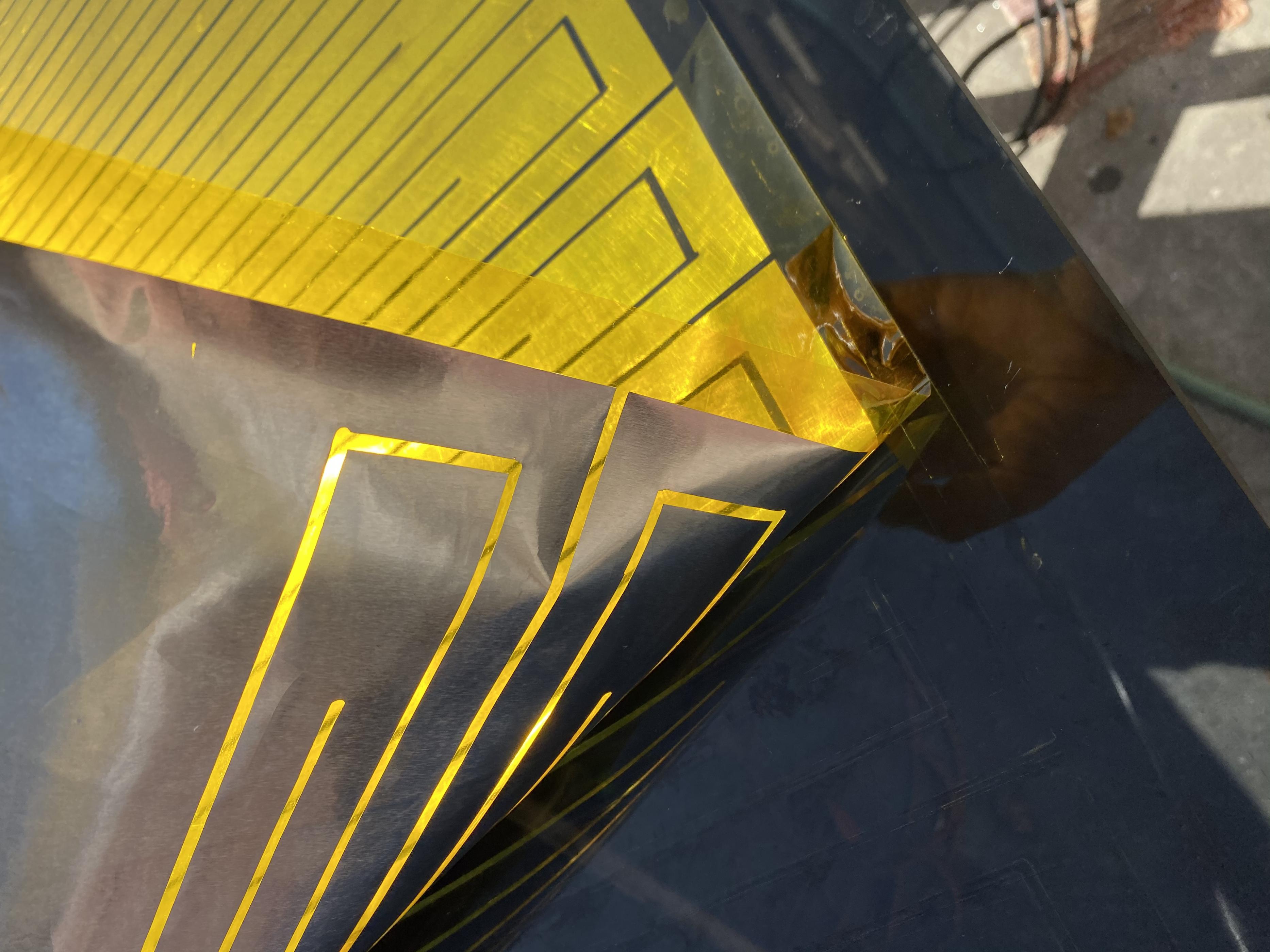

To recap, my Divas have damaged bass foils and you cant buy replacements unless your a dealer/installer for them , so I am going to make the foils and DIY everything else, tuning etc.
I am up to the challenge/ learning curve situation and understand the complexity involved.
If I fail then another road is taken to the same destination..,
Thats what makes it enjoyable 🍷

I think you can buy Apogee Foils from Patrick in Germany (sorry, I will have to dig to find more info). I bough a set of Scintilla bass foils from him about 5 years ago - still sitting in a box. Rebuilding the Scinnies is my retirement project...although I am slowly getting less and less interested in doing them...

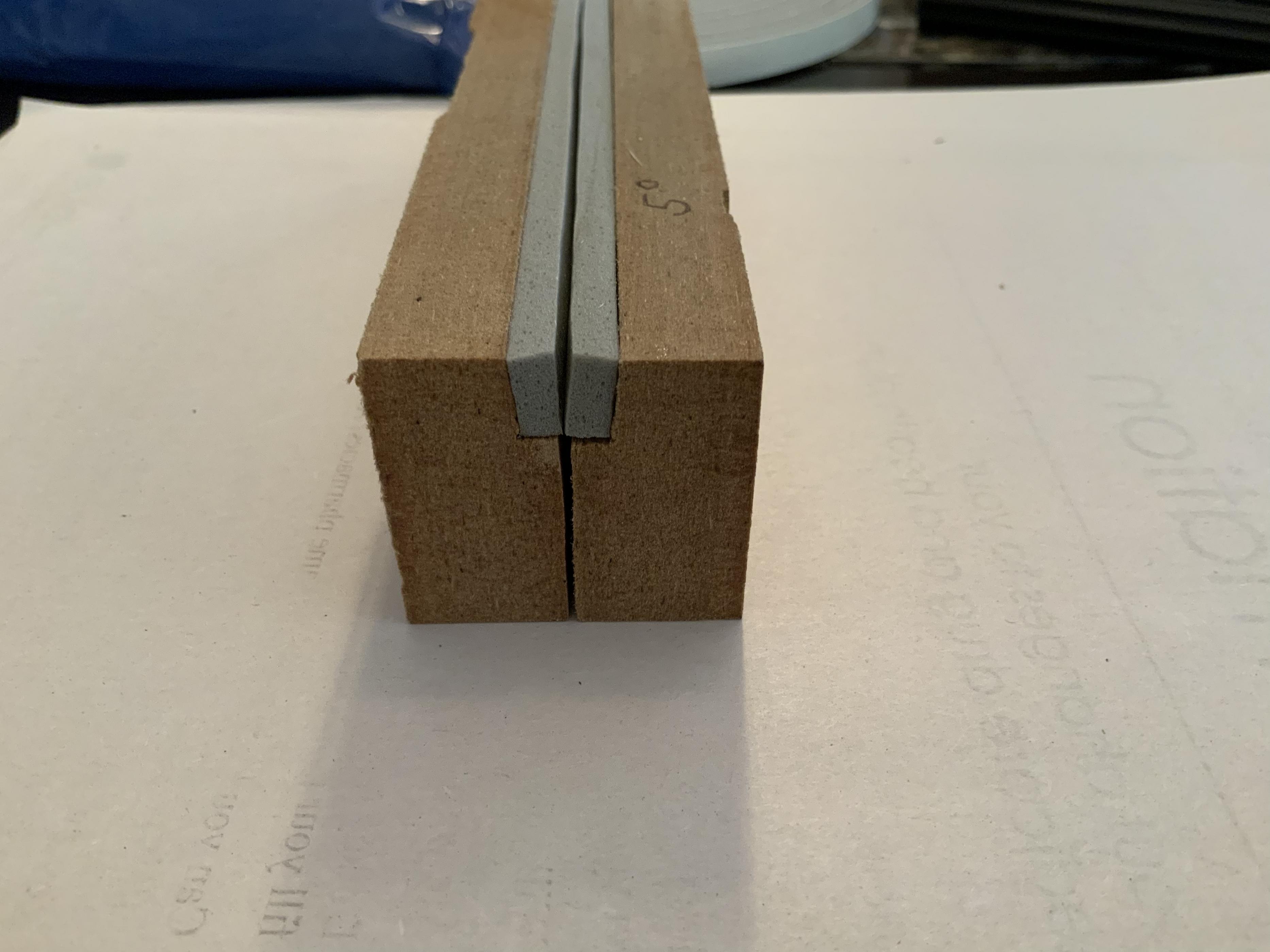

AVWERK.. nice move .... surely you can buy replacement foils instead of having to make em yourself ...and there are several videos on youtube on Apogee bass and mid tweeter installation ... as per your foam mount on the timber rails picture, from my point of view (I may be wrong), I think that the 5 deg. slope you provided, leaves a too big gap inbetween, making the foam useless, let's not forget that the foam edge is to dampen the point of contact of the bass foil to the timber preventing any buzz and any other annoying vibrating sound.. perhaps not providing any slope at all will do a better job.
The foam pressure can be adjusted to your desire by varying the cut depth and how much you want to apply. It is thicker and more buoyant than the stock per side Dim. .030”
They were compressing it nearly flat in comparison.
The way Apogee did it had no transition and you know the history of the issue.
Some people placed a strip pressed against the foam that simulates the same concept and it worked out also.
Flexing of the diaphragm against the foam should transition away IMO and maybe last longer in the end , you can choose what ever works for you.

Why are we reinventing the wheel? The issue with the foam was bad foam. Surely we can get good foam that has similar properties to the original (closed cell was it?) but made with modern materials to last longer.

Now let's get back on topic...the foam. I'm sure we can find out there a foam that is GOOD ENOUGH. If we are willing to terminate the panel with old foam/silicone oil, surely we can use a basic foam that meets basic requirements: longevity and damping.

Nobody's trying to reinvent the wheel. Obviously a new foam replacement is the preferred solution, but you can't do that without tearing the speaker completely apart. (I thought that concept was clear to everyone.)Why are we reinventing the wheel? The issue with the foam was bad foam. Surely we can get good foam that has similar properties to the original (closed cell was it?) but made with modern materials to last longer.
The premise of this thread is a stop-gap solution to make the speakers perform much better WITHOUT having to resort to the high cost/complication of a rebuild job.

Sorry, I was not clear. I am not suggesting anything other than a fix, and not a rebuild.
If the old foam has deteriorated to the point of being mostly gone, then we are relying on silicone/oil filling that gap and becoming the main dampening product against the panel.
I'd prefer to find a suitable foam, press it in the gap and then apply the silicone/oil. Or, perhaps apply some glue in the gap and then push in the foam. The foam would then have something to grab onto at the bottom of the gap, stay in place, and still be the damper for the panel.
Of course, that only works for the front. to prevent the panel being pushed too far back and creating a buzz from the rear side, perhaps it's best to apply the silicone/oil in teh rear first and then apply the new foam technique to the front. But then we may have the rear having the silicone/oil being a damper.
Look, for all I know, people who have tried this and found it working fine may be satisfied and not be concerned with the choice of damper being an issue. I may very well feel the same when I do this. I would just want to pursue the possibly more correct course of action.
