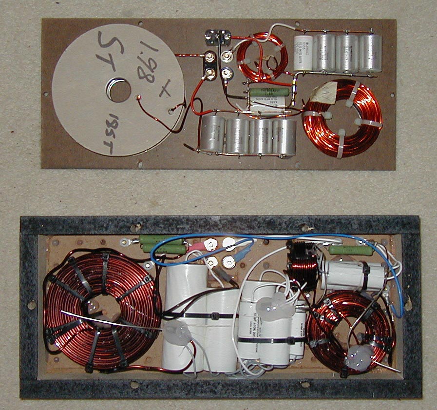

North Creek ........ George Short.....
In 2008, during development of the Fibonacci Technologies' Vaya! Loudspeaker I kept of a pair of upgraded Stage's and a pair of Duetta Signatures in my listening room as reference. I can say with no reservations, the Duetta Signatures are great speakers, but the upgraded Stage's blow them away.
His crossover in the pic...he worket with jason...on the Apogees
I got a littel info from him an put some mods on the Bass driver....AZobel res.cap....an made the trap on the MT a littel biger....his setup looks great
I keep all coils stock.... Jason like the sound of lose coils ...an so do i...tride others.....
Stages rock...had a guy i did some tube amp mods on his VTL 200s ... ran the VTLs ln to my Stages...offered me $2k.....on the spot....he has new SoundLabs..he had never heard the Stages before....mind binding.....lot fun
I say the Stages Holes up ....it can be moved...i can pic it up off the floor an cary it....try that with a Duetta Sig.....
I have a pr of the Centaur minors....there MT crossover higher....same MT as the Stages...vary sweet.......got them for $200 for the pr...keepers...
