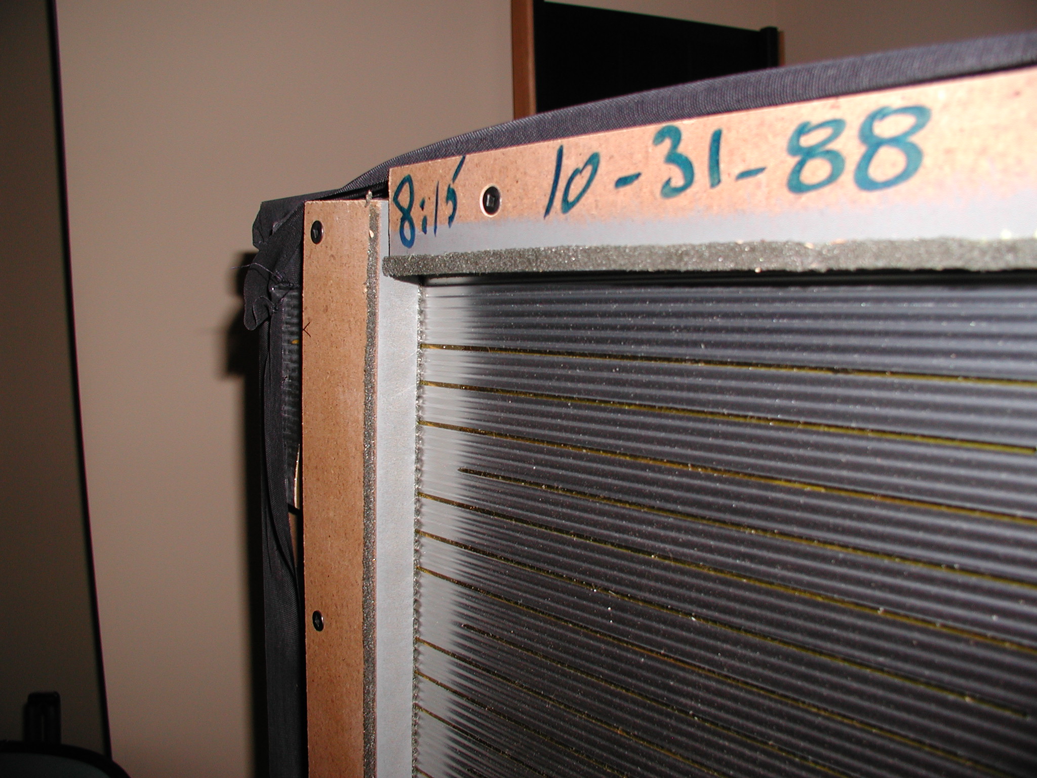

In regard to where the foam to be treated is?
The photo below is from the initial post in this thread, can you either annotate the photo or just confirm where the foam needs to be treated.
I can see a small strip of foam between the foil of the bass panel and the vertical wooden clamp in the photo below, so that foam along the entire length of the clamp/foil needs to be treated?
Are there other areas that need to be done, or should we start with that and see if that gets rid of the buzzing.
url]https://www.diyaudio.com/forums/attachments/planars-and-exotics/342253d1365828320-apogee-buzz-fix-p1010003-jpg[/url]
Yes.
The treatment should be done with speaker in upright position, applying silicone only on foam. It is good to have second person for hold the speaker.
