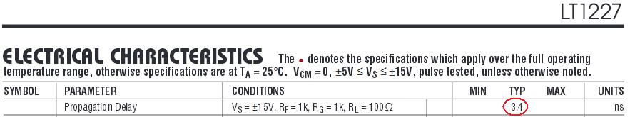

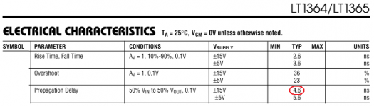

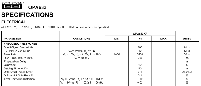

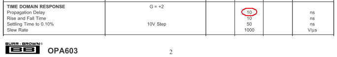

You are right, these (and many other OPAs) were apparently developed by sectarians from audio lovers

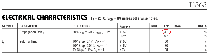

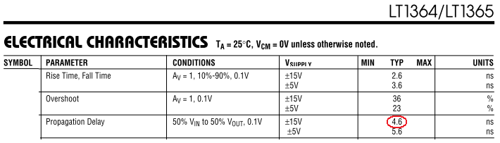

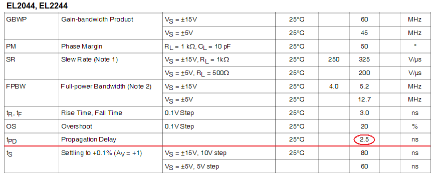

Sandy, the time Propagation Delay is a dynamic parameter, the same as Slew Rate and Rise Time, and characterizes the ability of the amplifier to quickly respond to voltage changes such as amplitude and frequency.
At one time, I gave you this fragment from Jiri Dostal's book for study, but you still did not understand anything.

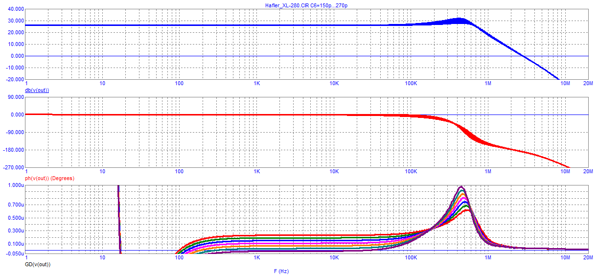

I tried to figure out why the Hafler XL-280 amplifier passes its SWDT test, and the sound quality does not meet the requirements for reference amplifiers.
To do this, I typed a model of this amplifier and took a Bode diagram with various values of the trimmer capacitor C6.
As can be seen from the diagram, in the audio range, the group delay can be set up to a negative value. For example, for a frequency of 20 kHz, according to the formulas from Jiri Dostal's book, the group delay should not exceed 8 ns, which is easy to do.
But why then the amplifier does not sound as it was intended by the author? The answer is simple. The author tested on a sinusoidal signal of constant amplitude, i.e. in steady state.
If we carefully look at the group delay graph, we will see that the group delay persists only in the audio range, while immediately after the audio band, the group delay level begins to rise, which reaches 600 ns at a frequency of 300 kHz!
I hope there is no need to explain that when both the frequency of the signal and its amplitude change (which constantly takes place in audio signals), the spectrum of the signal changes, it is enriched with higher harmonics, which are also important to amplify with high accuracy both in amplitude and in phase.
Therefore, the conclusion suggests itself that in order for the amplifier to amplify the signal as accurately as possible, it is important not only the group delay that meets the SWDT requirement, but also its constancy up to at least 300 kHz! (preferably higher)
what kind of amplifier with such group delay parameters?
Somehow, in terms of topology, this will probably be due to the frequency dependence of the input impedance of the driver stage - and why such an amplifier will sound good? it's not real...
petr_2009, a hump on the high-frequency part of the Bode diagram of a closed-loop amplifier indicates poor stability. What else do you want to find in an amplifier that is not even stable? There are two options here - either the amplifier was really poorly made, or your model does not correspond to reality. But there is no need to talk about any search for invisible entities that spoil the sound from such a situation.

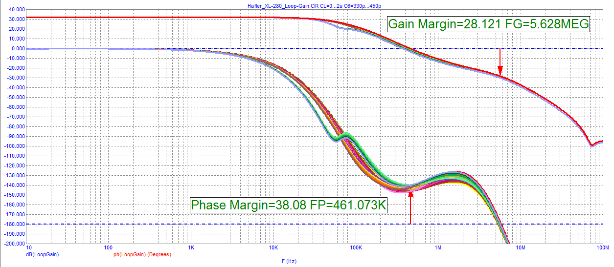

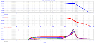

Amplifier stability is judged from the loop gain diagram, not speculation from the Bode diagram. Here is a diagram of the loop gain in all group delay tuning modes with a capacitive load from zero to 2 uF
petr_2009, the Bode diagram of a closed-loop amplifier in an unstable state also has a hump in the RF region. It is one thing when this hump arises due to the interaction of the output filter with the load, and quite another if this hump characterizes the amplifier itself at the output point where the feedback is taken. These are two different cases. Since you did not show the Hafler XL-280 simulation scheme and did not attach the model for verification, there were reasonable doubts.

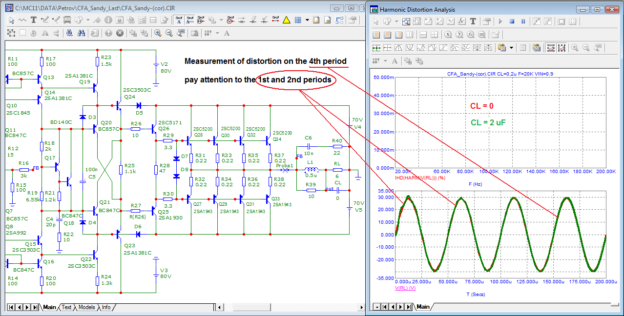

and that is why I have told everyone who is unhappy about suddenly starting sines on my simulated traces to ignore my first cycle energisation. Most audio responses become steady after one cycle, so why is everyone fighting me ?
https://www.diyaudio.com/forums/sol...-interview-negative-feedback-post1197323.html
Those who believe they understand SS NFB amplifiers need to ask themselves why it is that even though all the 'nodes and zeros etc. etc.' are theoretically correct, so often the reproduction still does not sound right !!!!!
Graham raised the issues about 20 years ago, but the "theorists" were stocking up on popcorn to start laughing in the morning.

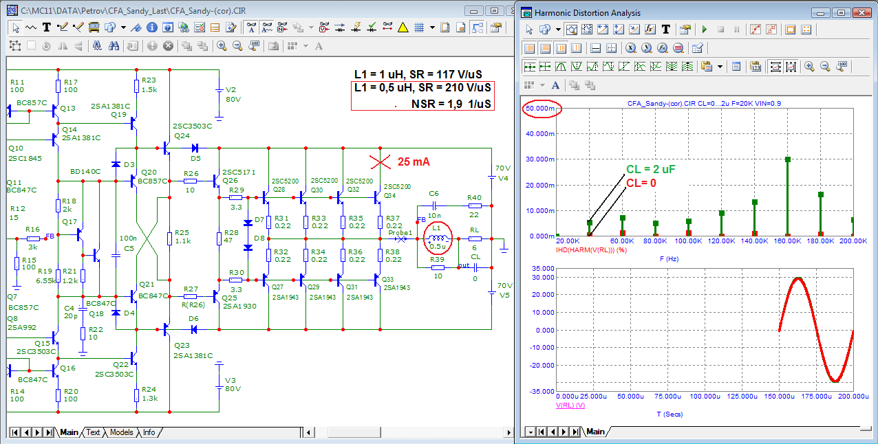

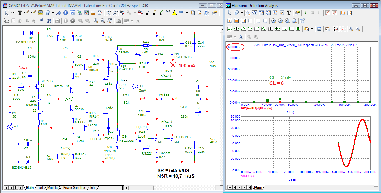

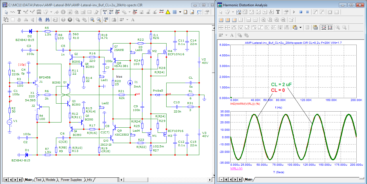

Here is the result of measuring the spectrum of two amplifiers at the same load with the same output voltage on the 4th period.
I hope it is clear that if you measure the spectra in the first period (as Graham did), the difference will be even greater. But in this version of the program, the minimum number of periods is limited to four.
p.s. In fact, the amplifier proposed by Sandy is much better than many other developments (if you do not take into account the shortcomings mentioned above).

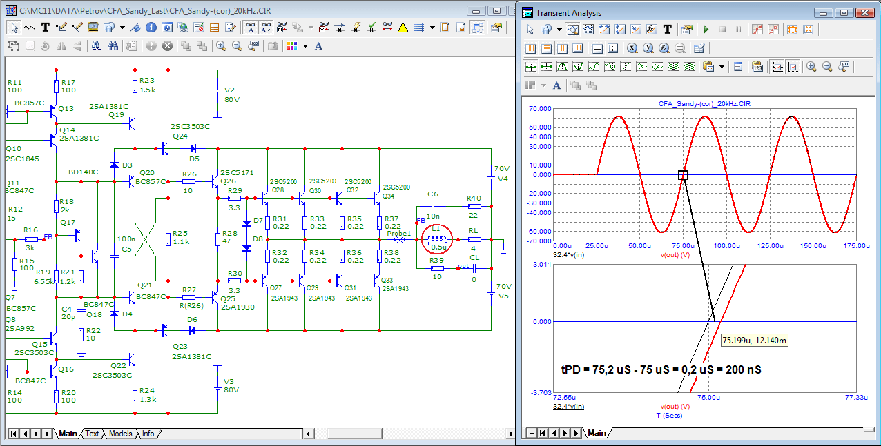

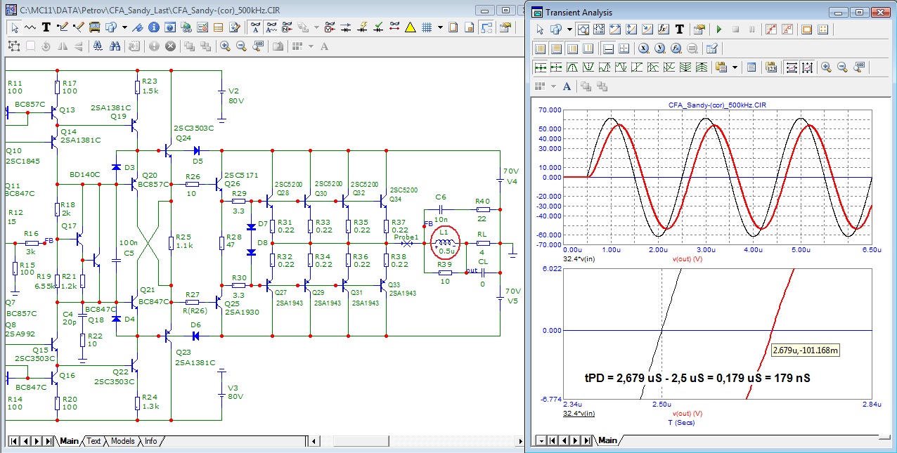

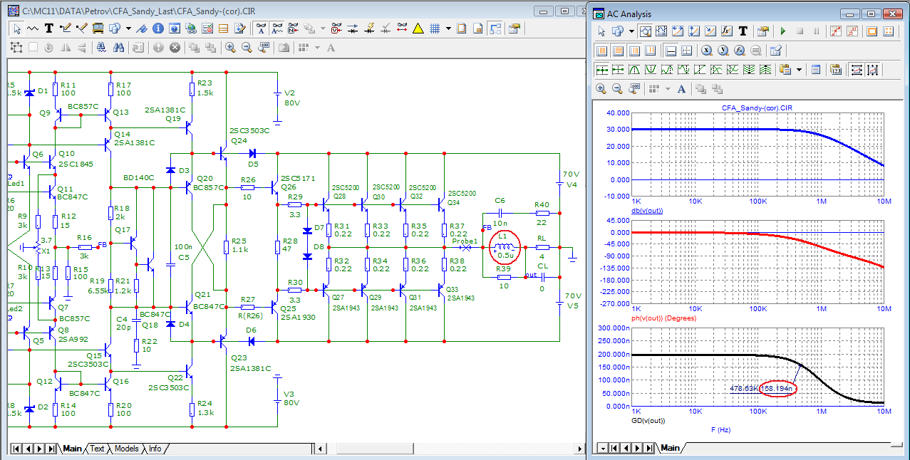

Yes, Sandy, we argued. But you didn't understand then, and you don't understand now. Here are the test graphs of your amplifier, study. As you can see, while the phase is constant, constant and group delay.

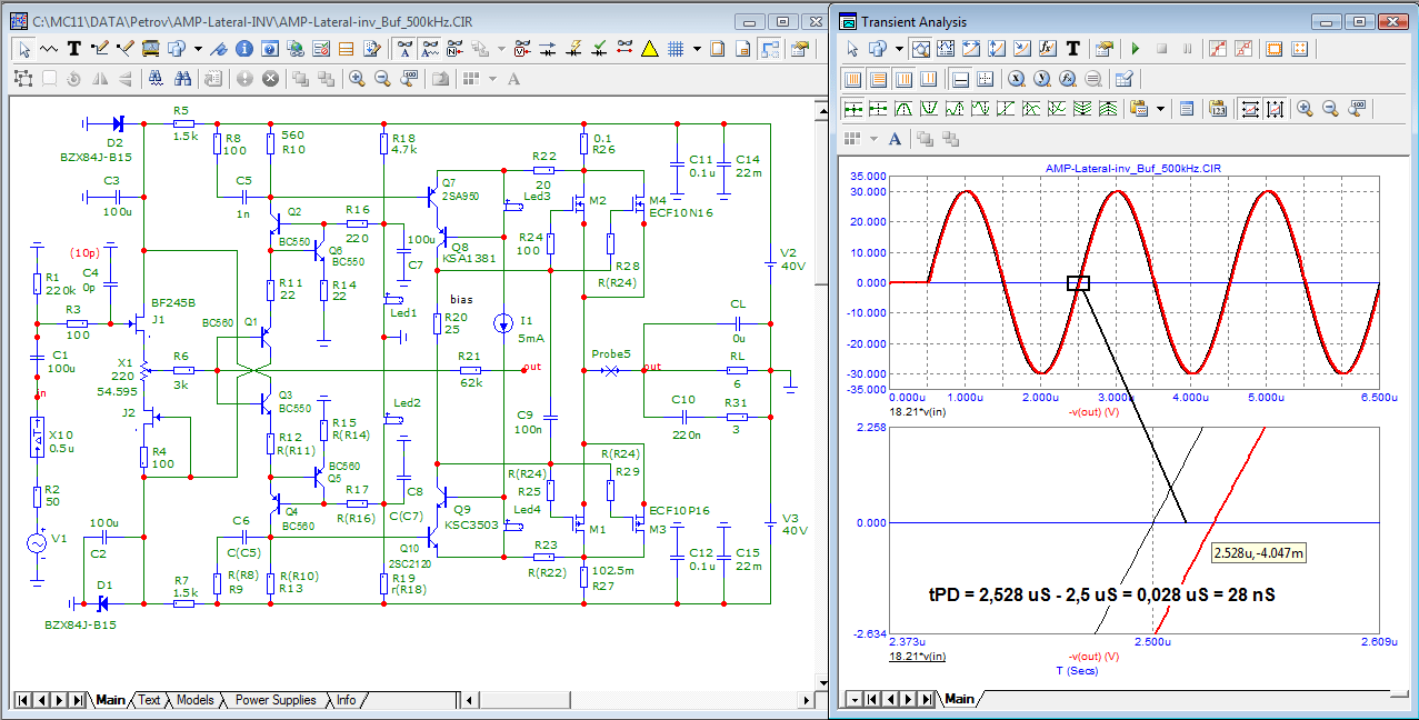

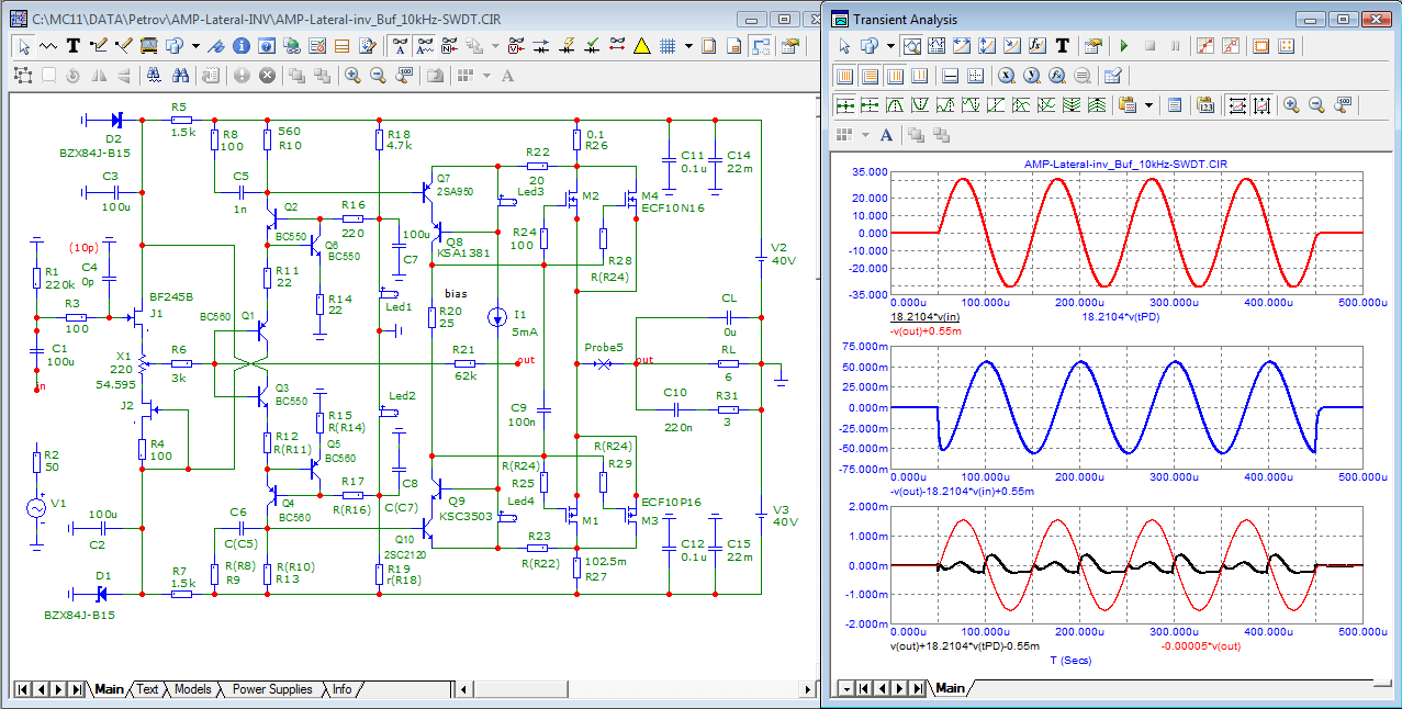

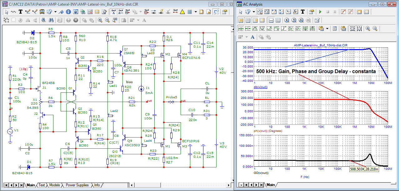

Sandy, to draw a line (so that you finally understand what time Propagation Delay is), I will give the same tests of another amplifier.
When measuring distortion by the compensation method, an ideal delay line of 28 ns was used
